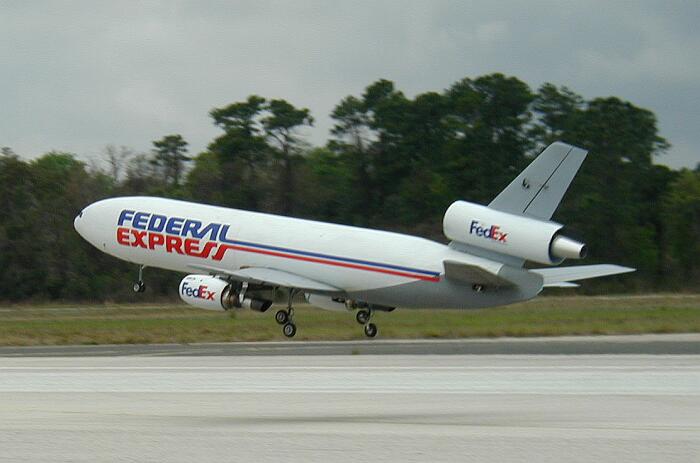

Old 02-10-2003 | 04:51 PM
Posts: 1,146
From: Baton Rouge, LA
Default help with servo extentions!!
The plane below has no buffers / amps or anything
it has ~11 servos and some of the wires are over 6 foot.
I used 22 gauge 3 cond shielded and never had as much
as a bump with good power from the elev servos.
Its my option you don't need all the extra stuff.
Eddie Weeks

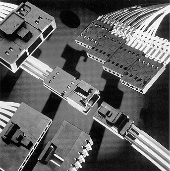

Old 02-10-2003 | 11:50 PM
My Feedback: (27)
Posts: 747
From: Inver Grove Heights, MN
Default Connectors
You can also try a company called AMP. They make every connector you could think of. I use their MTE 3 line of connectors. They plug right in to a JR receiver and have a very positive lock. I make all my own servo extensions. These connectors have worked well for me for years.
The connector in the center of the picture, with the 3 wires is the type. work great!!!
My 2cents worth..
Kevin
