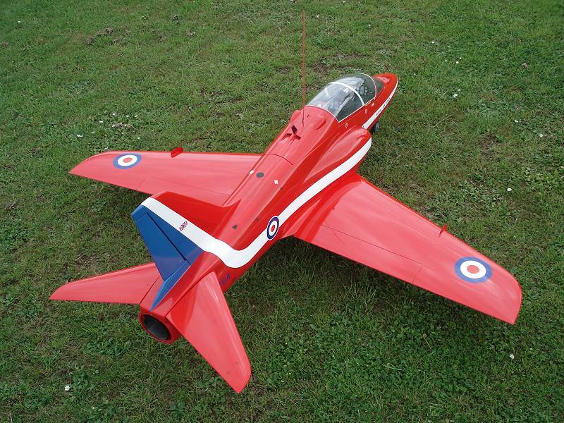

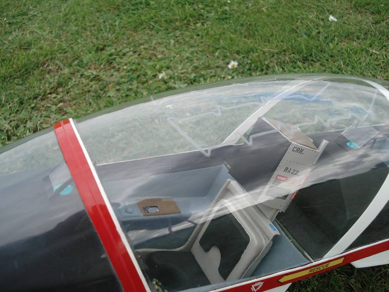

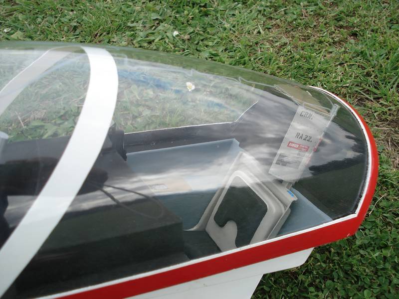

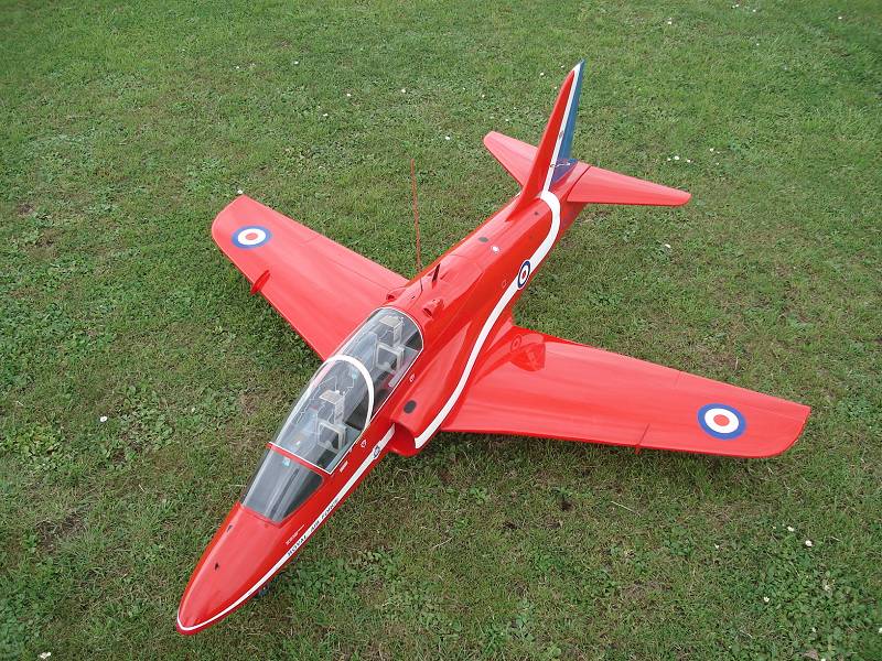

Paul,
Pics as promised.
Trevor Skedge.

More

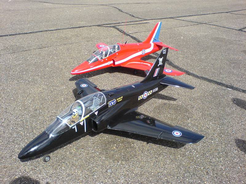

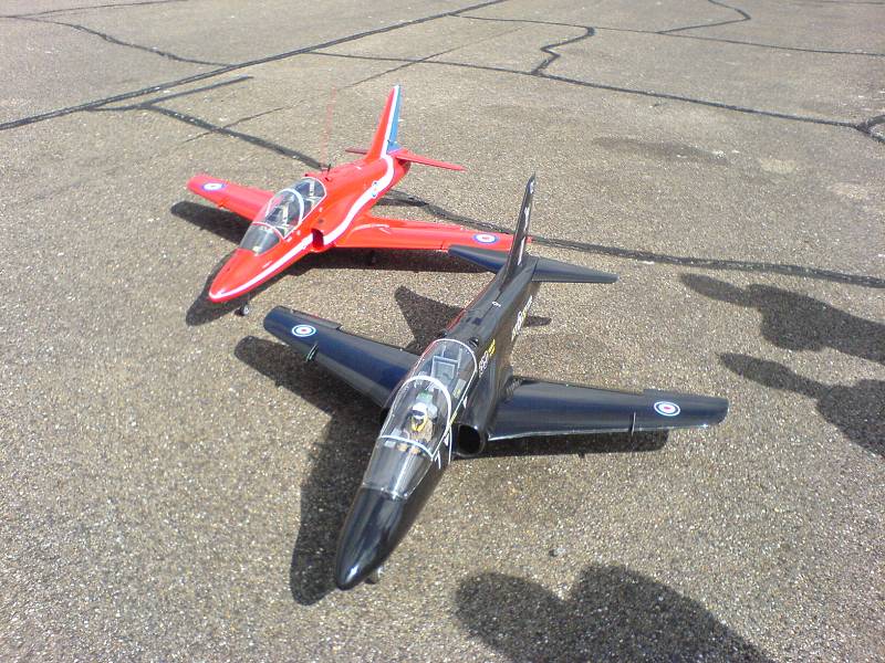

Another good days flying with this great model
The Hawk is flying soooooo well as I am settling in with it.
During the day Trevor flew it as well and really started to push it, we had low level 4 point rolls, low inverted passes, slow rolls and really nice BIG loops. [8D]
Trevor even managed a knife edge to knife edge landing approach....interesting !!![X(]
Wind was around 15mph but the model handled it very well.
Tried the full flap but feel it may be too much, so did not land with it.
I shall reduce the movement and try again next time.
Anyway, got a couple of pics with the 2 together.
The black Hawk as the original wing (soon to be changed) as you can see the new wing, even though it is slightly larger, is not obvious when compared to the old one.
Trevor may post later with his views on the flight he had.
Paul

Paul,
A "Senior Moment" on my behalf highlighted the new wings superiority on the gliding knife edge recovery front. This new wing demonstrates a more neutral flight pattern over the smaller/scale wing which the pilot has to fly in the turns, making it more user friendly and currently I believe this will be the weapon of choice for anyone wanting a home for their Wren 44. Quality has taken a step forward from very good for the price to "Can't be beaten" in my view.
Take off is quick and landing can be slow so makes it excellent for grass fields, with the bit in between an absolute pleasure.
Trevor Skedge.
