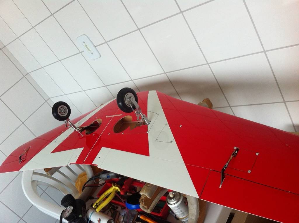

The Wings. Landind gear and brakes checked!
I will put the wing fence.

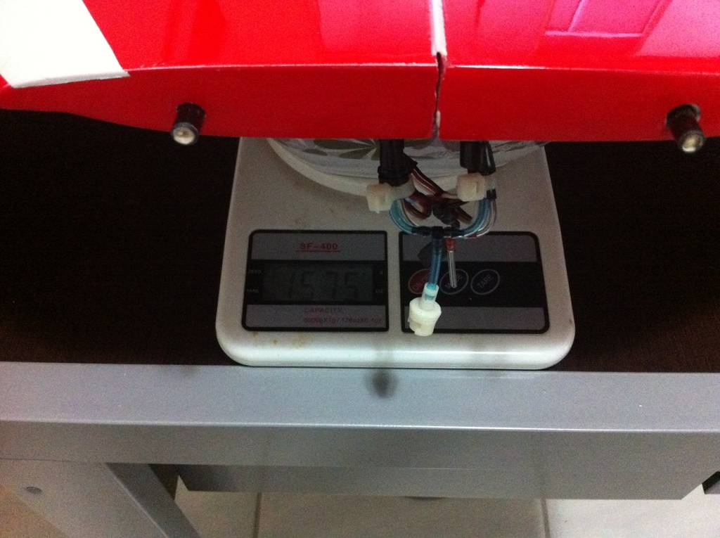

I was adjusting the CG of my Hawk at 140mm behind the leading edge. Is that right?
With the CG and the plane set down I feel that the nose is a little heavy when lifted hands. I would compare the weight of the nose with another Hawk if possible. I put my tailwheel on a weight scale and recorded 460grams.
The hopper tank was full and the main tanks were half.
Thanks for help!
Regards
Fabio

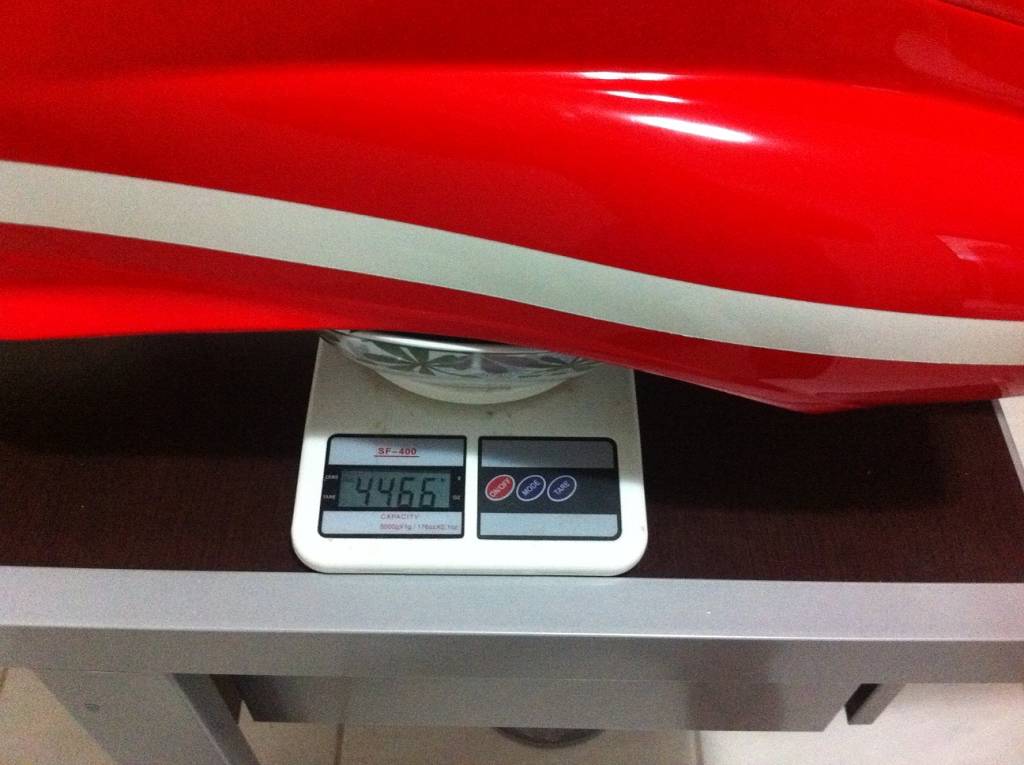

My Hawk weighs 6.041gr with batteries and dry.
I weighed the fuselage and wings separately because of the digital scale I used only accepts up to 5kg.

On a model like this where the tanks are in front of the CG i allways measure its position with the main tanks empty, just fuel in the UAT.
This is 'worst case ' rear CG.
140 to 145 mm is a good starting point for the CG.

Hi, everything that Paul says is spot on.
One thing I did find was that if the CG is too far forwards it climbs a bit as the speed builds up.
If you move the cg back a little the stab needs a little less "up" in there and it stops it climbing as the elevator becomes more effective at higher speeds.
Hope that makes sense?

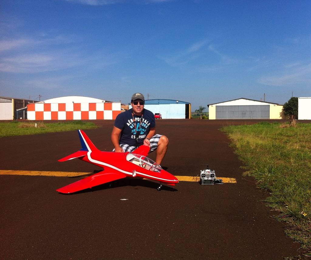

Hi Guys,
I fly mine yesterday!
I can say that this jet is amazing. It flies very well with a lot of stability. I had four flights and full flap landing is like an trainer airplane! I'm very satisfied.
Next steps: Decals, scale cockpit, other details and smoke pump.
I love my Hawk!
Thanks Jim!
