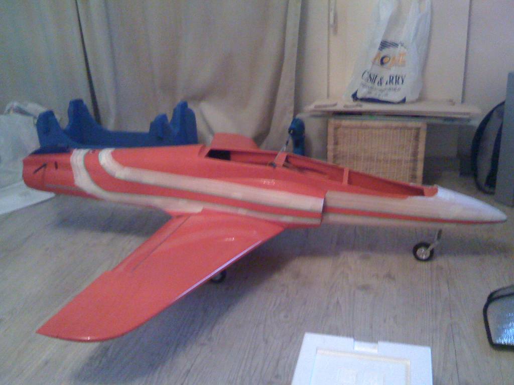

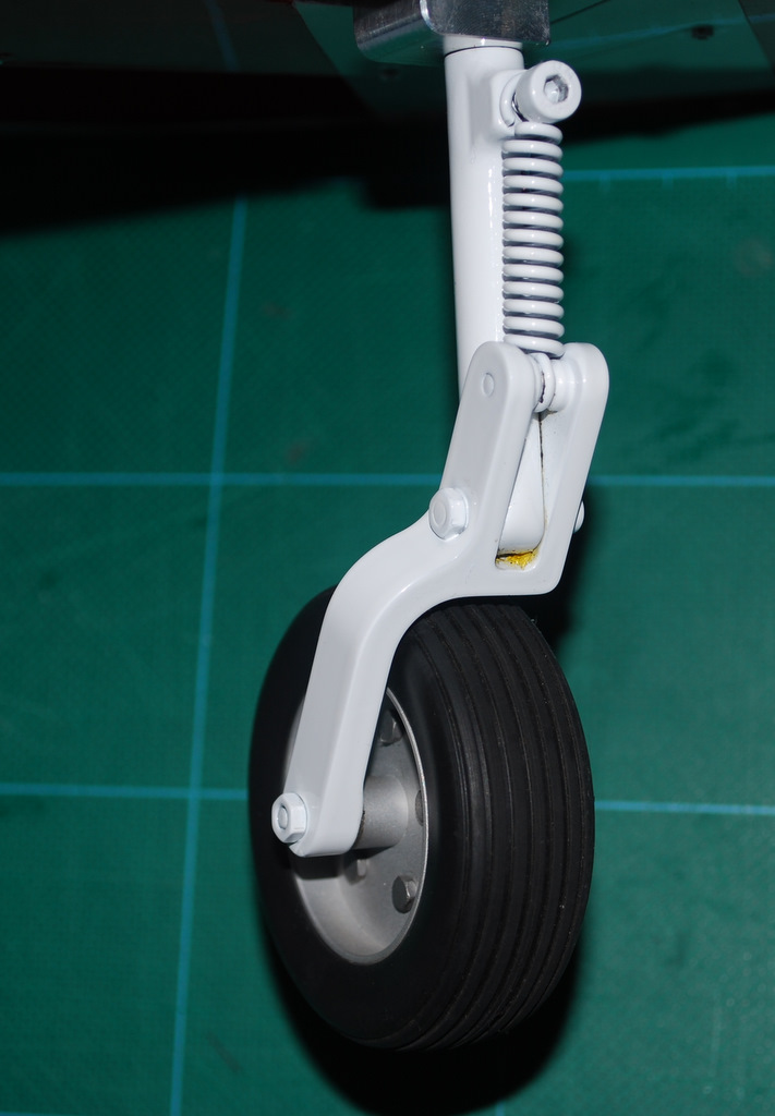

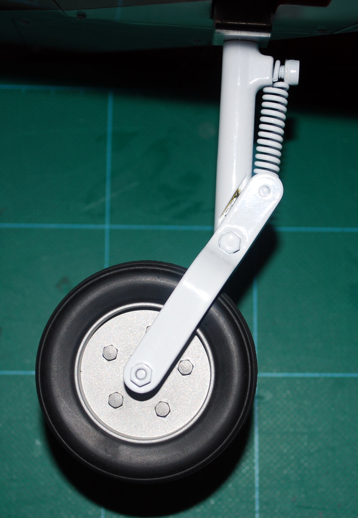

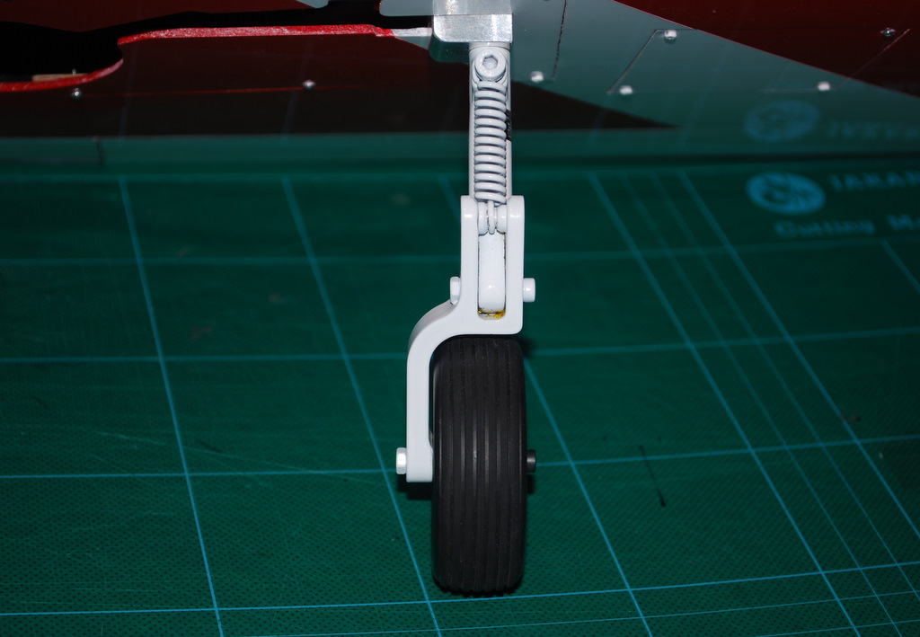

These little beauties arrived today. Jet 1A main leg oleos, nose oleo and forward retracting nose retract with built in steering arm. this is a fine piece of work, the ball link on the steering arm does not vary in position either vertically or laterally during the retract cycle, just a very small sideways movement of the steering rod from the servo which will pass through a slot in the mounting former. Retract angle is around 115 degrees so the former can be fitted vertically, going to work on this next as it looks like a nice easy install!
John
John

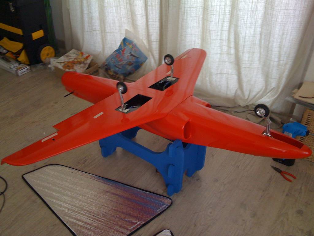

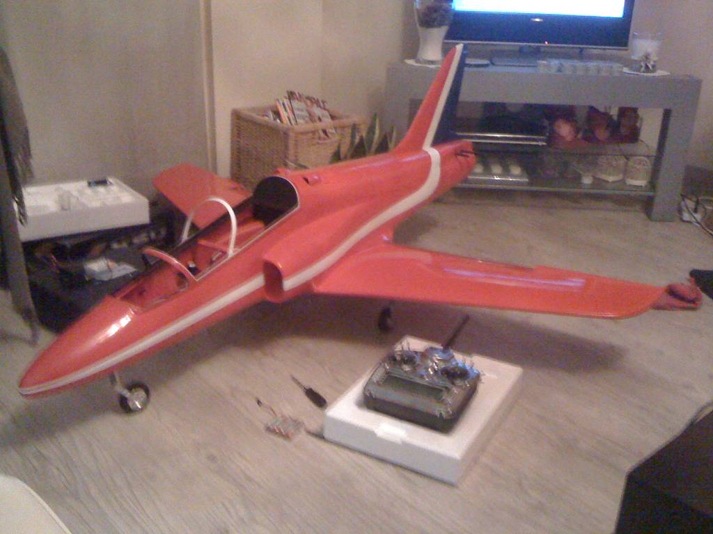

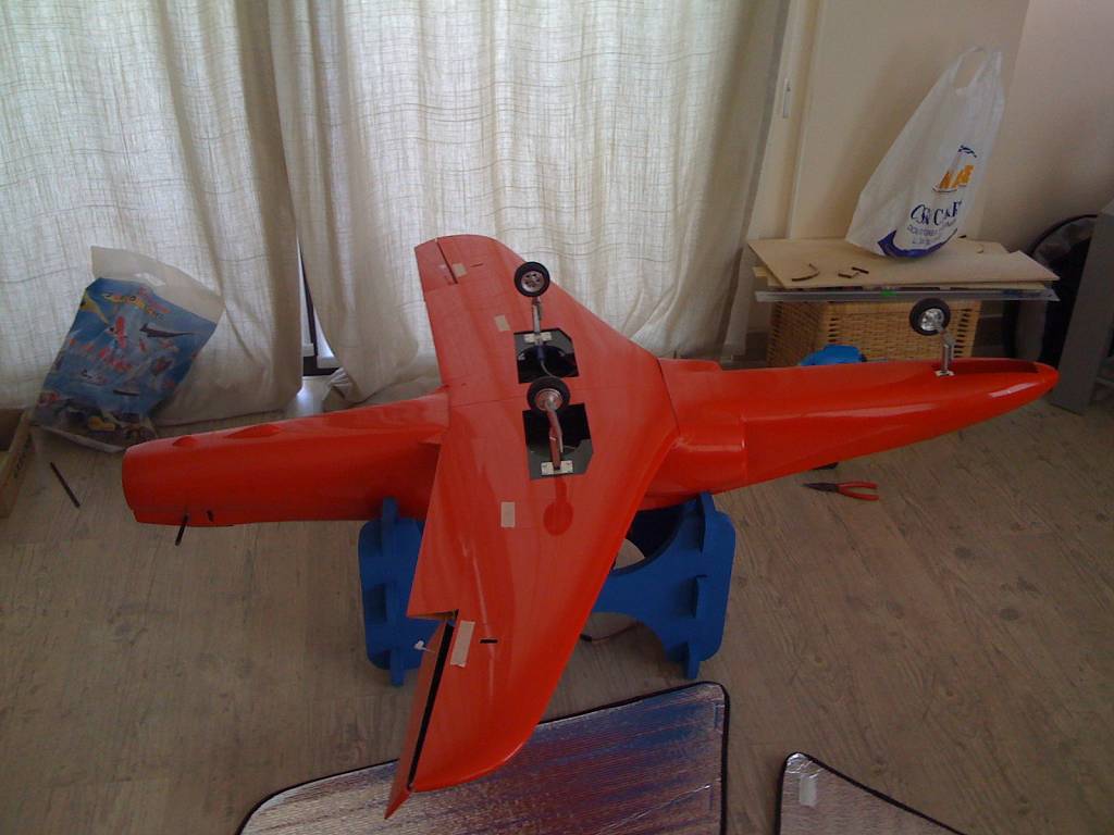

#732
Joined: Sep 2004
Posts: 73
From: CYPRUS

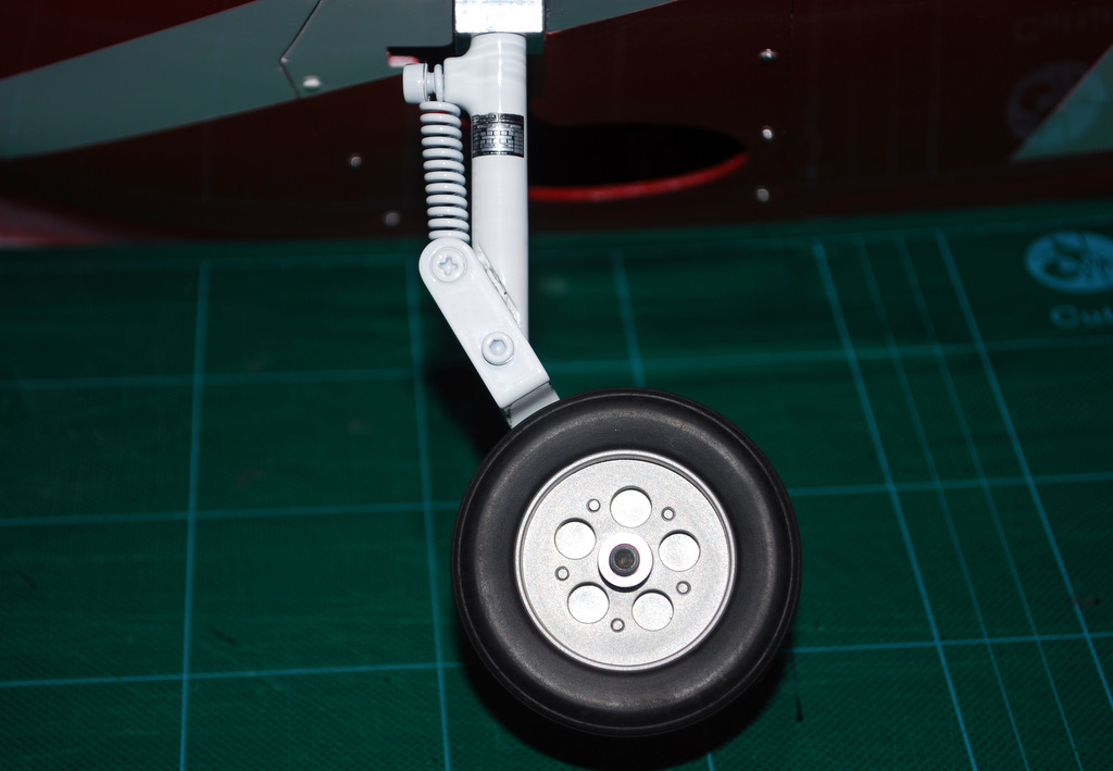

Good choice on the retract . I have also used them on mine and they look great.
Here are some pictures. Not a very good quality though because they were taken from a mobile phone.

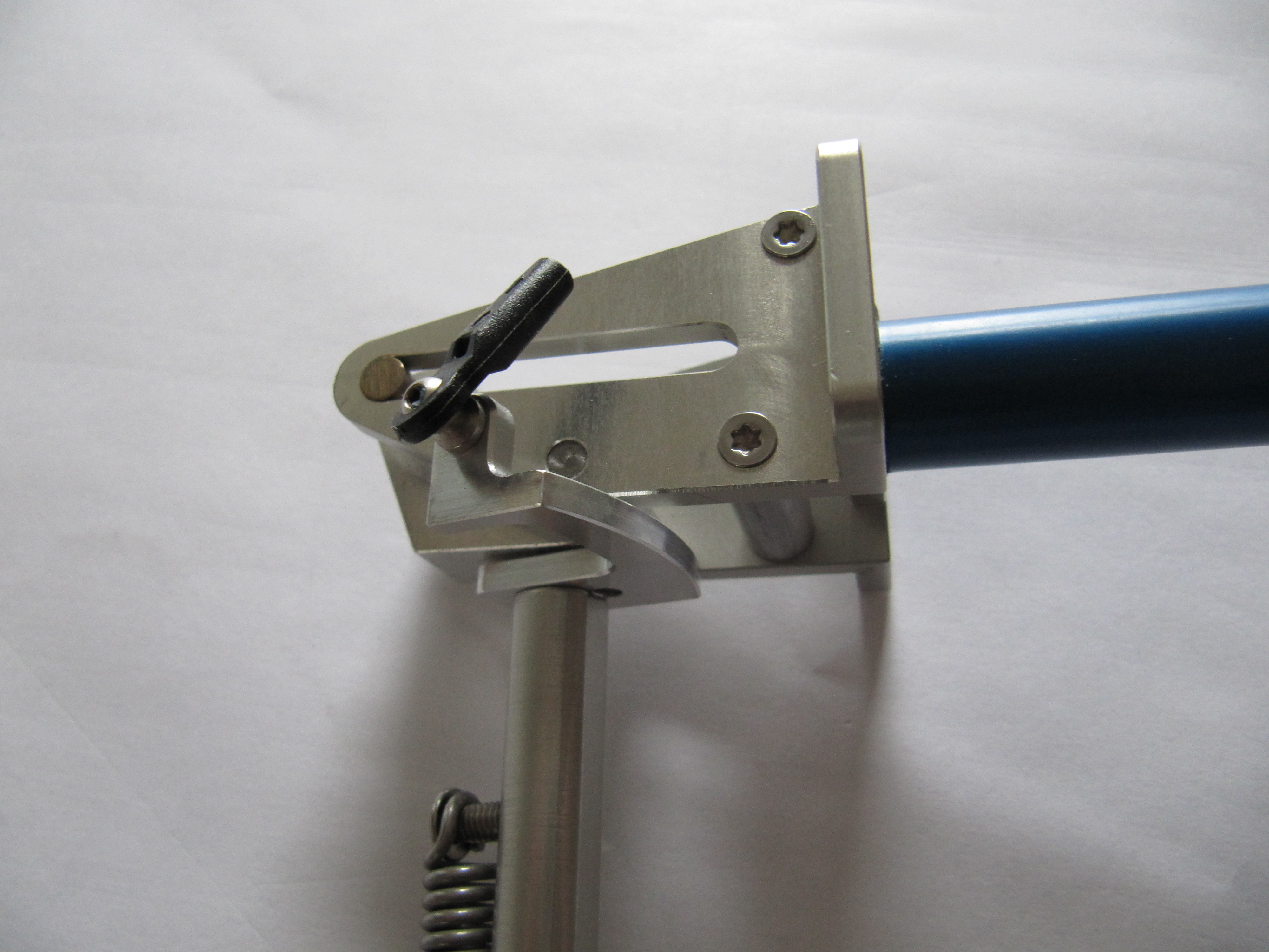

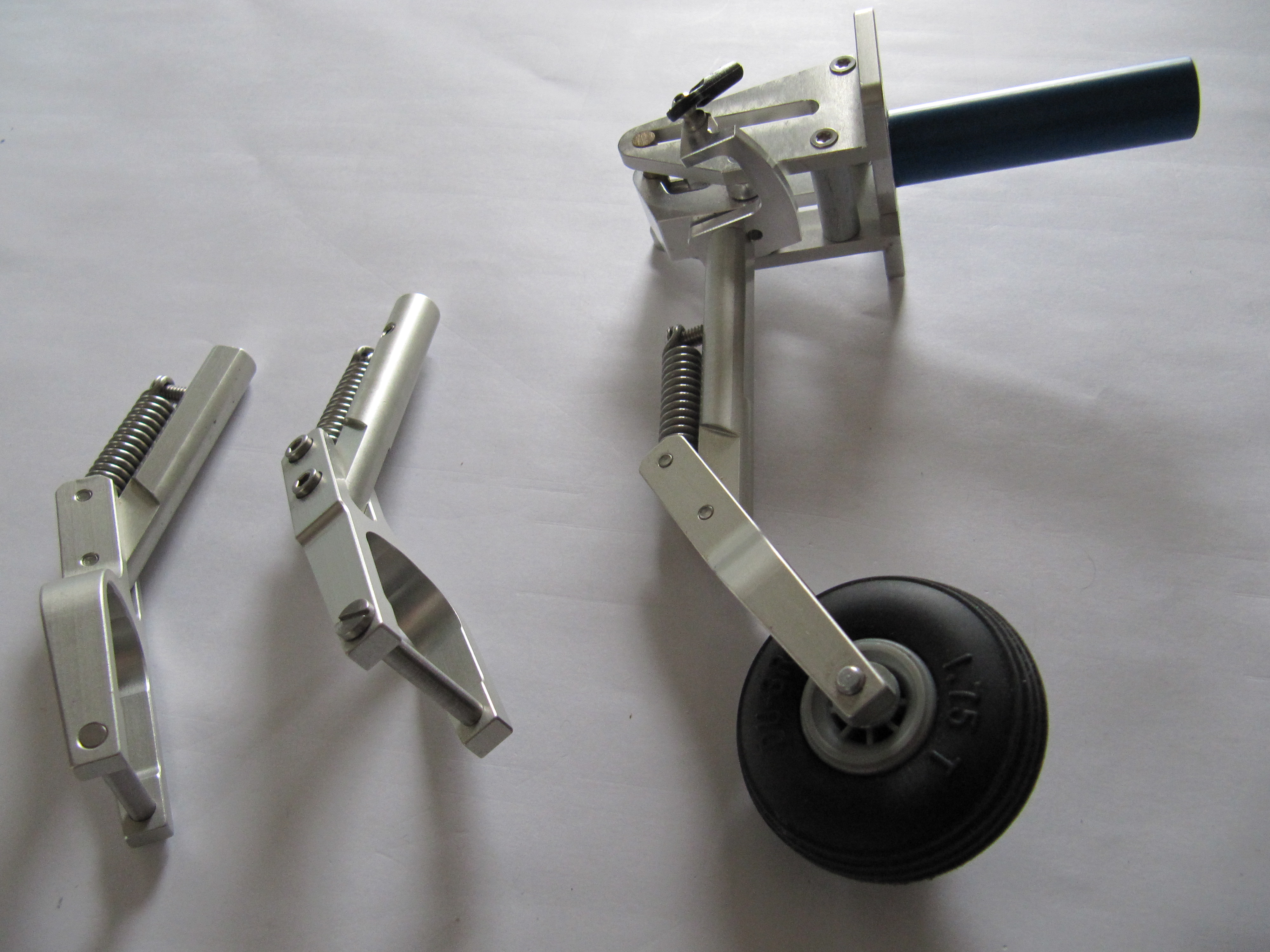

I have a factory now that makes CNC Struts for me..
I need someone to measure the distance from the ground nose gear mount point and the same with the wings.
I'm going to then have some custom struts mated with the retract bodies to get as close to scale as I can..
Rob

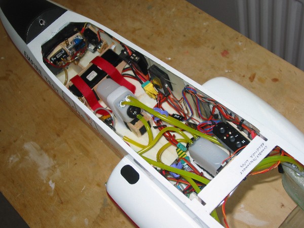

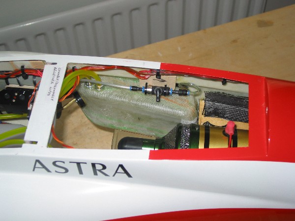

#748

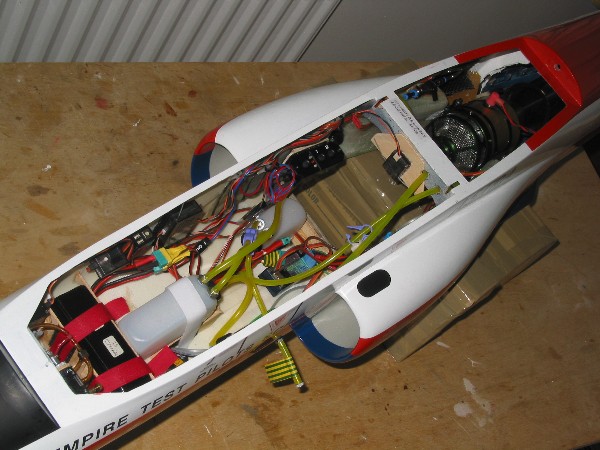

It’s done!!
Much to my surprise, with empty tanks the CG came out spot on what it was with the Stumax. An even bigger surprise is the empty weight .... 12lb 1oz. With 1.2 litres of juice plus what's in the bubble trap, weight will rise by about 2lb 7oz. So it'll take off at around 14.5lb and land at around 12.5lb. Which compares very favourably with 16lb on 11S 5000s and 17lb with 11S 6600s at both launch and land.

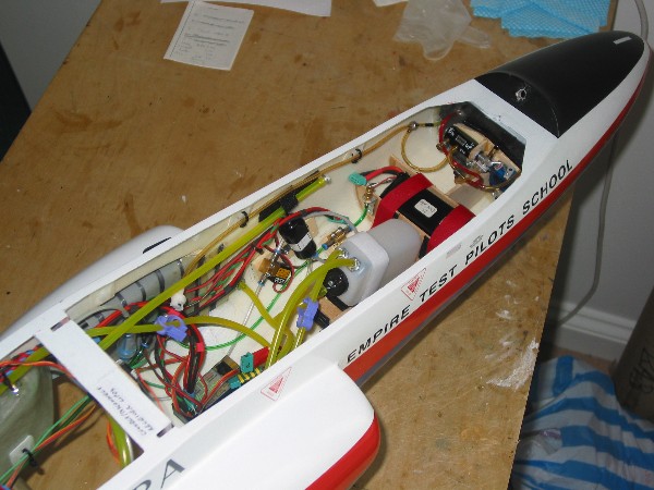

Pic 1 shows the new installation.

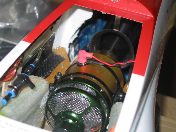

Pic 2 Shows the bubble trap made from a 4oz Dubro tank and Slec tank fittings. The second 2oz tank is to catch any overflow during filling to avoid spills on the ground.
Pic 3 indicates the space saved by locating the retract tank in the extreme nosecone.
Pic 4 shows one of the two scratch-moulded fuel tanks. Total volume is around 1250cc, which seems about right for a MW44. This is the second tank and has a felt filter.
Pic 5 The turbine location is the standard one for this kit.
Pic 6 shows the wooden jig I made to ensure that the tailpipe is central and the correct distance from the turbine nozzle.
I still have to fly the beast, and if the weather-men have got it right, Sunday could be the day for test flights.

#750
The Hawk got its first taste of paraffin-power today, and what a revelation. Because of the wind direction and strength the gliding school had nicked our usual tarmac runway, and we had to use our alternative site of a crumbling concrete track with inch-wide gaps from which sprout large and randomly distributed tufts of grass. There’s a 20ft long tarmac run-in to the concrete which at least lets the plane reach enough speed to allow the wheels to skip over the gaps. I’d never flown the Hawk as an EDF from here because of its long take-off run caused by its excessive weight,
However, I decided that in much lighter turbine mode it was worth risking a flight from here. On slamming the throttle wide, the Hawk shot off at such a great rate that it was in the air before you could say “jack rabbit”. Ker-ripes!! There was no need to worry about that concrete surface at all. With the model rocketing skywards I was almost too surprised to retract the flaps and gear. Unfortunately the u/c refused to tuck up which spoiled the in-flight appearance a tad, but didn’t seem to affect the performance much. The CG and control throws had already been proven over the past two years in EDF mode, so I was able to do a few manoeuvres, the lighter weight and greater dynamic thrust than before giving me enough confidence to do an outside loop amongst other things. What a plane!
Because of the rough concrete surface I decided to land on an adjacent grass area, even though the grass had been too long to allow a take-off. This decision was a mistake as the noseleg dug into the soft earth and bent backwards, removing one of the nose doors in the process.
Apart from the landing mishap, and the failure of the retracts to operate, the flight was a great success, and as you might imagine, repairs are already under way.
The retract problem was a dead air valve servo, a HS55 which may well have given up the ghost on the 5.8V Sensor Switch supply. I’ve replaced it with another HS55, but will start looking for either a micro servo designed for up to 6V, or maybe an electronic retract valve. The nose door is fixed, and I’ll replace the bent piano wire stub in the noseleg tomorrow.
So how did the MW44 and Fox Composites Hawk combination measure up?
Simply magical!
Gordon
