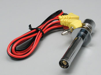

as battery use a 2V dry cell, they last forever (when charged..).

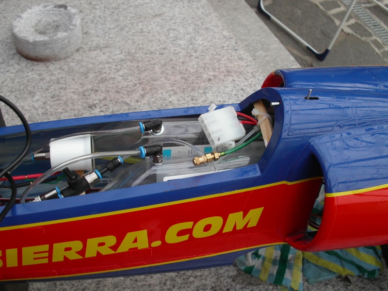

as glow plug connection: it's depend your plane:
if the turbine is open, you can use a connector car style (plug), to install at the startup and remove when turbine running.
if the turbine is inside you can make your own wiring using a fixed connection to the plug, and the ground, black wire coming from the turbine.
you make a plug, and you can connect and disconnect the battery form the model
i use one industrial plug (4 way) and i connect the glow current and the starter with just one plug.
the glow battery has a switch, so i can connect the starter battery for the cool down without energizing the glowplug

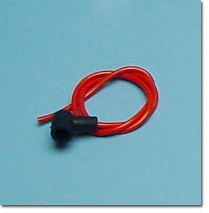

Keep it simple.
I use standard phono plug male on twin core cable direct to 2Volt lead acid/gel battery kept on the ground,plugs into phono female situated at a convenient point on airframe.
Negative lead connected direct to a screw head on turbine mount,posative lead to a small croc clip onto top pin of glow plug.
If you can get at glow plug easily,use standard glow clip.

Use your glow engine glow plug drive. Works very well. I use it on my manual starts WREN 44s. Dubro and other suppliers have a complete kit or you can make your own.
