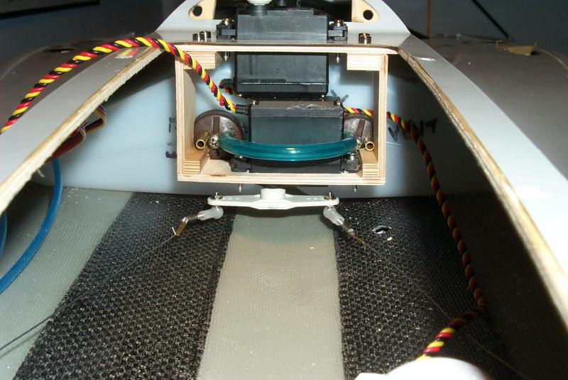

Those tanks look like they could be moved apart a bit because there's some decent clearance at the top... Try offsetting them and rotating the brass tubes to the outside.
The Kevlar tanks that Starto' and I both used are so tight that they were practically laid up inside a Stingray fuse to maximize the fuel capacity. The Jet Tech tanks need to have the fittings rotated such that the brass tubes are turned to the outside. Then they only need a small relief cut in each side of the lower servo tray to fit it all in and clear the fittings.
How are the plastic tanks mounted? Are they fastened down to some sort of structure or left to be supported by the lower skin?
Also of note, I mounted the speedbrake servo on the opposite side of its mounting flange, from underneath. I used an HS-645MG and an HS-225MG for steering. They JUST fit! I think the 645 gave me some clearance issues, can't remember now.

I second Kellys suggestion, you can see how tight the fit is in our birds in post 185. I too moved my speedbrake servo to the underside of the mount, the linkage is more ideal in that location.

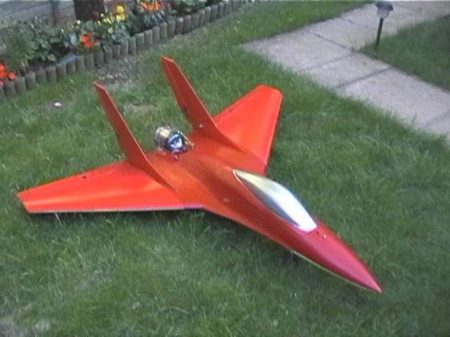

Well my stingray has flown, three times in fact now. It wasnt without hitches, through no fault of the plane.
the first flight was wheels down as an air line unfortuneatly popped off the nose, so we lost pressure for the wheels. theyre spring air so they stayed down. It certainly didnt seem too much of a handful at that speed.
The approach was long and fast, I do have video, but its not that impressive compared to the other vids of stingrays. But it does show the approach speed of astingray without a speed brake.
After repairing the bent u/c legs from the overrun, it flew a second time.
This time id put 3/16 diameter legs on. Unfortuneatly i had to have the u/c block drilled to accept the thicker leg. Not deep enough as the flat id filed was at thetop of the leg. The leg came out in the air, damgled for a while then fell off. wheels up landing resulted into the long grass. No damage fortuneatly.
Third flight, front wheel didnt come up but flew okay for me as its only the second time i had my hands on the sticks of a jet. We had 21mm up elevator and 13mm aileron. The test pilot felt this wasnt enough so went to max rate on his box. I could have done with less exponential.
About 5 mins in it flamed out going upwind, so the test pilot took control and brought it around for a landing . Fortuneatly no damage. it turned out later we found fuel on the outside of one of the elec fuel valve for the autostart. I tightened the festo screws as they were slightly loose, so i think weve found the cause of the flameout.
The gas valve also wasnt as tight as it could be so i tightened that. Interestingly id recently had problems with starting due to weak gas messages, iw would light, get to 17000rpm, go to fuel ramp and then flame out. I was using increasingly more turns on my gas cylinder to get ignition. Tightening the festo connection solved this problem and i had five trouble free starts the following day.
im about to try and post some images, theyre 225k so im not sure if theyll post.
Ah the images are bitmap, ill try to convert to gif or jpg
