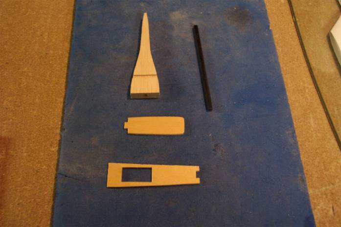

Ok, this is going to work fine, I boxed in the servo bay with 1/16th ply and interlocked the servo mount with the bottom wall. I then applied aeropoxy to everything I could reach. The fin is now very solid in this area, I will tweak on it a little harder after all of the glue cures and see how it is going to hold up. If you use this method keep fitting the servo cover as you make the walls in the bay, it did not take much deformation of the glass to make the cover fit less than flush. More pics to come!

OK, I think I have this thing figured out now. The fin is very stiff where the servo is installed. I am still going to put the stock servo mount in as it looks like it is a key structural member, I am going to lighten it up some before I glue it all in. Now it is on to mounting the fin to the fuselage and then when that is done I get to do it all over again for the right side! Tell me what you guys think.

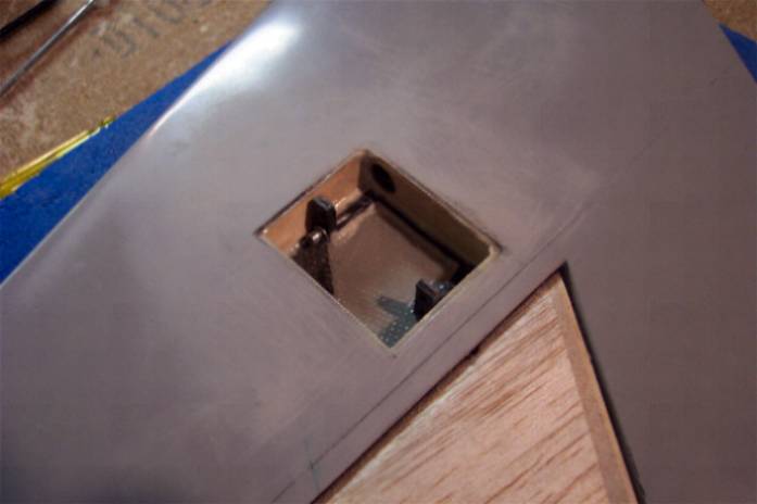

"Coincidentally, I'm working on the stingray rudders right now too. I'm concerned about cutting a big square hole in the side, reducing the structural integrity of the fin. I'll probably try it as they recommend at first and see how it goes. If I need to patch a hole later, so be it I guess... "
Kelly W.
Just food for thought...when I was cutting out the servo cover on the second fin I noticed that it was rather flimsy after I had been messing with the other fin after it was completed. Mounting the servo up in the fin really made a difference in the rigidness of the fin with the servo being boxed in with the 1/16th ply. Thought I would pass it on just in case you cared!
Chris
Kelly W.

Yur' right Chris,
The box section will definitely help restore the fin's rigidity, acting like a series of shear webs. Thanks for testing it and giving us your opinion. I have lots of time before I install the servo because I'm still capping the control surfaces, drilling hinge locations, and working in the fuselage. Plenty of time to make up my mind here.
Switching gears for a second, on my hotspot I really like the fact that the rudder servo is readily serviceable and the control linkage is direct and short. Although it sounds like it would work fine, I don't really like the Stingray's recommended control linkage as I feels its a bit long and not normal to the axis of rudder rotation. Your system wins hands down, so long as the rigidity is maintained in the modified skin.
I've just re-read you posts and have a question about post #83/84. The servo mount looks like it's 1-piece and permanently bonded in place. If so, how are you going to going to reach the fasteners? That looks like it could be a pretty steep angle, even for a ball-end Allen key. Had you stayed with the servo in its downward facing orientation, the fasteners could be accessed through the bottom of the fin. When I made the mounts for my hotspot wings, I bonded in a set of laminated plywood mounting blocks, then used a set of machined aluminum brackets to make the servo mount to a face parallel to the wing skin. I'll post a pick later, after my PC decides to get up on the right side of the bed...
If I follow your lead, I'll probably use the same method here.

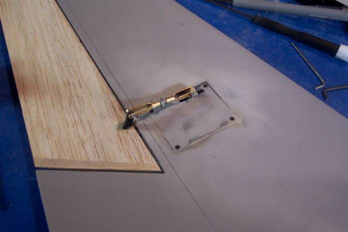

The servo mount is hard mounted. I used the #2 socket head sheet metal screws. The top screws can be accessed with a ball driver and the lower ones have to be removed with a modified allen wrench, actually the forward one can just be loosened and the aft one has to be removed. It is a tight fit and the screws are hard to get too but I think that it was worth it overall. I would suggest that you open up the bay a little more for easier access to the screws. Let me know if you want dimensions on where to start cutting. Also be sure to check how far the rib is inside the fin on BOTH fins before you start cutting because mine were at different measurements!, I got lucky though and everything worked out ok. I will finish the second fin today and then go for mounting them to the fuse. Formation flying would be really cool, I hope to make it to Whidbey this year, but I am pretty sure that with the current situation with Saddam Insane I am pretty sure that I will be deployed for yet another summer! This will be the third summer in four years that I have been gone, I always leave right before the first event and get back after the last one, I am usually gone about 100 days at a time, but if a war starts the 100 day thing flies out the window and we stay gone for as long as it takes!!!

The rudder pushrod lengths and angles apparently worked well enough for a successful test-flight series, but I think the geometry just isn't ideal. The mod that Stratotanker did is great. Short, and at 90s.
