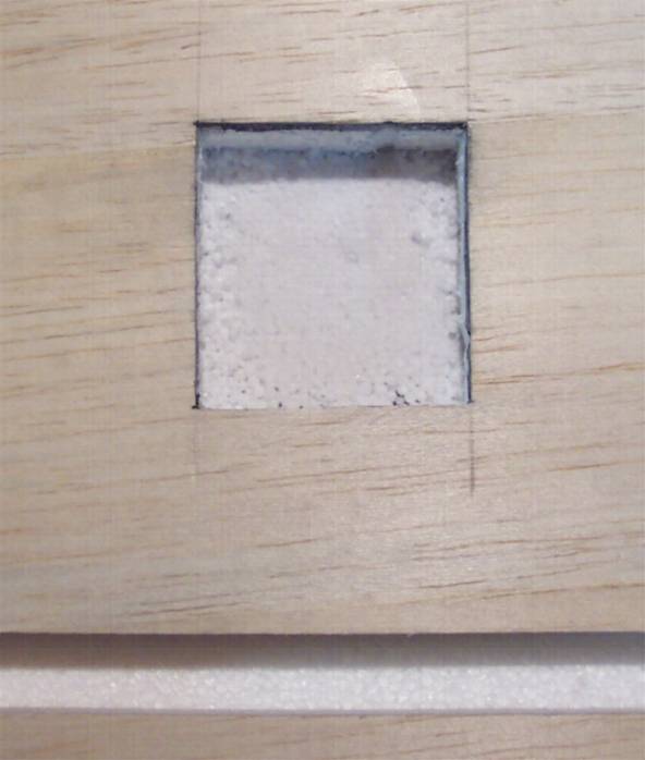

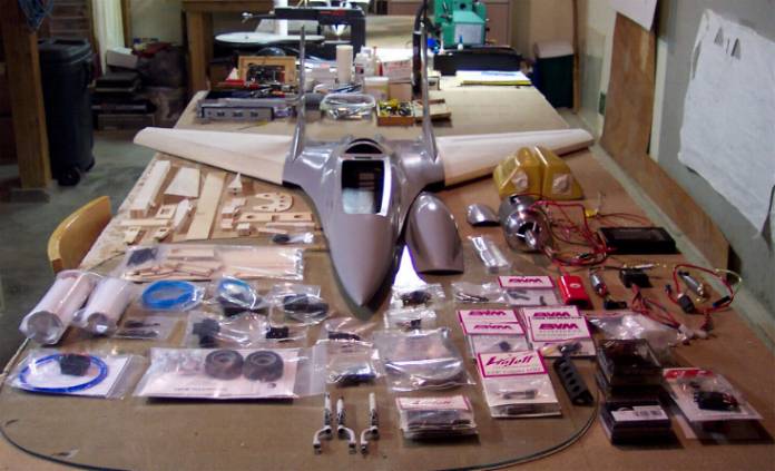

I am starting construction of my Stingray and thought that I would do a thread on its construction and post pics. Does anyone else out there that has built one know of any pitfalls to look out for?, The destruction manual looks pretty clear but you never know until you start cutting up stuff!
Chris

All the goodies!

Default servo well
Here is the stock servo well

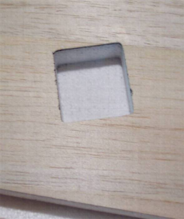

Default servo well
And the new servo well. I will post more pics after I get them more complete. The 8411s fit but it is tight!
Chris

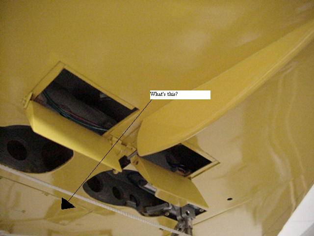

JPOFL, What is the panel just behind the main gear wells? I was looking at building some doors to help with the drag for landing, I plan on using the same setup as the bandits use. If it does not work, I may build a speedbrake on the bottom. I hope to have more pics posted tomorrow or sunday for sure. Thanks for the tips!
Chris

Chris the speedbrake is just infront of the wheel opening,The aircylinder goes to the front. I made my speedbrake out of Xcell helicopter pattels. 60 size.The former just behind the wheel wells is the rear former installed by the factory.
Paul JPOFL

I was wondering what the panel with the arrow was for???
Chris

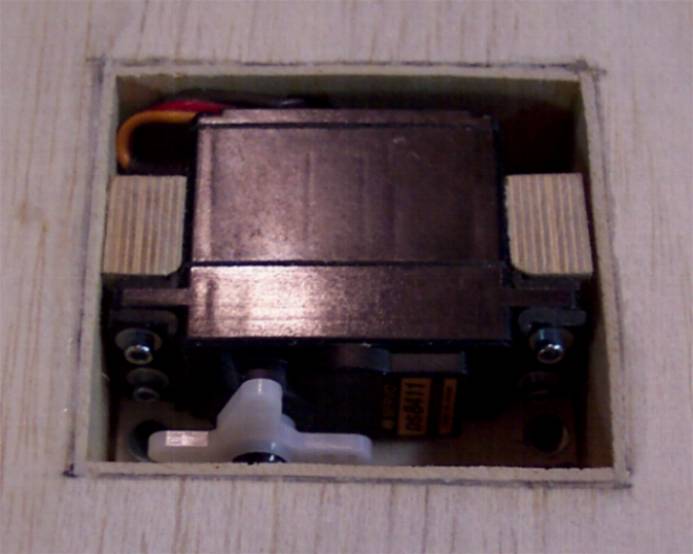

Here are a few more pics of the servo wells. I am going to wait on the covers until after the wing is glassed so I can make them fit as flush as possible. More to come!
Chris

and the servo shoehorned in!

Ok The arrow is pointing to a accest panal for the Wires and tubeing going to the turbine. As far as the speedbrake opening forward.Had to do on how I was going to open the speedbrake. See everything has to be mounted on the outside,because with the Jet Tech fuel cells.There is no room to install anything under them. I might add the speedbrake I was talking about pushing the aircraft down and to the right was the one on TOP. Which I do not use any more.In fact I removed the servo that drove it.
Paul Hopkins JPOFL
