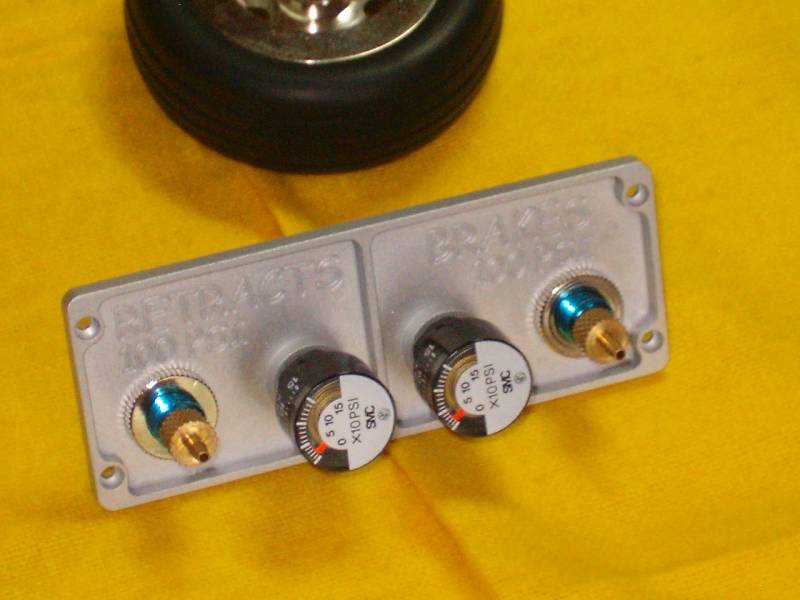

In this little neat Gear/Brakes fill & air tank contents mount, is there something else i need to buy..?....The air seems to return to atmosphere as soon as i disconnect the filling adaptor ( the Brass thingy.)
Brg
Dave

Methinks the brass coloured bit should be permanently attached to your air-pump
When unscrewed, the blue bit will seal.

You also need a model plugged into the other end
Does the pressure hold with the pump still attached?

Yeah...Ive disconected all the pipework.
.. the pressure still bleeds away slightly with both the electric ( ALDI ) and manual (robart ) air pump still attatched..Summats amiss for sure...[>:]

I don't think that matters Dave.
As long as the air system in your jet does not leak, that's what's critical.
I've had my ALDI pump to bits, it's not high tech stuff, it might be leaking there.
If you need nose-weight, fly with your ALDI pump attached......................................

Have you tried putting it under water whilst pressurising it? As Spartan says, leaking through the pump isn't a problem but leaking out of the air gauge/valve/pipework would be.
I was just trying to ascertain whether it was the action of removing the pump that caused the problem or just a straightforward air leak. Do both valves do the same?

Those fill valves leak, ask Todd at Dreamworks, they are pieces of junk, originally put out by air pac.
Get the BV fill valve, have worked flawlessly for me for years.

I am begining to think that way.....but i have one more idea.....I'll nip into work and get some 'Snoop' ...a liquid especialy designed for leak detection.

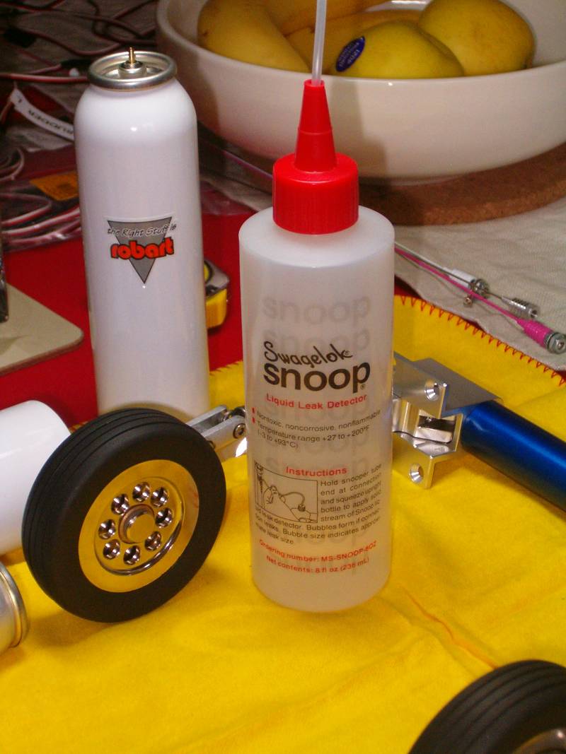

.....Well Found the problem ..or should that be problems...With the aid of some 'Snoop' i found that the steel festo type fitting INTO the Jetronics wsn't tight ..and the the Robart air line i had used to feed into that fitting was'nt sealing properley...The Robart tube is just to floppy to push home effectiveley...
Thanks for all the input guys [sm=thumbs_up.gif]
Brg
Dave.

Dave
Where did you purchase the "Snoop"?

So Swagelok are putting soapy water in a squeey bottle and calling it Snoop, I bet it costs £5 a bottle or more.
Is it alcoholic ? at least you could take a swig whilst testing for leaks.

Spart.......Its very, very inexpensive....It is v.good too, soapy water just dont cut the mustard.
uncljoe...Pm me if you want some..
