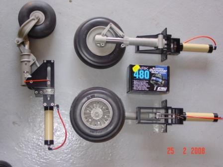

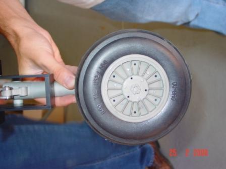

Hi there Glen
I'm afraid your well ahead of me now with your project. The gear looks fantastic, a real master piece.
I've devised a method of top steering the nose leg which is purpose designed for the single seater ..1/5th scale ...and am having the parts investment cast. In my case most of the leg is exposed making it more difficult to arrange reliable steering. I do believe I've got it sorted however. I should have 6 sets in about 2 weeks.
The mains are less of a problem and the chassis design is being machined for me now. They're pretty beefy and so the mechanics would be OK for a larger model. The design also allows the retract angle to be adjusted by fitting a different locking cam. The system is based on Goldberg/Robart locking design. I'll get some pics up for you as soon as I have something nice to look at!
I've been too busy to do much but am back at it now. I've just sorted the inboard flaps and am about to launch into the wings. I had thought od all composite but I'm not prepared to invest the time for what may be a smallish return.

ORIGINAL: Glen Roberts
Hi Henk.
Did you have any luck with Siera for the Vamp gear? Our gear is now complete ( 12 Sets)but I dont know if it will fit in the Sterner vamp.
Cheers.
Glen
Hello Glen Very nice gear! No succes with siera I'am getting very desperate with this kit/drawing of mister Sterner!
Mister Sterner also promised me to send me scale drawing from the gear, so i can let them produce here in europe.
But no sign of live since month's[:@]
Regards, Henk

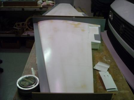

Old 05-06-2008 | 11:43 PM
  #54
Joined: May 2003
Posts: 60
Received 2 Likes on 1 Post
From: Johanesburg, SOUTH AFRICA

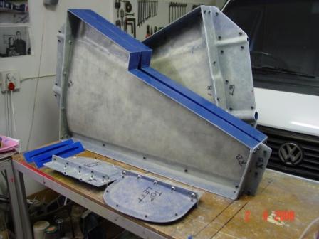

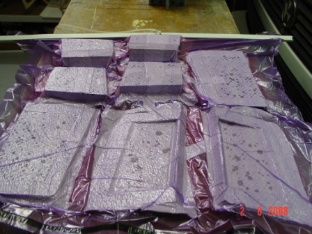

Default RE: 1/4 Scale T11 Vampire.

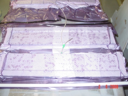

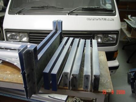

Flap, airbrake and tip molds complete

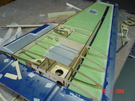

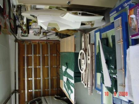

recent progress

Hi Glenn
As I continue at snail pace .....!

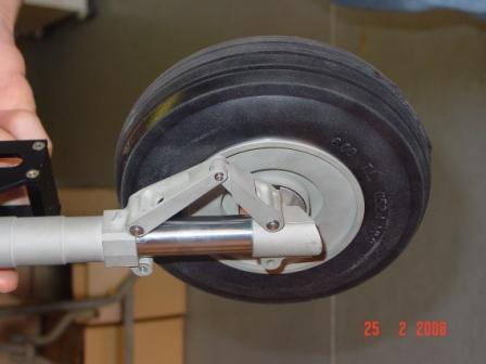

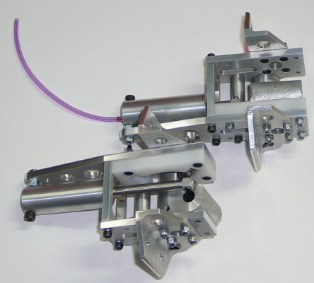

I thought you might like to see the first production units of my mains system. These will do both 1/5th and 1/4 scale Vampire and with a few mods can be made as a universal retract for "simple situations". While they are the first, they don't have the investement cast pivot blocks but just the original sand cast test units.
The first production nose leg assembly is nearing completion too. It of course is a dedicated 1/5th scale leg but I could be tempted to do a 1/4 scale if there was sufficient interest. I have a very friendly foundry owner ...he just take a while to get to my small jobs!
How are you getting on?
Cheers .. Brian

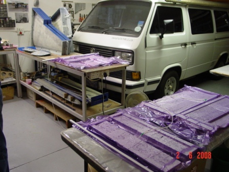

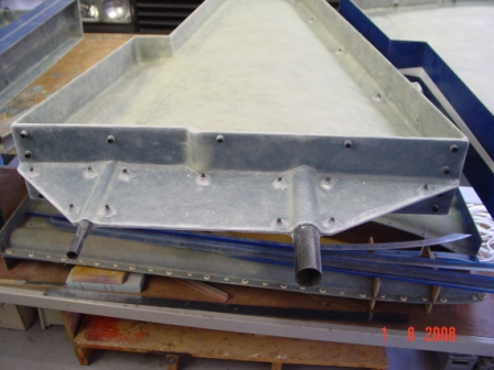

Good to hear that you are still busy on the single seater. We are busy producing the first models at the moment, going beter than I thought it would. I will let the phot's tell the story.
Nice looking U/C. We have produced 12 sets of gear for the two seater to start with. Ours are machined out of bar stock, rather costly.
Cheers.
Glen.

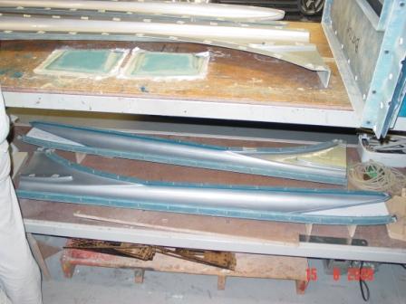

Old 06-10-2008 | 11:44 AM
  #60
Joined: May 2003
Posts: 60

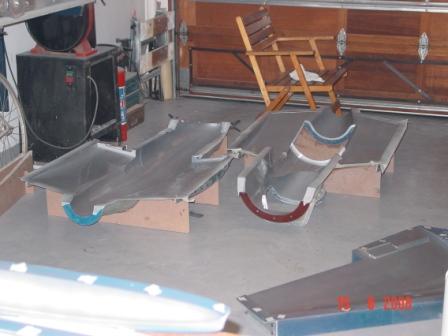

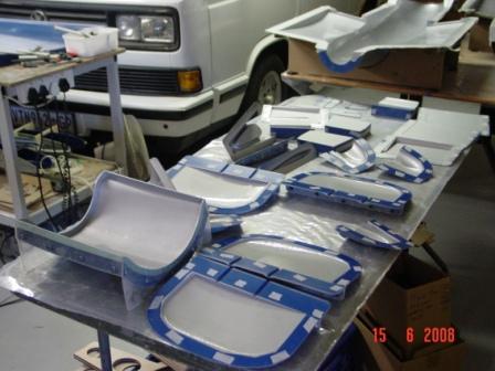

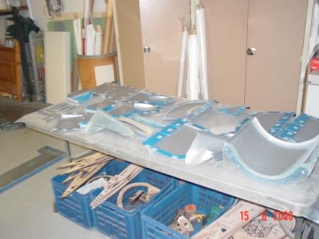

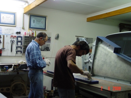

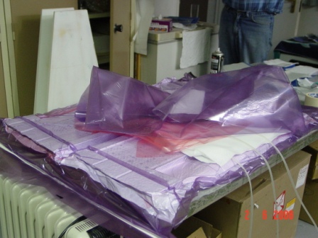

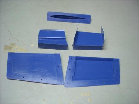

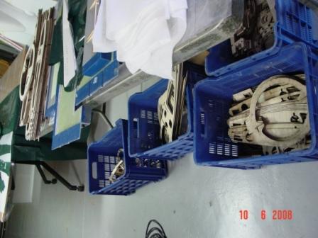

Some more of the moulding.
ID:	967983   Click image for larger version
ID:	967984   Click image for larger version
ID:	967985   Click image for larger version

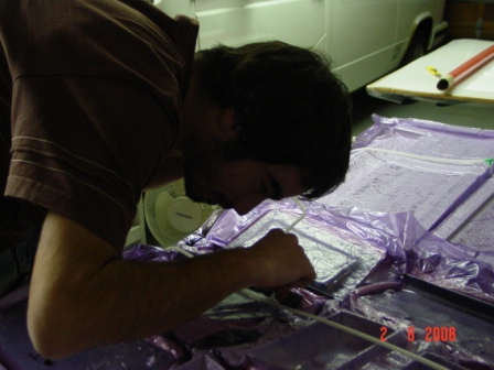

And more
ID:	967991   Click image for larger version

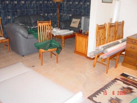

Old 06-15-2008 | 03:12 PM
  #66
Joined: May 2007
Posts: 40
From: Gauteng, SOUTH AFRICA

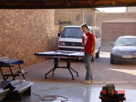

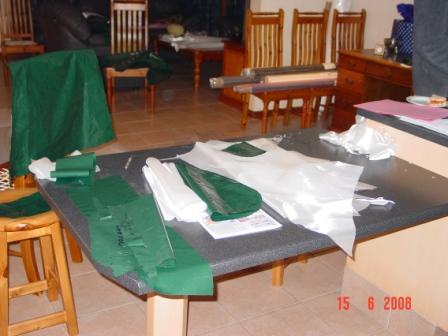

and some more[]
lounge and kitchen are now reserved for cutting glass.
cheers everyone
Dylan.

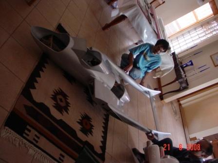

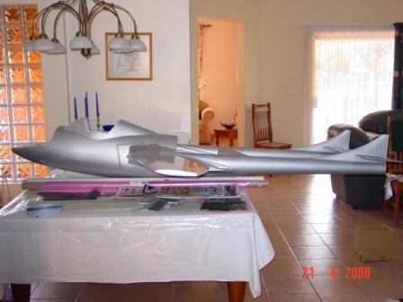

ID:	971119   Click image for larger version

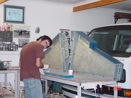

Old 06-19-2008 | 05:44 PM
  #70
Joined: May 2007
Posts: 40

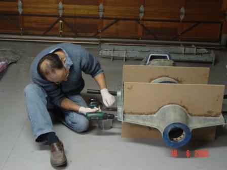

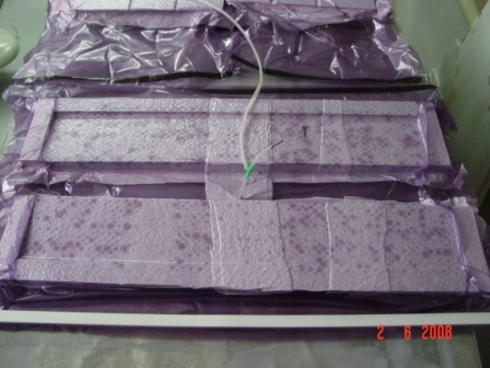

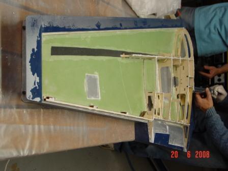

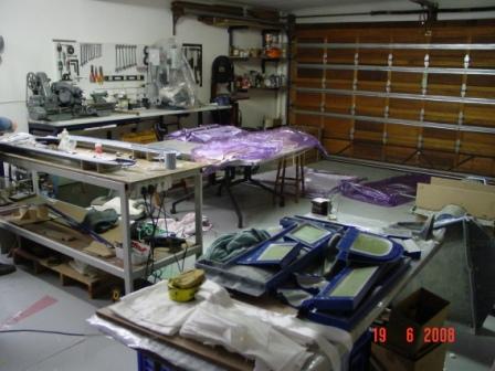

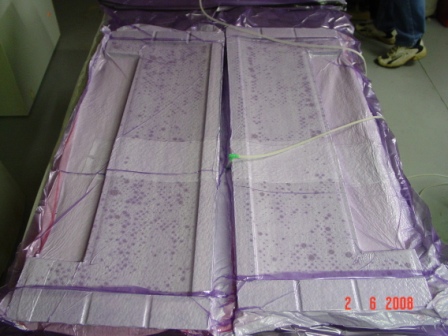

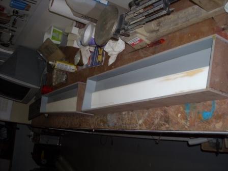

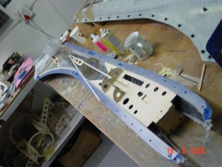

been a really busy few days, fus out the mold, booms joied(waiting for joint to dry)
skins for everything else layed up, just awaiting woodwork and joining.

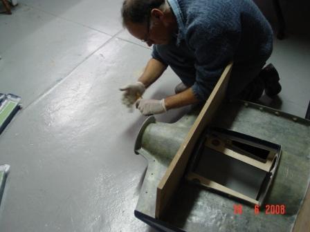

Old 06-19-2008 | 05:47 PM
  #71
Joined: May 2007
Posts: 40

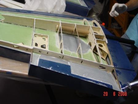

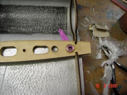

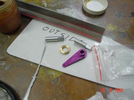

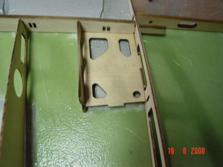

hmmm that servo well looks upside down???? sorry dad[sm=confused_smile.gif]

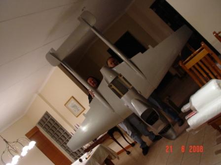

latest fus

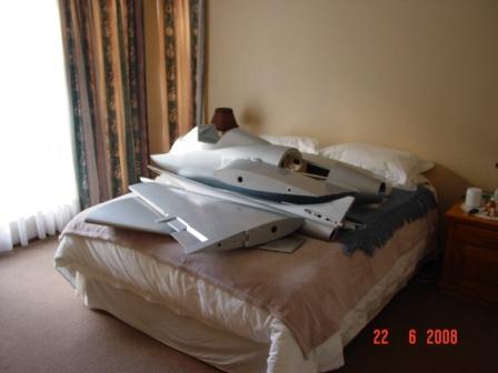

Joined: May 2007
Posts: 40
wow

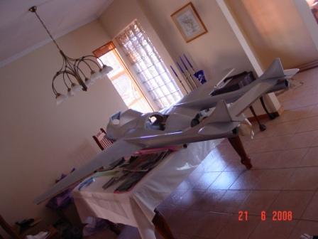

its big, and it now lives in the master bedroom
