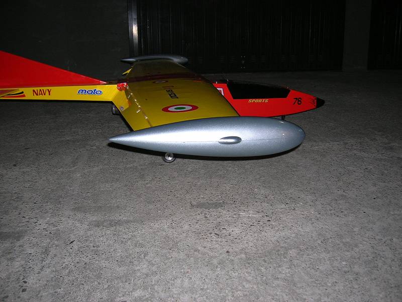

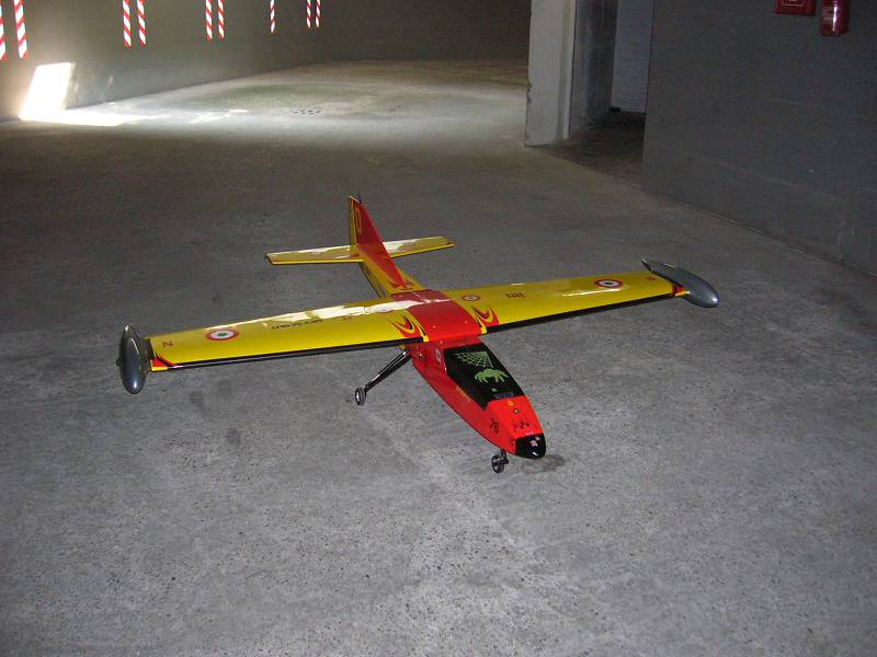

Hello friends , I have the fuel tank 2.120 litres capacity, on my trainer jet p60, end the time on fly is 10 minutes, but I need 4 litres capacity[:'(] can I the fuel tanks on the wing?

More pics the fuel tank..

bad idea for several reasons....
-2 more litres of fuel is going to add a lot of weight to your jet which you have to pack around for the whole flight
-the extra weight will increase the wing loading, and make the plane a real slug to fly until a substantial amount of fuel is burned off.
-the extra wingloading will increase the stall speed, and may well increase the risk of a takeoff accident, or a high speed stall
-without a pump in each wing tip tank, there is no guarantee that they will empty completely, or evenly (even that is no guaranty)
-if one tank emptys more than the other, or you have one that refuses to empty, you are going to have a lot of difficulty keeping the wings in trim, and may run out of aileron control.....
10 minutes is not a bad endurance for a jet..just land, check everything over, refuel and go fly again...............

HI, Wayne22 thanks for your repley..but I not have alternative ..here is the my wing..is very strong ho sorry I have 0ne idea.

It is better put a center line tank!
