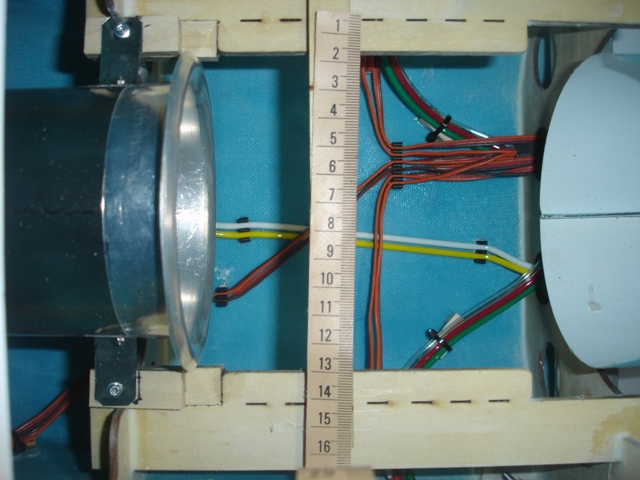

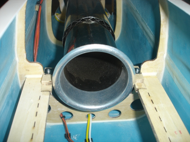

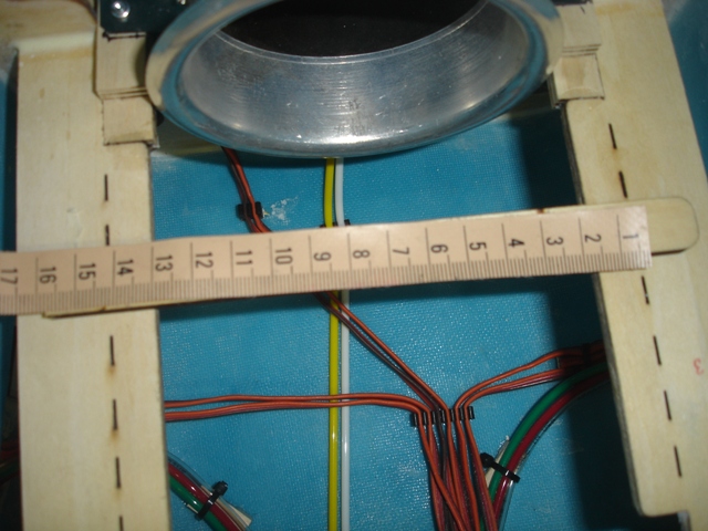

Old 08-23-2007 | 04:29 PM
Joined: Nov 2004
Posts: 61
From: Norfolk, UNITED KINGDOM
Default RE: Which Hawk?
120mm is not a problem for the Fei bao Hawk, plenty of space on the rails, it would need a little fettling of the bearer, but would leave plenty of meat left to mount the turbine.
The external quality of the Fei Bao hawk is excellent, and the build quality is quite good, just need to go through it to make sure everything is glued well, and change the elevator bearings.

Here are some pictures of the Fei Bao Hawk engine bay, may be this can help you. You can always reduce the thrust to 25#s and the fuel economy should be better than a P-80, the reason been that you need less throttle because the higer thrust at lower throttle stick position.
