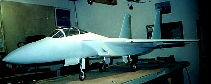

Heres a pic of my F15, I have just started covering the wings and tail feathers with Flite Metal ali covering, I will also be using BVM Metal-Kote paint to complete the varied metal textured finish. Very time consuming but will really look authentic.
- Marty

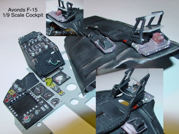

Attached is a shot of a cockpit I'm working on for my sons' Avonds F-15.

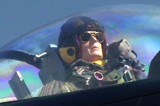

Hi there Paul, your cockpit looks awesome! great work... can you tell me some more about it, eg is this cockpit available? I would like to get one of these if possible? As I just have the standard ABS vac. formed kit version.
Also do you know of any full body 1/9 scale pilots that may suit?
I have agreat 1/6 scale pilot in my ADF16, and this has spoilt me as to pilot choices... Paul do you have any pics of your F15, got me curious to see your 'Eagle' after such a great cockpit...

Marty, The cockpit is going to be something. It is for my sons' F-15C (singl place). The cockpit is going to open very scale-like, including the entire rear deck, revealing the TEWS bay and all its contents. I fugure it'll be done around 2010 or so, just kidding, although it is a project in itself. The rest of the model at this point, is nothing to get excited about. It is currently flying and getting the bugs worked out. I am leaving the existing cockpit untouched and the one I'm building is an alternate. I will post picture as the construction proceeds. Eventually, the entire airframe will match the detail of the cockpit.

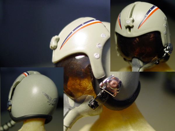

As for the pilot. Too bad there aren't 1/9 scale pilots the quality of the Aviator series that you posted. I got my son the F-15 Aviator pilot and he will be used for reference. In my opinion, the Aviator/GI Joe type figures add too much weight. I am a big fan of the DGA type of pilots. Body sewn and stuffed with batting, latex head, hands and feet, sewn clothing (see the pilot in my cessna at <http://home.san.rr.com/aircor> ). Time consuming and very light. As far as helmets, there is a series of 1/9 scale helmet collectibles on the market that are very nice. They are the Gentex HGU-33 type and not the current issue HGU-55. But they are made of heavy metal and the helmet is not completely hollow. I used one to make a mold and cast a new shell from epoxy. Very nice (see attached). I have also made my own latex pilot bust (to attach to sewn body).

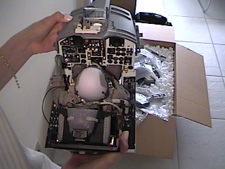

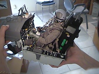

Check this out Boyz this is for my 15 get a load of the size and detail. .................. BVM That one LOL. :idea:
Regards...................Johnny Hernandez

Default AWESOME!
You are THE MAN!!!
Great detail. How long did it take?

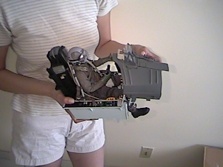

Johnny,
What F-15 Kit do you have? That Cockpit, from the Blue Box Toys Elite Aviator series is 1/6 scale. I've seen a thread where there is to be a 1/6 scale F-15 sometime in the future but was unnaware of one now. Have you weighed the cockpit and pilot. I'm thinking at least 3-4 lbs. even with the portions of the cockpit that you have removed to make it work. Is it for flying or static? They sure are nice looking.

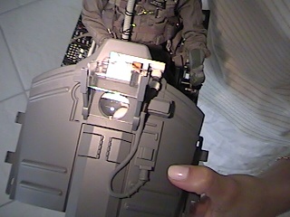

I can guarantee you tha none of my jets are static, I'm sure most of you will agree with me this is a 1/6 scale cockpit yes and it will go up with my beast. Go to Superman and you will see what I'm talking about.
here's a nother Pic boyzzz

At one time I was considering modifying the Blue Box 1/6 F15 cockpit for my 1/6 AD F16, but when I saw the weight of the cockpit unit, decided it would not be s good idea! however a 1/6 F15 is one big puppy! and if built light could handle the extra weight a slimed down example of the Blue Box cockpit.

yes there is a 1/6 scale F-15 floating around. I guess the manufacturer is still working on it, but my guess is that is where this one came from.
That plane is so big that it could pick up this cockpit and a bricko block no problem. As I mentioned in the other thread I think it is a splash of the Byron F-15, so you could even go on the used market and get a 1/6 F-15 right now.
And I have one of those cockpit too, they would be perfect for this jet.

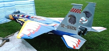

Heres colours of F15, thought about Streak Eagle and thought again....Decided on this!
