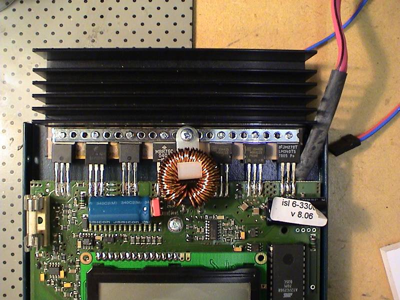

Hi guys. I am having some trouble with my charger and I was wondering where to send it in for repair. Do they have a service center in USA?

Whats wrong with it? If its showing "disconnect bat one " I may be able to help.

There’s two things I know of that will cause this the first is one of the three tiny surface mounted capacitors to the left of socket on the left hand side. I found the one of them went short circuit which makes the charger think it’s got a battery connected. I took them out one by one till I found which one was the problem if you are lucky then it will be the first one but I would replace them all anyway with normal capacitors. They are there to stop interference terminating the charge prematurely (apparently). I have fixed two this way and they are both going strong (Is yours Geoff?) I think I still have the values at work and will post them tomorrow. Spartan Missile had the same problem and his was traced to the top left (I think) transistor on the rail?

I had the same faults, but unfortunately jason's fix didnt help me.
I obviously fried it good.
I had a power mosfet go short on me.
I replaced 1st & 3rd fets from top left hand side with the nearest equivalent i had at work
IRFZ44
T0220 package
Pin out from left to right gate, drain, source.
Low RDSon, something like 0.025ohms.
Anything similar will do.
Be careful not to damage thermal interface strip when replacing the fets, you will end up shorting the drain pins

The 1st & 3rd fets are easy to replace once unscrewed from heatsink from other side
Re use any top hat insulators etc

Miguel,
For channel 1 I replaced these 2 fets
But maybe try Jason's capacitor fix first, its easier to do, you might be lucky ?

Heres the cap values.
Capacitor "1"
(if defective replace after the test by 22 ... 33 nF / 100 volts / foil type, not an SMD/SMT type)
Capacitor "2"
Capacitor "3"
(if defective replace after the test by 100 nF / 100 volts / foil type, not an SMD/SMT type)
