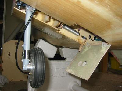

Default gear doors
what a pain these were and still are, hope they work as good in the air as on the ground

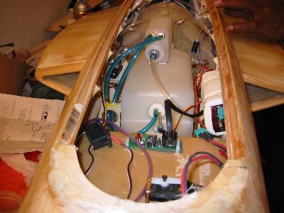

Default inside
i have modified the tray in the front from what you see here, to accomidate the full depth cockpit.

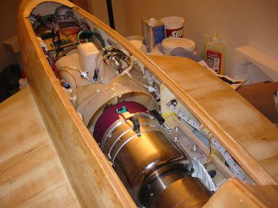

Default turbine rear
if you look close enough you can see the lower half of my homemade bypass.

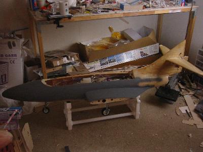

Default jet as a whole right now
heres a full jet pic, i startted priming and got tired. haha

Default Fuel System
pantherflyr
Are the 11oz saddle tanks in the picture part of the main fuel system? If they are, you may want to run fuel through them to make sure you can draw all the fuel out. I had a problem with 10oz oval tanks laying on their side. My clunks wouldn't get to the last 1.5oz of fuel(3oz total). I had to modify the clunks by drilling them out and installing a brass tube extension to be able to get all the fuel out. Your setup may work a little better since the your tanks are inclined and the shape of the tank may help a bit with the clunk angle.
Just thought you might want to check it.
Great project, BTW.
Old 04-16-2003 | 05:28 PM
  #33
NickC5FE's Avatar
My Feedback: (31)
Joined: Feb 2003
Posts: 2,887
From: Fairfield, CA
Default f-9f2 panther progress UPDATED
yes we ran fuel through before all other stuff went in. it works flawlessly, being sucked out of the saddles first then the mains. thanks, nick

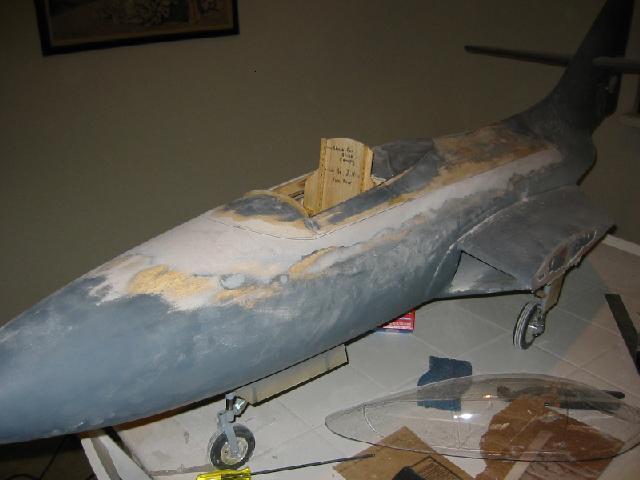

Default new pic added

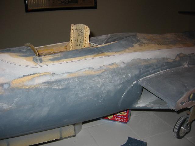

hey all this is the current state of my panther. Trying to get the hatch perfect, and it is dang close to BVM quality "gapness". We used bondo and did the "squeegy" method. Hoping to get it done this month, but am really busy with work. Nick

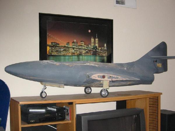

Ok well this is about as current as last week. Finishing off the hatch and getting it BV-Quality was hard. Also been working on the cockpit, scratch building cockpits aint fun! Its a lil dusty now, but getting paint soon. Hope to have it out at the AZ Jet rally for sure, things are looking up. Nick

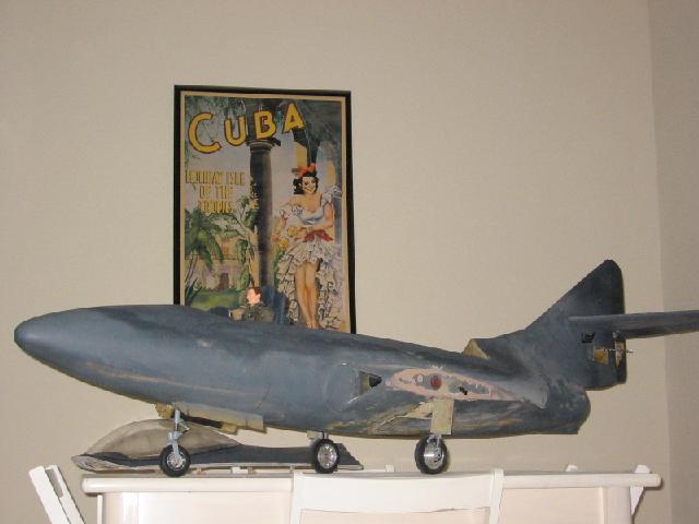

pic of fuse

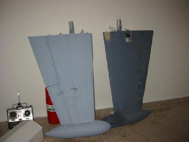

Default NEW PIX!!!!!!!
LEFT WING IS DONE WITH PANELS AND ALL. RIGHT NOT YET
