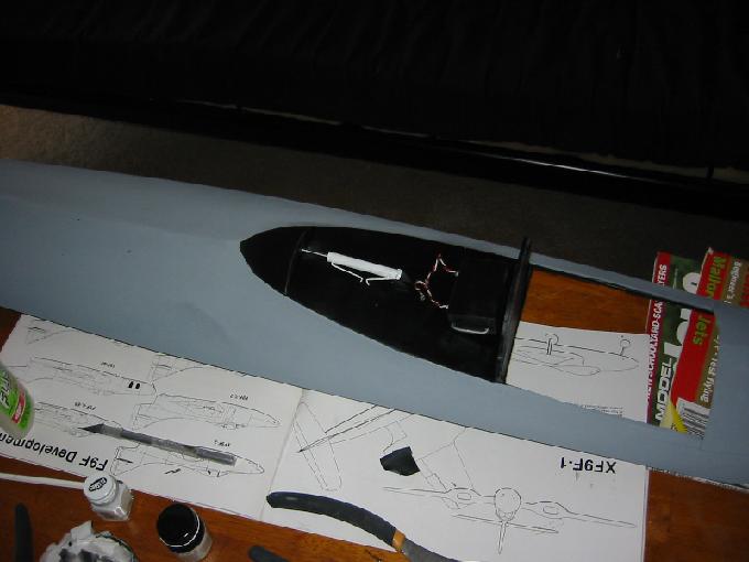

Default DECK
we made a false hydro ram and radio box to fill in the back deck, maybe not scale, but cool lookin

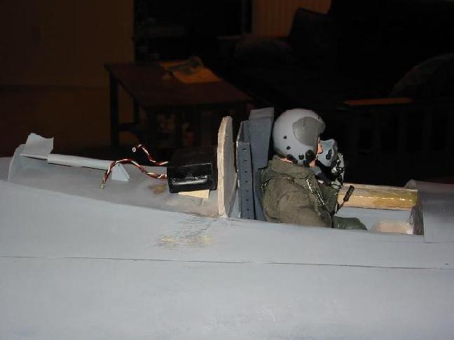

Old 07-28-2003 | 04:40 PM
  #52
NickC5FE's Avatar
My Feedback: (31)
Joined: Feb 2003
Posts: 2,887
From: Fairfield, CA

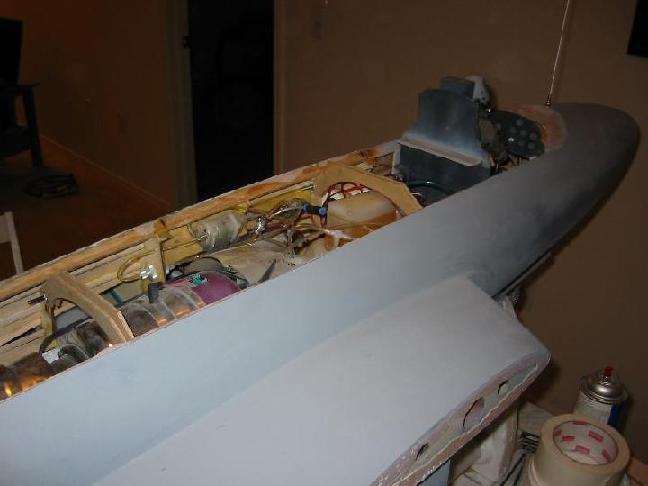

Default innards
pretty much a messy view of everything in but not tydied up yet

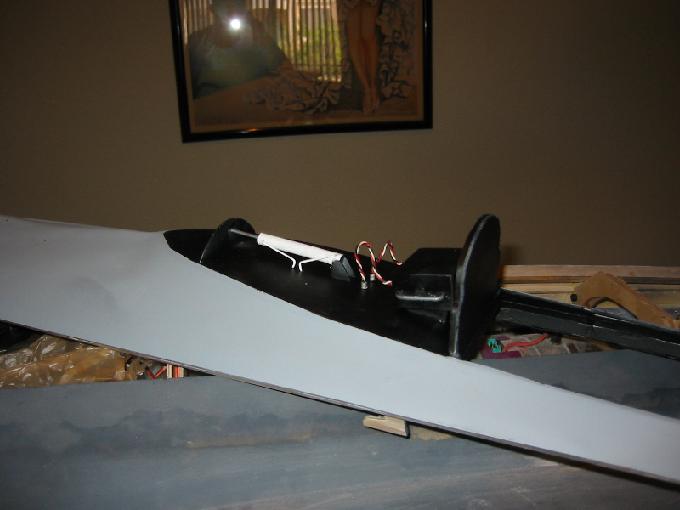

Old 07-28-2003 | 04:42 PM
  #53
NickC5FE's Avatar
My Feedback: (31)
Joined: Feb 2003
Posts: 2,887
From: Fairfield, CA
Default fuse and antenna
using a deans rmovable, and will be heatshrinking it to be semi-permanent. gear doors look good

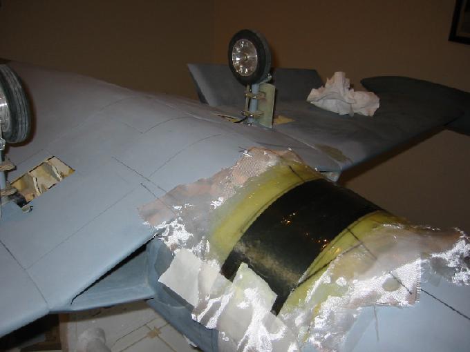

Old 07-30-2003 | 02:55 AM
  #57
NickC5FE's Avatar
My Feedback: (31)
Joined: Feb 2003
Posts: 2,887
From: Fairfield, CA
Default f-9f2 panther progress UPDATED
matt, i made my pipe. good old fashioned shimstock, and my local luke afb metals tech shop. we made templates to jc spec and wrapped the stock around them, overlapping by 1/4inch. It is a dual walled pipe. When ground checked, the pipe ran remarkably cool, the inner at the engine was 400 degrees or so, and the tail around 300. the outer was 90 degrees. We used the ejector action, and its cool, oh yeah we made a bypass too, it all is gr8. Nick

Old 07-30-2003 | 04:53 AM
  #59
NickC5FE's Avatar
My Feedback: (31)
Joined: Feb 2003
Posts: 2,887
From: Fairfield, CA
dimensions are as follows:
inner pipe 85mm front, 80mm back
outer: 95mm front, 90mm back
it just barely fits in through the back of the fuse, but it does.
Oh yeah, we used 6 thousanths shimstock from mcmaster carr. Nick

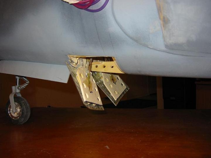

NickC5FE's Avatar
My Feedback: (31)
Joined: Feb 2003
Posts: 2,887
From: Fairfield, CA

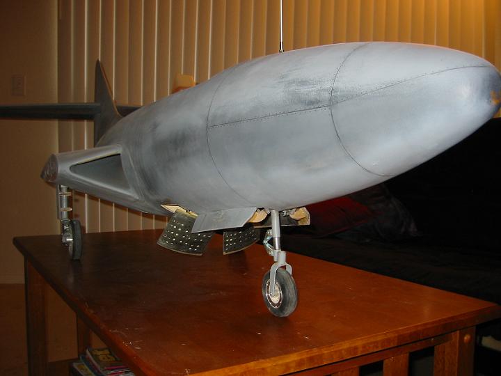

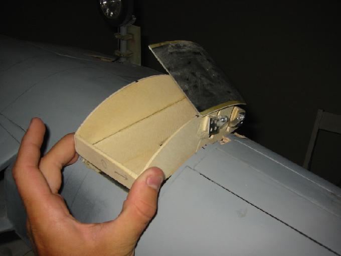

Default SPEEDBRAKES!!!!!!!
We were doing panel lines, and decided at 90% building, why not do speedbrakes. Molded out of many layers of glass and carbon, and will have a full scale frame in the rear. Looks good though, they are almost done

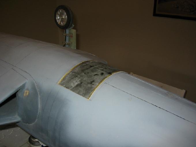

Old 08-05-2003 | 10:41 PM
  #63
NickC5FE's Avatar
My Feedback: (31)
Joined: Feb 2003
Posts: 2,887
From: Fairfield, CA
Default pic of panel lines start
panel lines
Old 08-09-2003 | 05:51 PM
  #64
NickC5FE's Avatar
My Feedback: (31)
Joined: Feb 2003
Posts: 2,887
From: Fairfield, CA
more speedbrake

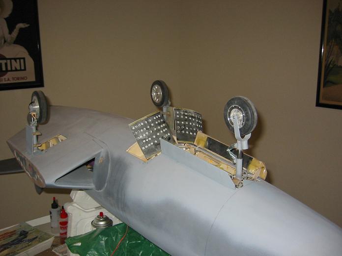

Old 08-29-2003 | 12:55 AM
  #66
NickC5FE's Avatar
My Feedback: (31)
Joined: Feb 2003
Posts: 2,887
From: Fairfield, CA
Default actuators installed
almost done. they work great. all is left is filling in the gaps and prettying it up.

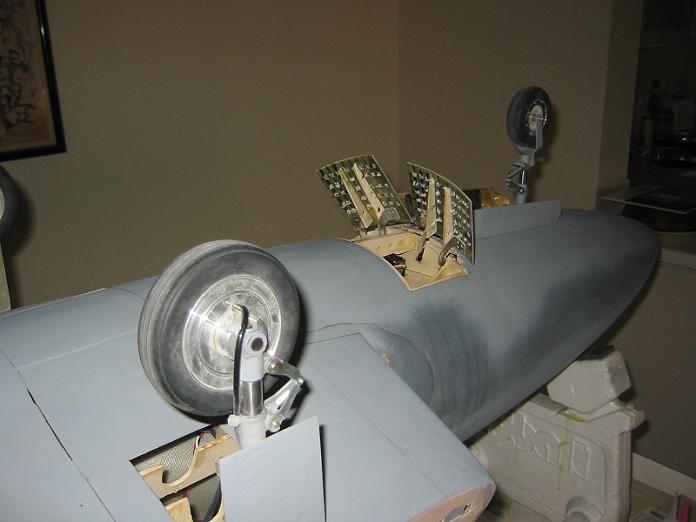

Old 08-29-2003 | 12:56 AM
  #67
NickC5FE's Avatar
My Feedback: (31)
Joined: Feb 2003
Posts: 2,887
From: Fairfield, CA
Default 1 more
1 more

Beautiful work....how did you make the panel lines and rivets?
Old 08-29-2003 | 01:33 AM
  #70
NickC5FE's Avatar
My Feedback: (31)
Joined: Feb 2003
Posts: 2,887
From: Fairfield, CA
those panel lines and rivets are just drawn on for now. it is my template for the tape for the lines, and the real burnt in rivets. thanks for the compliments. it is going to be painted in the red blue and yellow, (drone jets). I am going to finish, trim fly it and fly a few times, then sell it to fund a yellow f-16 c, cant wait!

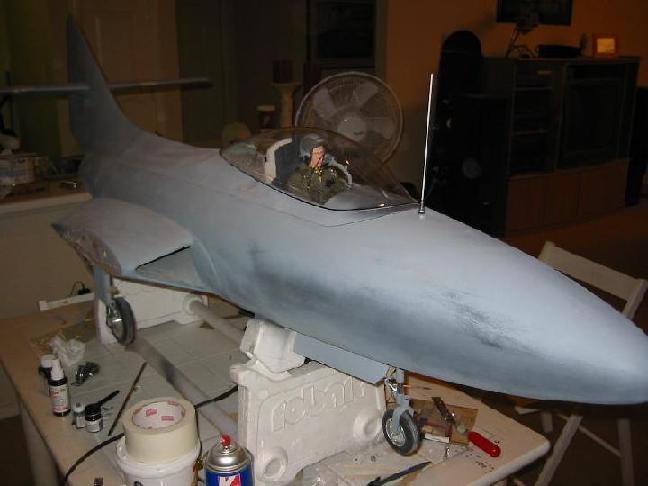

Default pilot
Thats a great jet you are building. One comment though. The pilot you've chosen is a little modern for your plane, isn't he? Blue Box Toys at http://www.blueboxtoys.com/bbi/F_bbi.html makes an F-86 pilot from the same era that would be perfect. Select Elite Force, then Aviators to see a good picture of him.
Tim
Old 08-29-2003 | 01:37 AM
  #72
NickC5FE's Avatar
My Feedback: (31)
Joined: Feb 2003
Posts: 2,887
From: Fairfield, CA
hey tim, i had already realized that. when i bought him, they hadnt come out with the f-86 pilot. i am going to scoop one up, and put this guy in my t-34 (air force) i am also building. thanks

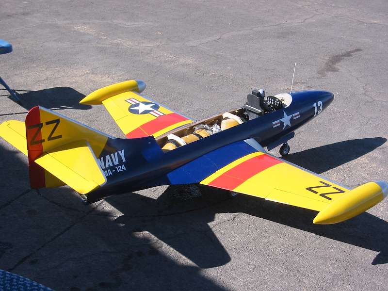

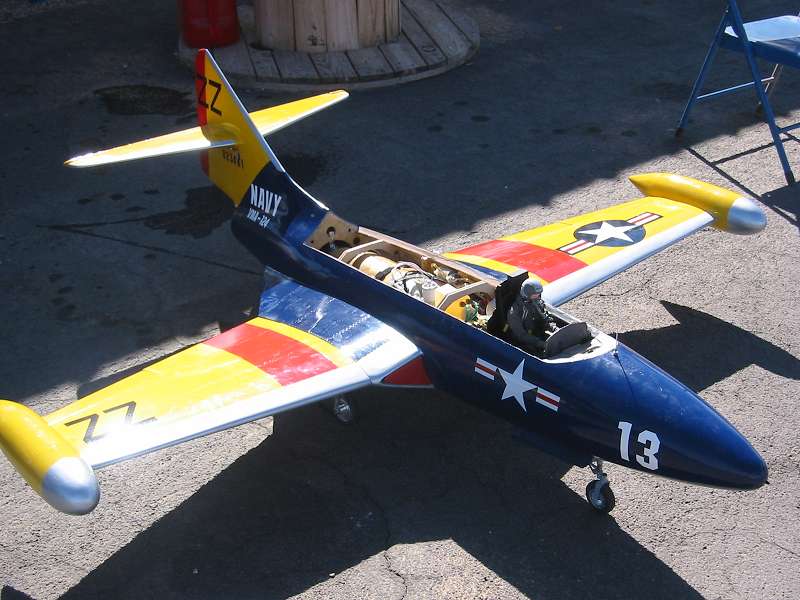

Old 11-10-2003 | 08:08 AM
  #73
NickC5FE's Avatar
My Feedback: (31)
Joined: Feb 2003
Posts: 2,887
From: Fairfield, CA
Default RE: intake
MAIDEN FLIGHT WILL HOPEFULLY TOMORROW (TUESDAY)!!
ID:	73658   Click image for larger version
