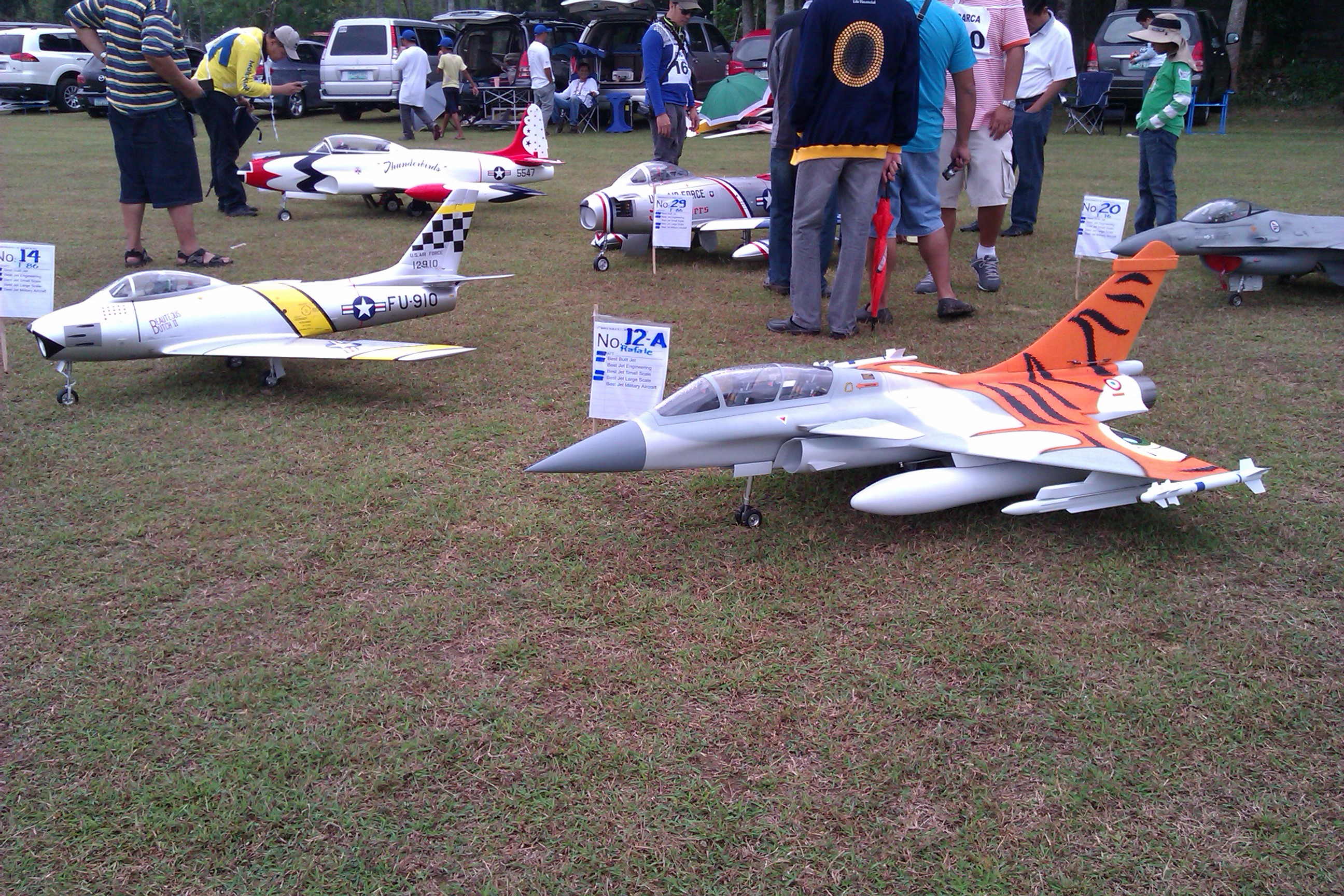

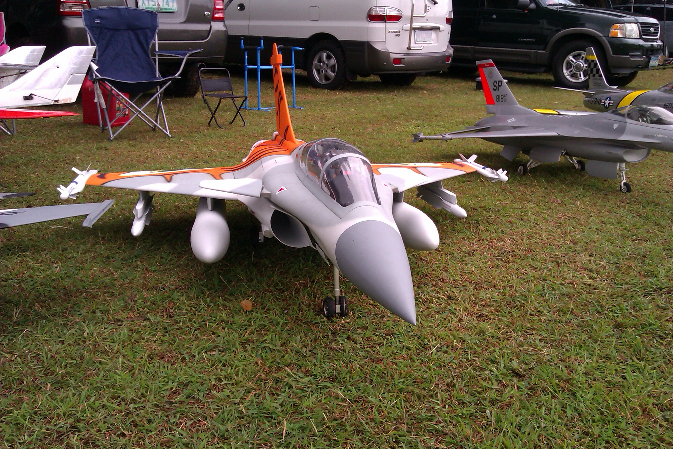

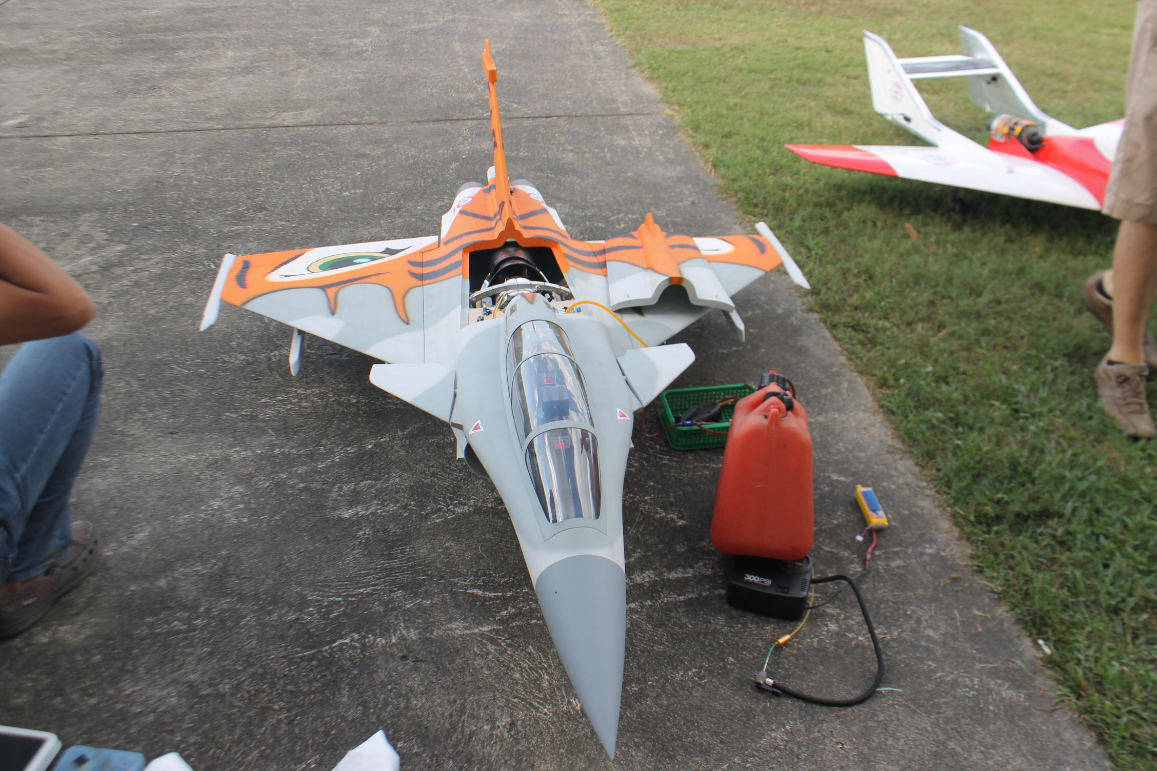

Guys,<div></div><div>Just built and maidened The feibao Rafale! I also experienced the brutal takeoff but it wasnt to bad... just push the nose down...</div><div></div><div>I used high throws to fly with full canards. I found the low rates to be insufficient to move the plane quick enough.</div><div></div><div>Also, My Canards are linked to D/R and Trim of the elevators. Do you guys couple the canards with the elevator trims also? I am not sure of this at the moment if i should have linked the two. </div><div></div><div>Additionally, how long do you guys fly? I have a 120SX in mine....</div><div></div><div>Thanks! </div>
