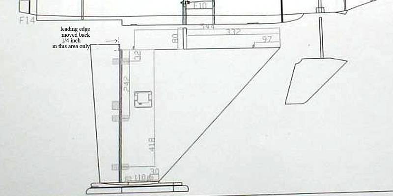

I have a FeiBao Rafale. I have been flying it for the past 6 months. I used 5 hinges and 8411's on the elevons and have had no problems with fluttering. I am flying it with an RTI turbine with 28 lbs thrust and it's fast!
As far as for smooth rotation on takeoff, use full cunard (almost touching the fuse). Make sure the CG is 140mm back from the wing's leading edge. I am using a 9z radio with -40% expo and servo delay. Slowing down your servos will greatly improve the flight of this jet. It flies smooth and scale.
Hope this helps you. Good luck.

Hi Extra 300, I have two friends with the same issues than you with their Feibao Rafales. It is almost imposible to achieve a normal take off, you need almost 600 ft of paved runway and full canard and elevon posible deflection to get lift off rotation. When this finally occurs the nose suddenly takes a dangerous up position.
Even with the CG at 140 mm. the main gear is located too aft. You can diminish the problem increasing the nose up incidence on the ground to get some positive angle in take off roll.
The best solution would be move the main gear a little bit forward to locate it closer to the CG. You can make this easily changing the angle of the woodden seat of the retracts. You can add a wood wedge in the retract base in order to get some angle in the struts moving the wheels forward.
One of my friends changed the fuel distribution for a better take off performance. The main and larger tank is located too forward and increases too much the nose weight in the first part of the flight.
He canceled this tank and replaced it for two lateral tanks just behind the turbine mount glued in both sides of de fuselage. Those tanks are conected in that way that they are the first to get emptied.
With all that mods, the Feibao Rafale almost gets a normal take off.
We didn´t noticed any flutter. We installed good and large surface horn and small servo arm in the rudder and ball-linked.

Dany it sound like you have inserted your elevons to far into the wing which has limited your throws, i had to trim off the trailing edge of the wing to get the correct movement, i also modified the root section of the elevon by moving it back by 1/4 inch at the section that overhangs the wing. this allowed for full travel without bottoming out on the fuse.
Alan
