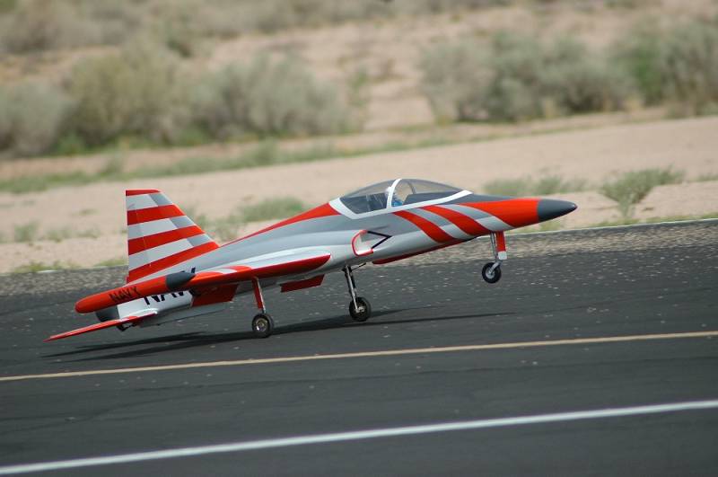

I have one that is setup to just like the manual shows. No mods were done. The plane flies fantanstic. It tracks straight, it lands slow, it rolls axial. It slow flies very stable. I dont think I could have bought a better first jet.
I only have 16 flights on the Flash so I can't tell you how it will hold up over time.
I have a P120 SE for power.

Had my flash for over a year and still looks like new. Supplied retracts are excellent Behotec units, no need to change them for different makes but if you want to fly from grass then as Dave has done, a set of trailing link legs work well. Mine has a P80 and is not lacking with this motor and my timer is set to 9 minutes. Great flyer.

I finally got mine dialed in (and got used to it), and it flys great! Mine has a 120SE engine in it and I love the plane and the engine! If you go with an engine bigger than a P-80, get the wing tank. If you want to fly off of grass and don't want to go with the trailing link gear, simply modify the main gear and struts to accept 8mm pins instead of the 6mm. The 6mm pins WILL break on grass - its not a matter or if, but when. Its a simple mod. and then you are all set.
See here for the parts necessary for the mod:
http://www.rcuniverse.com/forum/fb.asp?m=6361459
