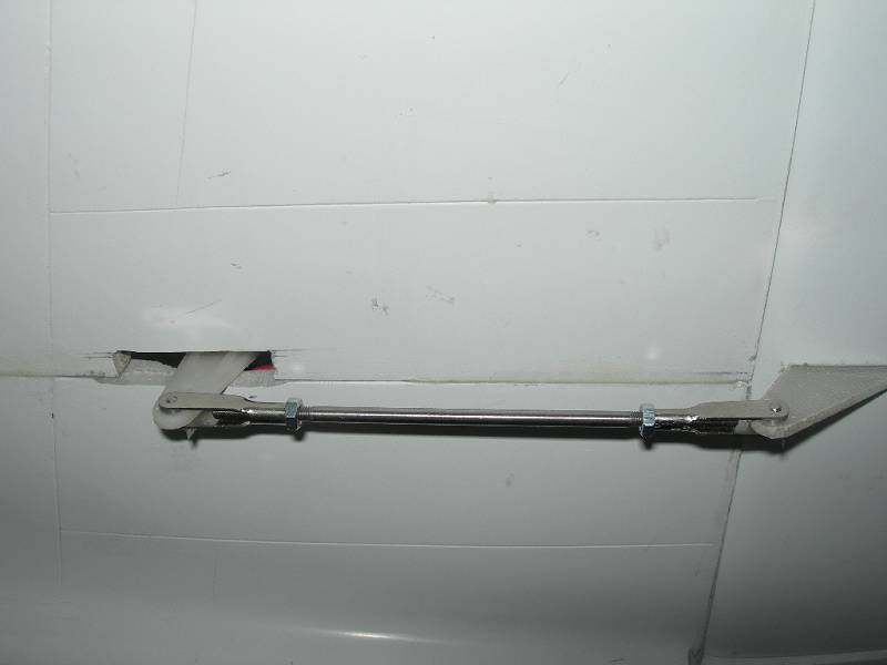

I recieved my FEJ F-16 today. It looks great. One former under the cockpit deck is cracked but no big deal. I have a question. The online instruction manual depicts a precut hatch for the rudder servo. My verticle fin has no cutout on either side. I have tried to follow this thread but i dont remember anyone discussing this. Did they forget to cut my hatch?
Cody
Cody
#842
COdy,
there should be a cutout with a recessed edge on the left side of the fin (looking from behind the plane) where the cover lays against. You can cut your own and use thing ply to support the cover. If you need dimensions where to cut, let me know and I will send you a sketch.
Regards,
Mike
Regards,
Mike

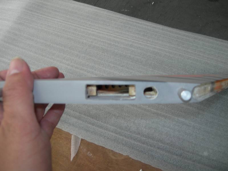

Thank you for the time to make that sketch. I had sent an e-mail to FEJ inquiring about the rudder servo cutout. Turns out, they didnt forget. They replied that they have changed the location of the rudder servo and attached 2 pictures. Maybe someone here understands what to do from the pics, but I do not.
Here are the pics they sent.
Thanks again Mike,
Cody
Thanks again Mike,
Cody
#849
My Feedback: (24)
Cody,
Use a mini-servo that fits into the pocket at the bottom of the fin and cut a notch in the side of the fin, at the bottom, for the servo arm to come out. The notch becomes a slot when the fin is mounted to the sub-fin that is on the fuselage...
Bob
Bob
#850
Hi Cody,
Does yours look like that? if so, I would go with what Bob is saying. Use a servo around 60-70 in-oz torque that would fit. You may have to use mini servo as bob is suggesting, I do not believe it is wide enough for a standard servo. Heck, if you did not like that, then make the mod in my previous posting.
regards,
Mike
