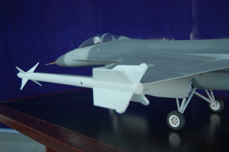

mike
Thanks for the tanks and the missiles they look great. Not got my f16 yet [&o] but is there a way of temporarily fixing the missiles to the rails just in case they get scraped so i can get the spares on. are there any pics of an install to do this ?

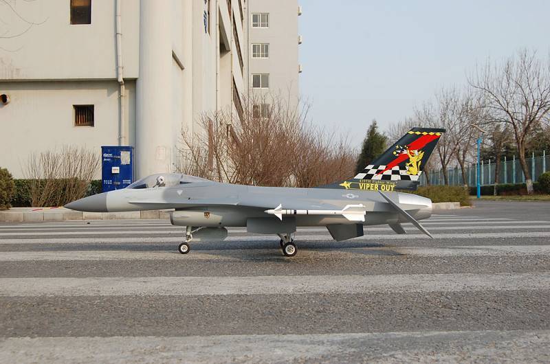

Hi Rob,
Thanks, I just installed a pair of them on my JL F-16 and make them removable. I drilled 2 holes on the missiles and the rail for 2 4-40 screws. added some wood parts in between the rails and the missiles for the blind nuts. I will post more picture later.
Mike

Cheers mike
Have you got a set of the new landing gear on that or am i seeing things does the new gear fit the old kits. As i said have not even got mine from the uk rep yet comes mid april i think which gear will be on it ??

Hi,
I think, you get the normal LG, because the new one is more expensive.
@Mike,
your JL F 16 looks great, I try to fix the missiles (after I got them) with two little strong magnets.
Christian

Hi Christian,
You know I am a bargain hunter. These JL L/G are the improved versions and got them at the same price, but I only got one pair so far. My other F-16s are still leg-less.
Great idea with the magnets. What can I say about German Engineering. Now I know how to fix real rockets on the missiles rails. I will experiment with it and see if I can shoot them off.

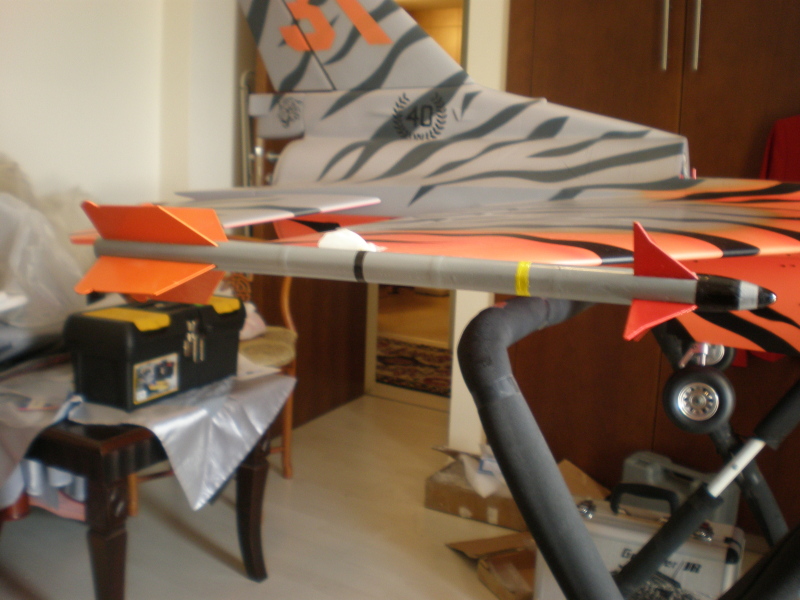

thanks for the missiles and fuel tanks, superb,i have just finished painting the first pair....the other i think i will leave them white...see my pictures...do you like the painting colours??

Hey Lookilook,
How are the missiles attached to the wing?
Ziv
Old 03-29-2008 | 02:09 PM
  #874
lookilook's Avatar
Joined: Jan 2008
Posts: 606
From: NICOSIA, CYPRUS
Default RE: FLy Eagle Jet Models
hi ziv,
they are currently attached to the rail with a very strong double tape that i use on real aircraft ,cause is not ready for flight yet i cannot say for sure that is a good idea,tomorrow i will make an effort to copy a system that i saw in a model show f16 where you make 2 L shape "teeth" on the side of the missile and 2 slots on the rail and these 2 teeth are slotted inside in the direction that the wind will be pushing them against the slots so as to not drop or move.....may be not so clear but when i finish it i will post some pictures
to see...
regards NICOS

Use 4 mm gold connectors that you use on ESC's have the male on the misile and the female in the end of the wing.... They are very tight and wont come off in flight
