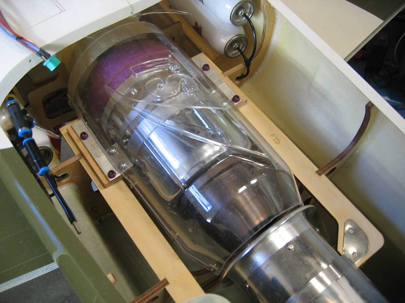

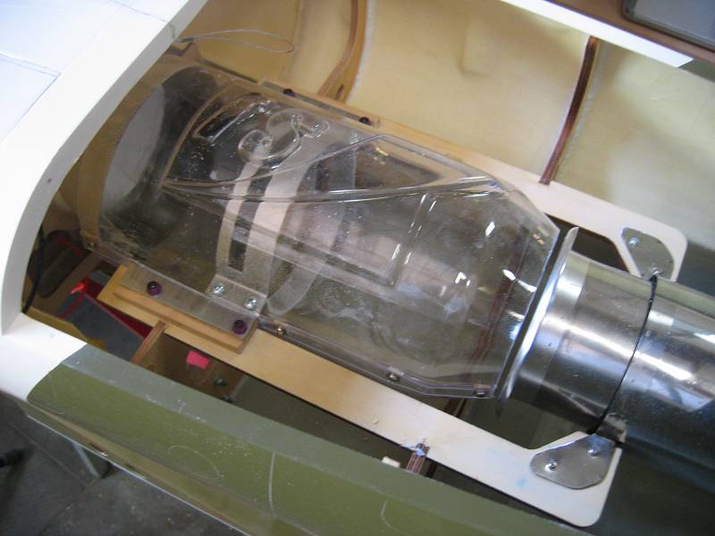

ORIGINAL: KC36330
a wet start isn't as easily seen in a bypass installation
Mine are transparant ! (On the pic below this SpiderJets turbine bypasses are cut off at the rear to fit with the standard bellmouth of the JetLegend L-39...)
No heat issues, even with this JetCat P-160 installed.
I still have some stocks... PM me if interested...
Nicolas.

Old 12-14-2007 | 06:33 AM
MaJ. Woody's Avatar
My Feedback: (28)
Joined: Apr 2003
Posts: 5,172
Received 14 Likes on 12 Posts
From: Rochester, NY
Default RE: Turbine bypass
Transparent is NICE!!
Dom
