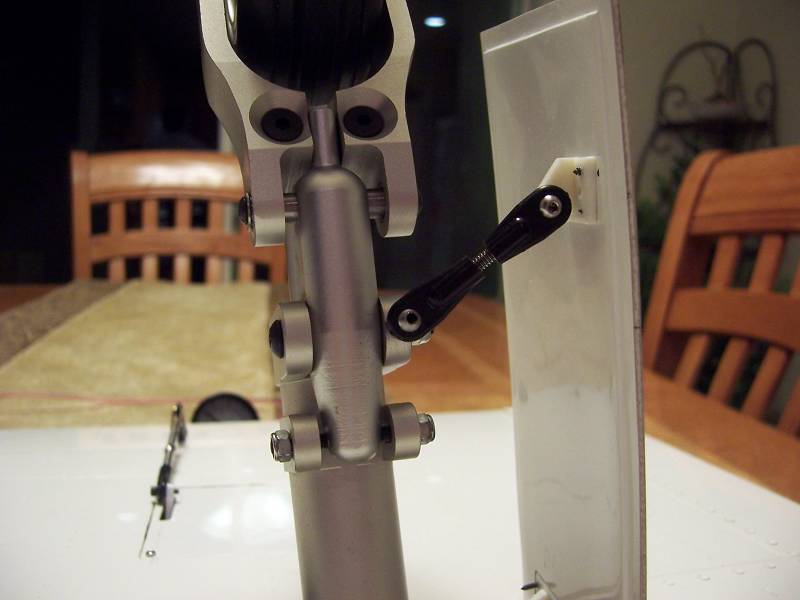

OK, the build continues...

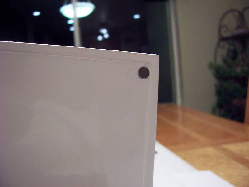

The work on the landing gear doors continues...Many thanks to the guys who offered help on hinging them.
The main door is where I started. I have never hinged a door before so it was all a learning process. I now have the doors on the left wing about 80% done. I still need to do a final fitting and set up all the gap seals and whatnot. I employed some "that looks about right" engineering when it came to the ram and link installations. See pictures....

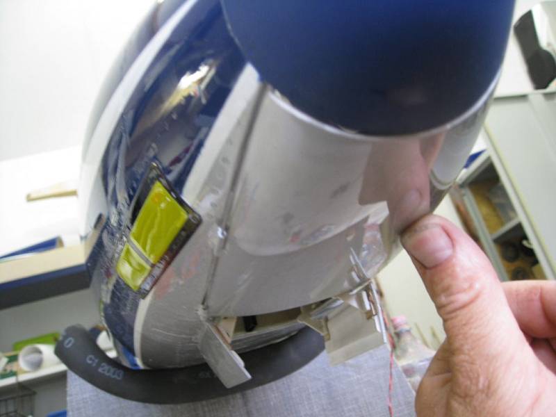

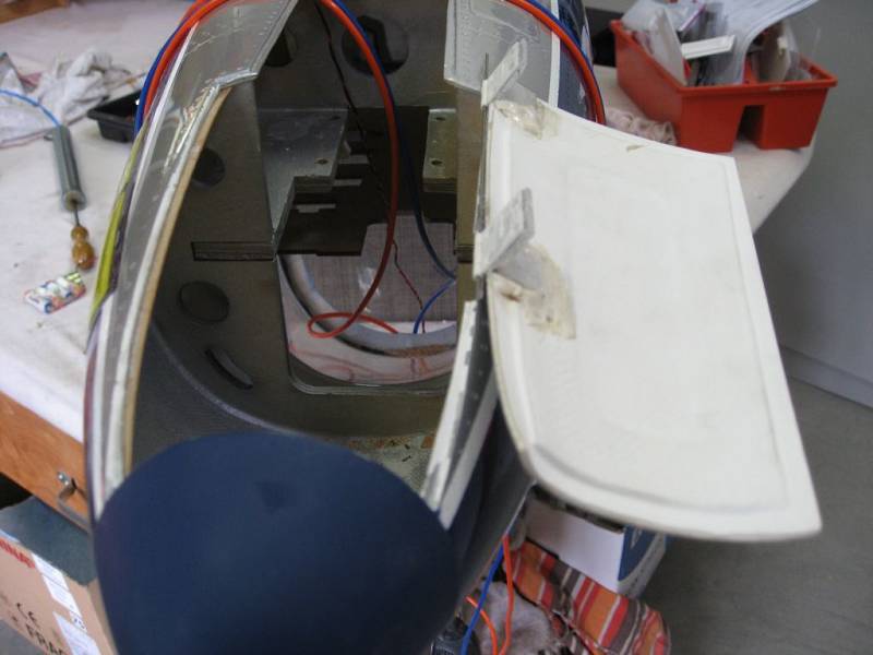

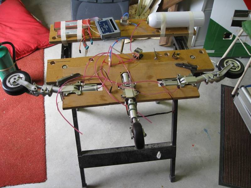

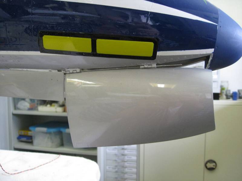

As this thread has been silent for a while, I am picking up the story, as I have received my MB (ready painted in Frecce Tricolori colours) some time ago and now busy working on it.
A few things:
The idea stolen from my friend Leo (who also builds one) I made a temporary stand to accomodate all the gear components and test it. Good idea, as I found out that some Skymaster door cylinders were leaking. (new ones will be sent, good service).
The gear itself proved flawless, not only it looks sturdy and made to a high standard, but it works just perfect. Almost comic to see that gear flap upright on the bench!
The same time I could delve in the software of the Weatronic and adjust it to suit, make the Jettronics (from Sandor) work as they should.
The nosegear main door proved a headache to get it hinged right. First started with the offset hinges, but that did not work due to the double curvature of the door.
Then I looked again at the 1/1 MB pics, and noticed very faintly it has outward hinges.
So I copied that using normal Robart flat hinges.
First I glued some aluminium brackets to the door. Take care to align the vertical panes to be in line.
I removed the hinge pins and replaced it with a long 1mm wire that runs through both of them, to get both hinges working in the same hinge line, very important.
Then I tack glued one side to the alu brackets, taking care the piano wire touches the door just in the middle, any further out mounting of the hinges is not necessary.
Removed some material from the fuse side and made plywood blocks to receive the other side of the hinge. Here too, careful alignment is important
Then tack glued the othe side to the blocks.
The end result is, the door fits like a glove and is easily rotated to more than 180 degrees! You cannot get even close with offset hinges...
Now I need to touch op some parts, and tip paint the hinges, install a bracket to attach the actuator rod. I might cut back the alu brackets a bit if they stick too far inside, hampering the gear.
The long wire will be replaced with shorter hinge pins, but will definitely make them removable to be able to remove the door.

The gearspeed itself is already softened by a Festo restrictor on the outlet of the Jettronics valve, I see I need another one on the doors as well!
Systems consists of 2 X jettronics 2 way valves, sequencing by Weatronic.
The large front door is part of the door system, however the small doors get pressure from the gear DOWN air for opening, and for doors close gear UP air. However, pressure is blocked until the nose gear touches a mechanical pressure switch that then sends pressure to the small doors.
Took a while to get it all figured out........
BTW, I have uploaded a vid from the nose gear sequence at http://www.youtube.com/watch?v=uPJlFQvf04Q

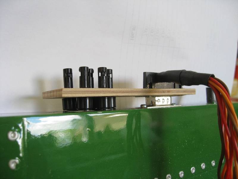

#46
I could work last week quite a bit on my MB, tackeld the wing/fuse connections. Without any previous experience working with quick air disconnects, the result was not bad.
In stead of having separate "blocks" for both air and electrics like in the beginning of this thread, I used ONE former to mount both units upon, hopefully this gives more resistance against movement of fuse and wing parts when air pressure is on.
For electric connections I used the Sub-D that is a 90 degree version, so inside the fuse it nicely looks downward in order for the leads to be routed under the tanks.
