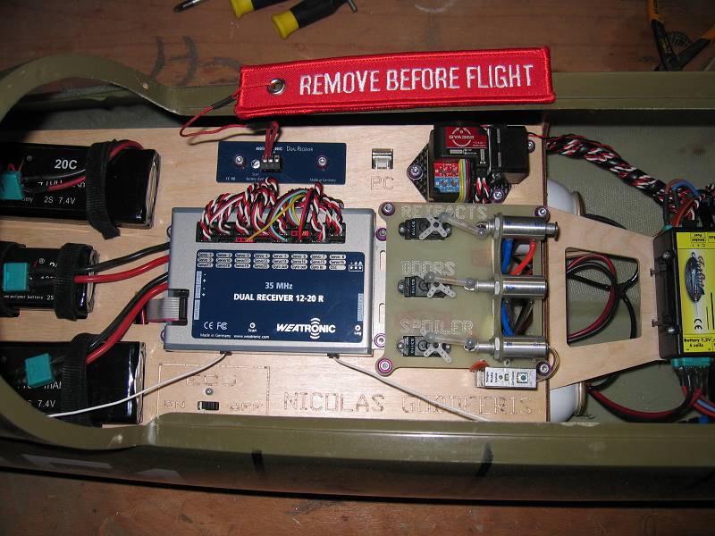

Jean-Pierre,
Merci. Voici le lien suivant : http://www.rcuniverse.com/forum/m_63...tm.htm#6553592
More than 20 pilots have received a set of my trays so far, looks like many will be using the Weatronic for the first time. Great equipment.
Groeten vanuit Seoul, Korea.
Nicolas.
Nicolas.
