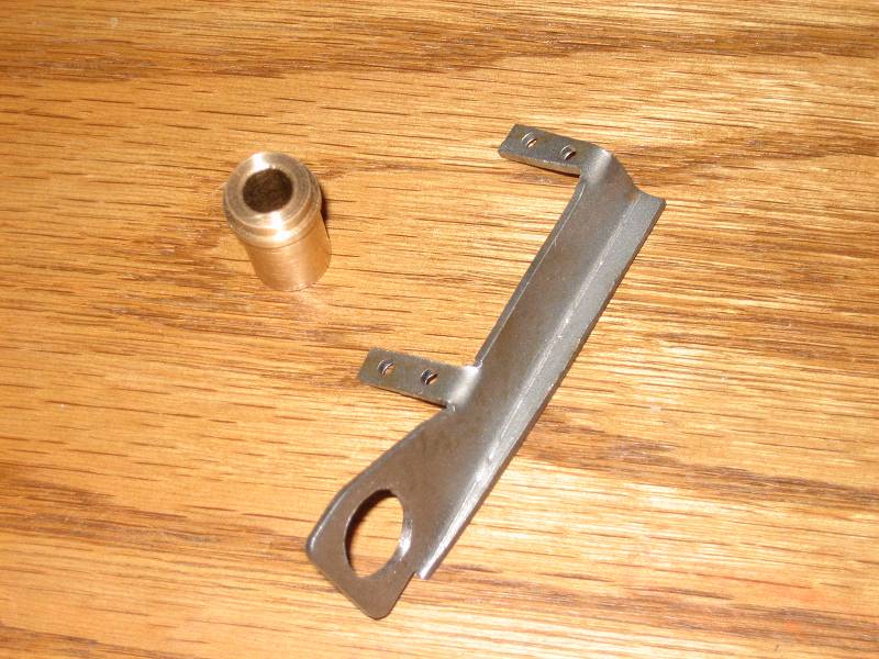

Thud_Driver,

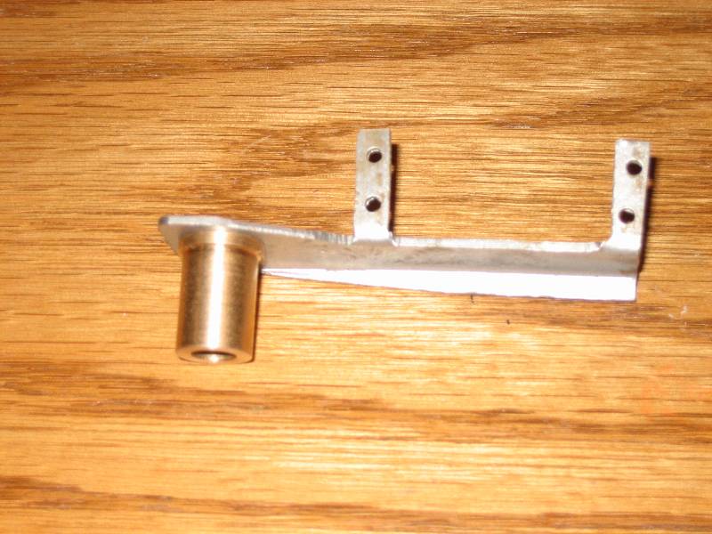

Here is the servo mount for my JL T-45, it is made from 1 mm (.040" ) sheet metal.
I used a bronze bushing .5" O.D. and .25" I.D. then silver soldered the sheet metal bracket to the bushing.
If you want the AutoCAD drawing send me a PM with your e-Mail address.

Thanks for the offer on the CAD drawing but your picture is clear enough.

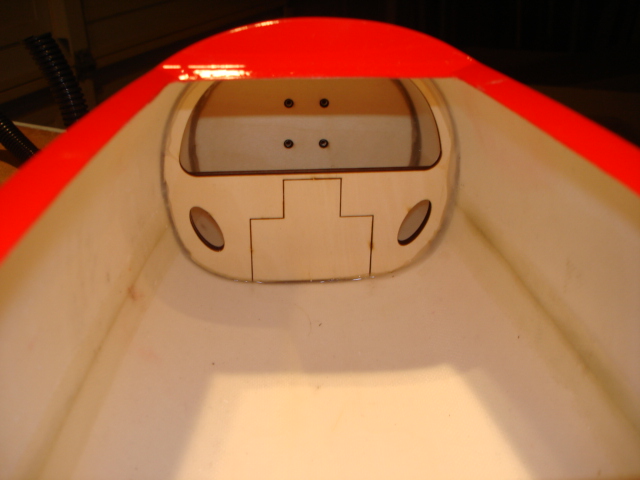

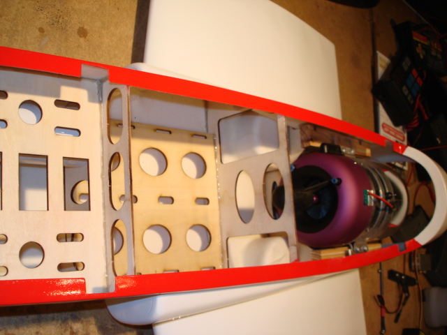

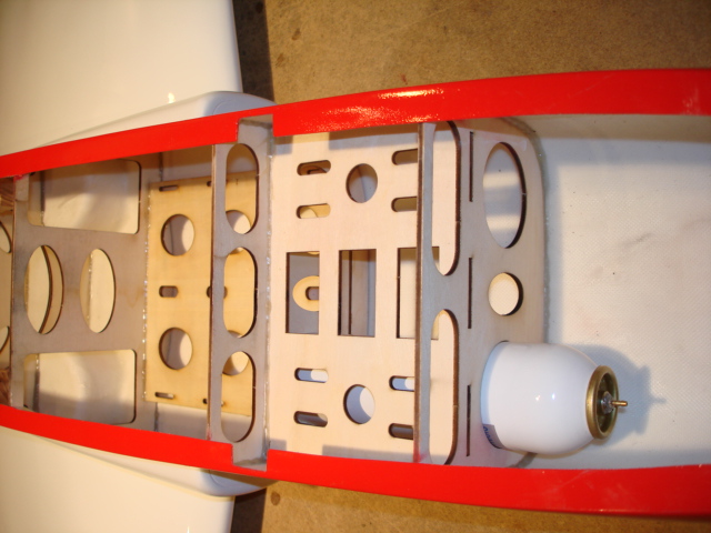

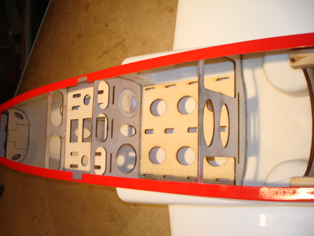

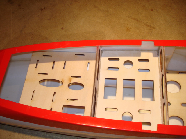

Interior fuselage pics:

Fuel bay is 7 5/16" long or 186mm, just short of 4 1/4" tall + whatever fits into the turtledeck and maybe 6" wide with some trimming of the flanges.
Rest of airplane is pretty much what you see in the published pictures.

Hello thud driver
Nose gear opening needs cut out?
Bottom pic of fuse?
How do the main gear bulkheads look?
Thanks, Neal
Old 02-23-2008 | 06:10 PM
  #35
Thud_Driver's Avatar
Posts: 1,669
Received 9 Likes on 7 Posts
From: Victorville, CA,
Default RE: Nitro Models Formost 150 are in the USA
Yes, I have to cut out the nose gear opening and install the nose gear mounting blocks.
You can't see the main gear bulkheads without cutting open the airplane. I'm not, someone else can.

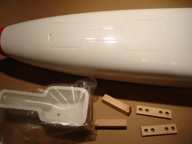

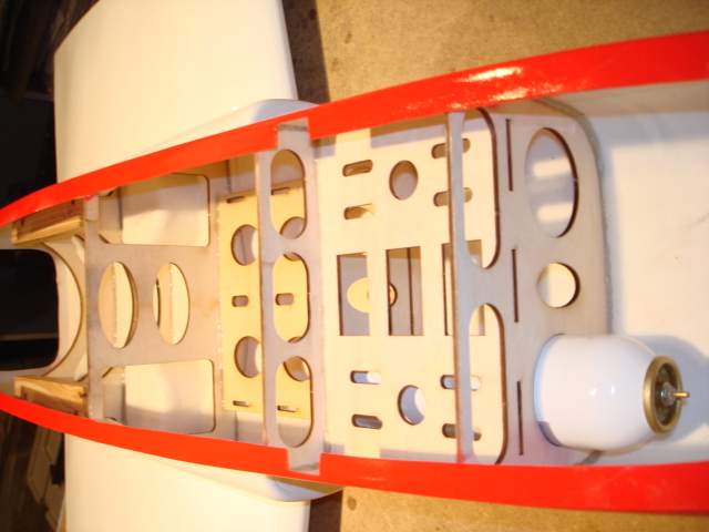

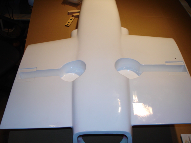

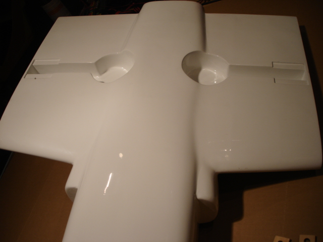

Bottom pics. The main gear mounts will accept Robart 630's, a perfect fit except there's no place for the side air line to go unless you cut a hold in aft face of the wheel well liner.
I don't know if those pieces with the holes in them are for the nose gear or no.

Do you plan on making the modification to run the wing tube through the fuselage that Spider Jets shows here [link]http://www.rcuniverse.com/forum/m_7016824/mpage_4/key_/tm.htm#7085190[/link], or do you think your modified "New" version of the Formost 150/160 is sufficient as it is?
-Jorden

If you can find a sufficiently long 16mm tube of the right thickness in the US for decent price, I will. I found a CF tube but the price is obscene. The Rookie/Roo spar isn't long enough. BTW, in my experience, the Rookie/Roo spar isn't strong enough either. I've bent three, including two with the dowel inside. The Formost tubes are way thinner than the Roo/Rookie tubes.
Right now I'm thinking of doubling the tube with a full length 1/2" wood dowel or aluminun tube but it would have to be glued into the stub tubes because of the loose fit.
