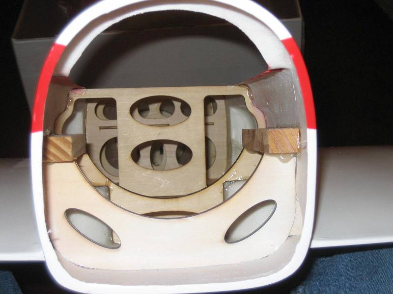

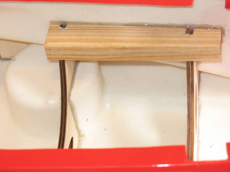

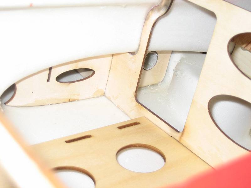

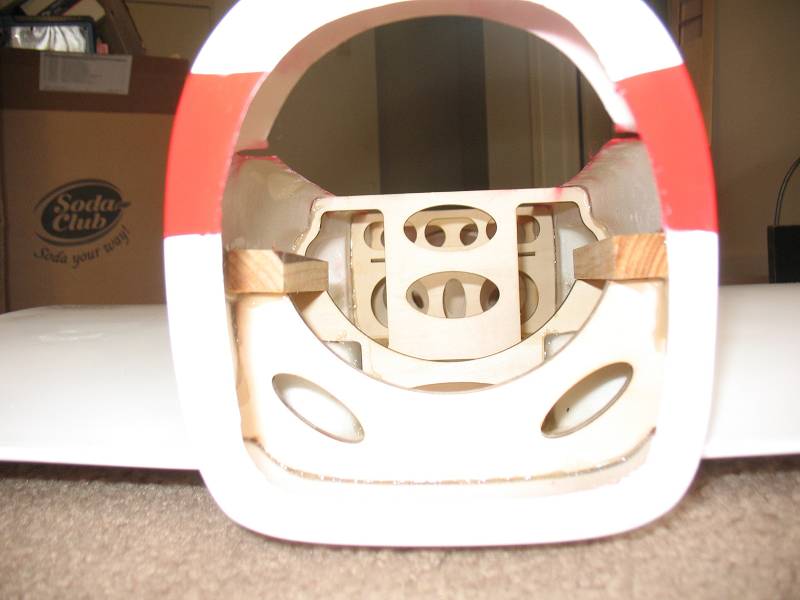

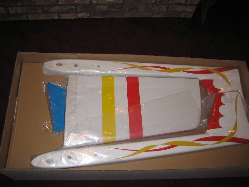

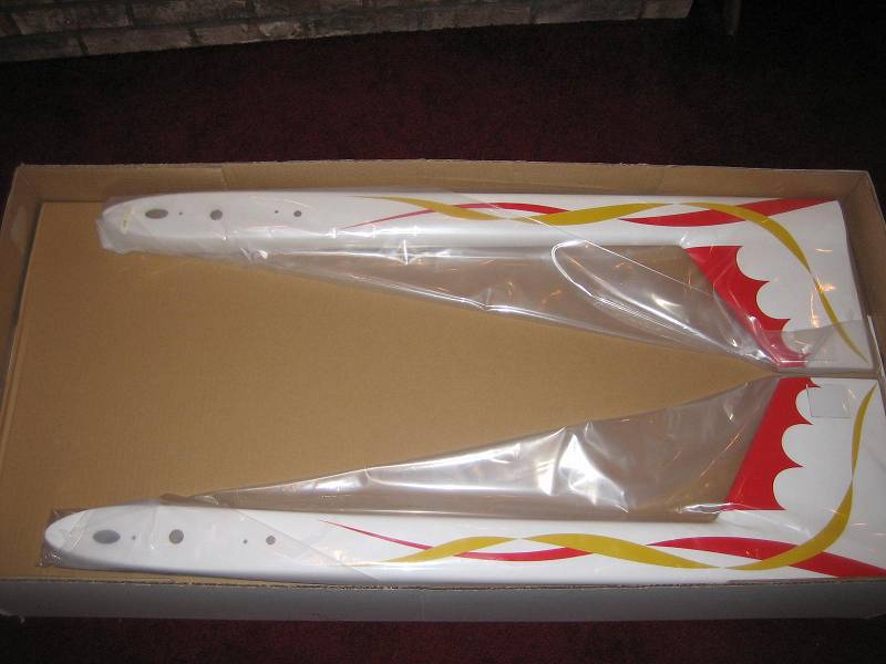

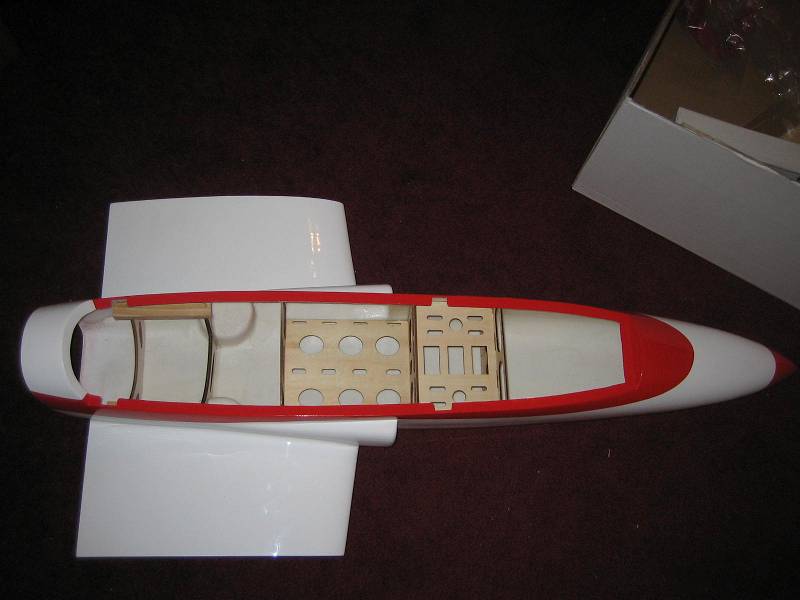

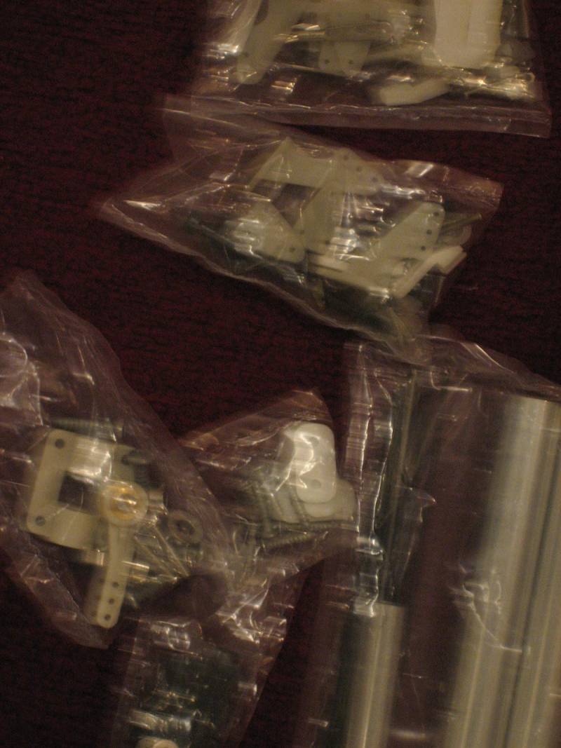

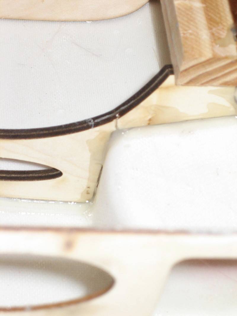

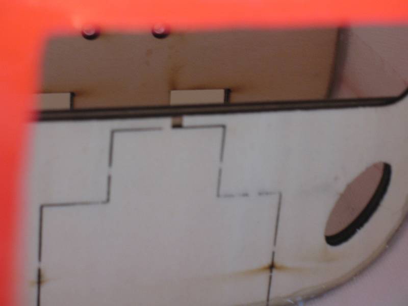

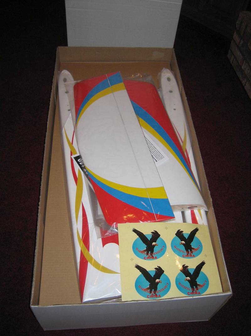

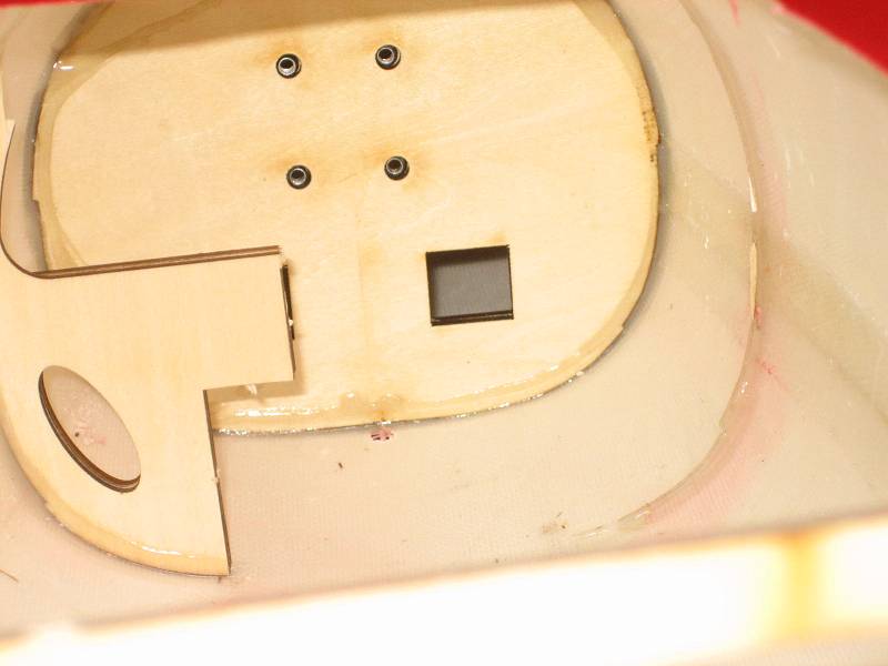

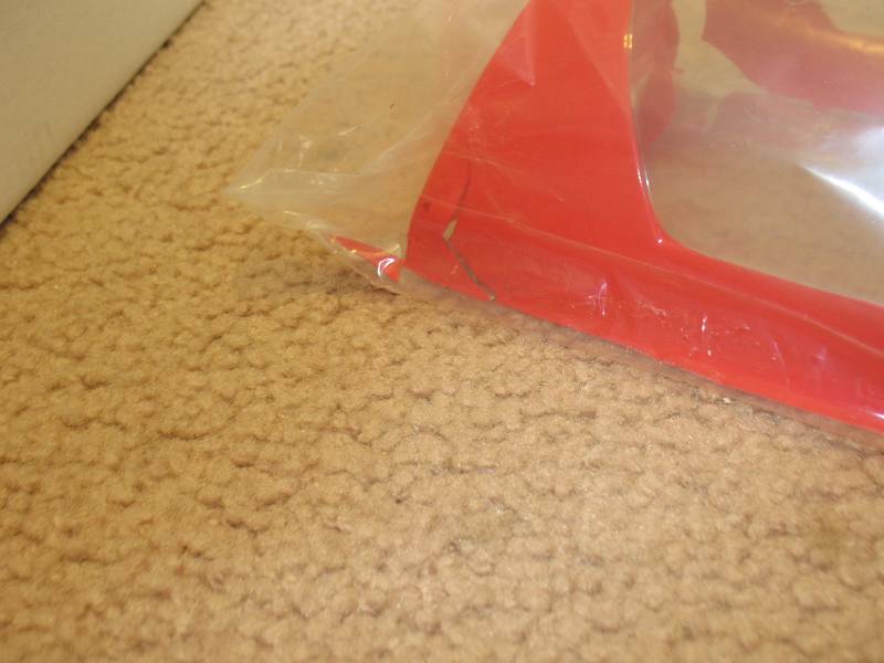

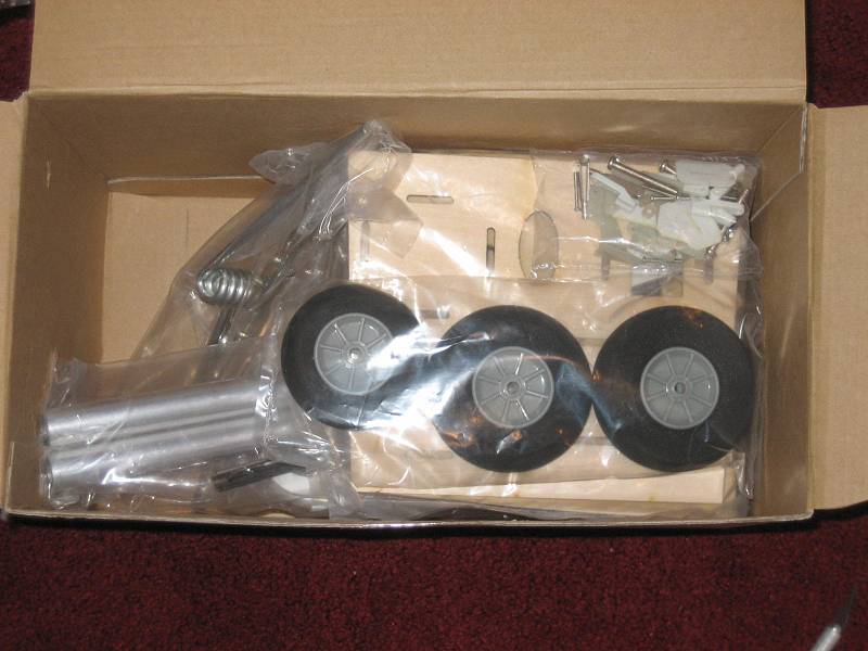

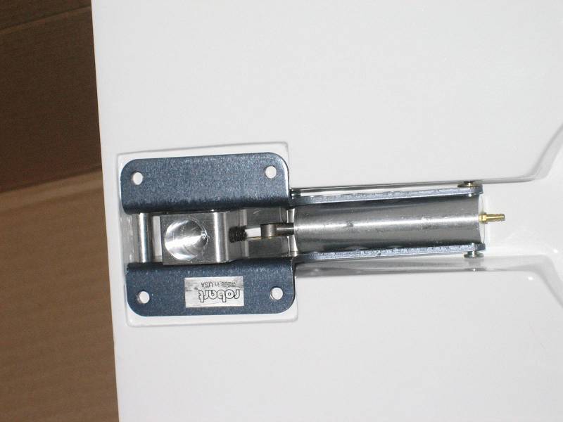

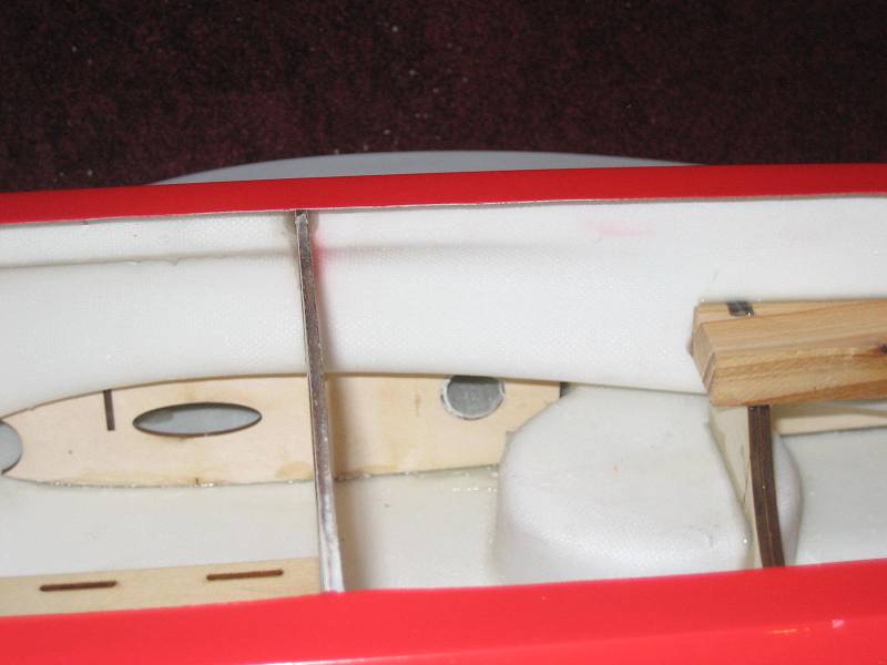

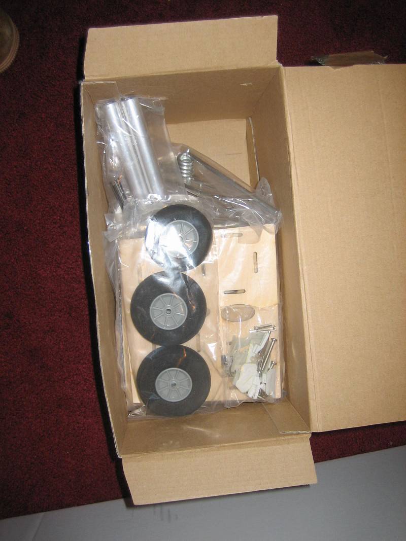

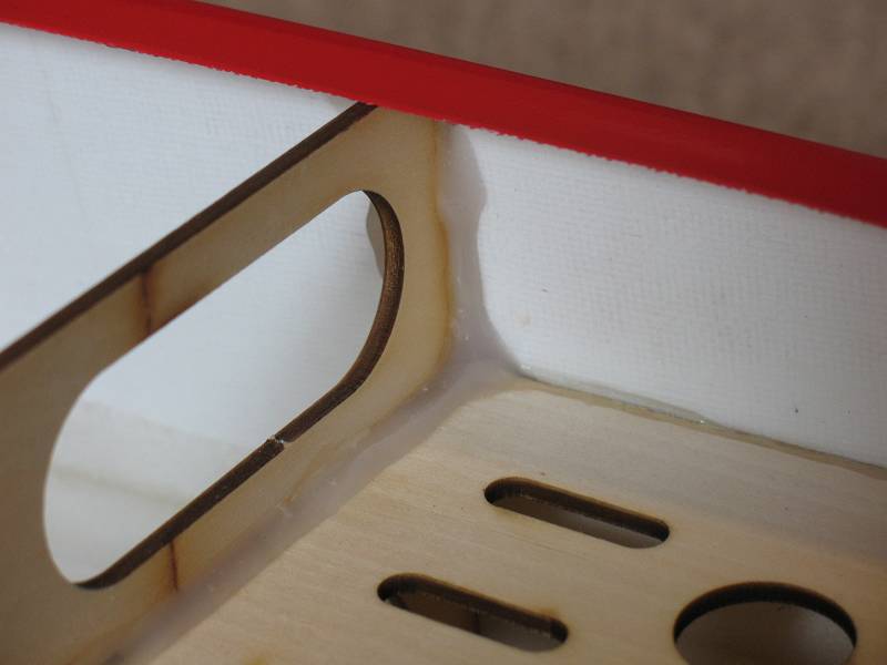

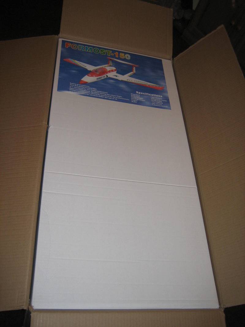

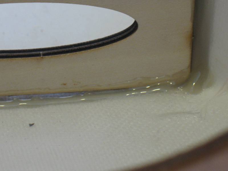

Received the kit (notice I didn't say ARF)
The packaging was good except the instruction manual and the decals were stuck to the lid of the box.
I'm afraid the changes that Nitro Models touted are not worth much, the front bulkheads are made from two 3mm Chinese Ply wood.
Know as Cheep Raggedy Ass Plywood also know as (CRAP).
Sandor,
You are able to break the bulkheads out with little force you have mentioned in your thread.
I have a bunch of photos however I will have to post tomorrow as I am out of time.
The overall quality is very good except for the CRAP so for the money it is an excellent buy and will make a great building project.
The fiberglass work and paint is as good as any other manufacturer coming out of China.
Thats all for now
Old 02-28-2008 | 06:20 AM
  #62
RCISFUN's Avatar
My Feedback: (44)
Posts: 6,930
Received 34 Likes on 30 Posts
From: Erie, PA
Default RE: Nitro Models Formost 150 are in the USA

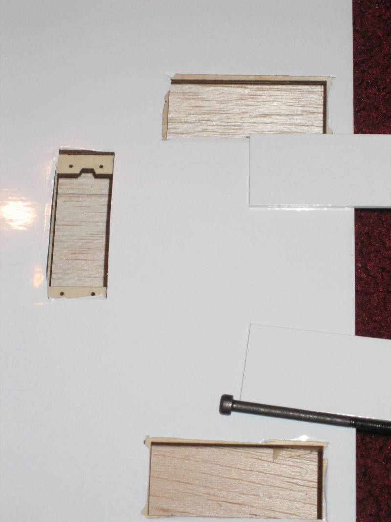

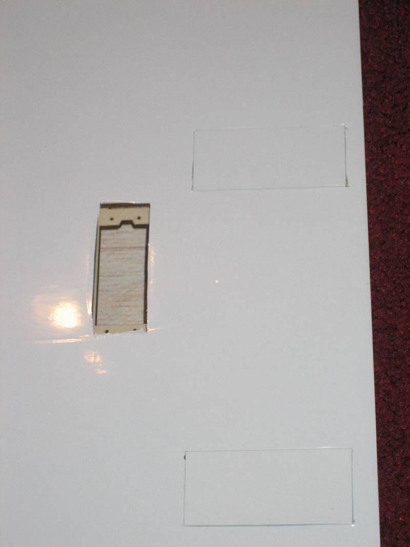

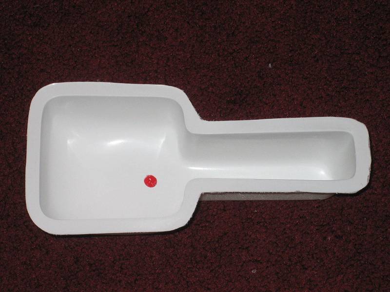

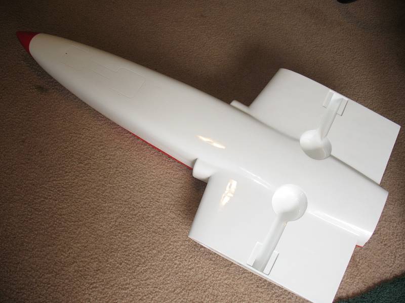

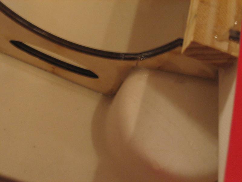

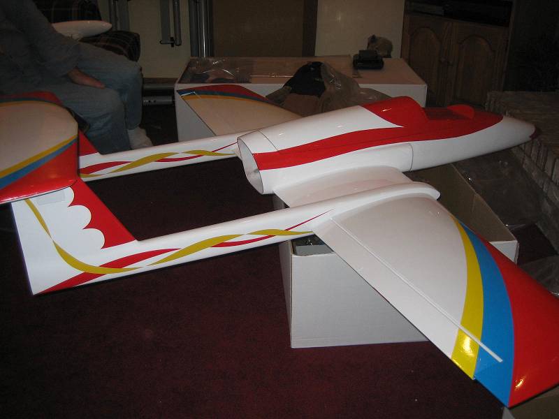

Nitro Models Formost 150 Build and Turbine Mod review
Horizontal Stab 192 Grams (Built Up Construction, Ribs, fully sheeted, Iron on covering, I would install the elevator servo in the center, the stab is a flat bottom airfoil and is on the thin side .75” (19mm), a servo blister would be required for an appropriately sized servo for the task.
Wing Panel 262 Grams each (Built Up Construction, Ribs, fully sheeted, Iron on covering (great quality)
Main Spar Receptacle – Fiberglass Tube, .637 ID (16mm) Insertion depth 6.12” (155mm)
Anti Rotation Receptacle - Fiberglass Tube, .405 ID (10mm) Insertion depth 2.87” (73mm)
Main Spar Tube – Unknown grade of Aluminum Length 12.56” (320mm), OD .630 (16mm), wall thickness .04 (1mm)
Anti Rotation Tube – Unknown grade of Aluminum Length 6.81” (173mm), OD .395 (10mm), wall thickness .04” (1mm)
This will need a continuous main spar tube, see notes under fuselage below.
There are no flaps, however it would be quite simple to split the ailerons into two sections to create flaps, the outer section could be made into a 10” (254mm) length leaving approximately 12.75 (324mm) inch for the flap section. The width of the section is 2.25” (57mm)
The provided holes for the ailerons servos would now become the flap servo locations and two new holes could be cut in for the aileron servos. The ribs have cutout which will allow the servo leads to be routed to the new locations.
The wings are held on with two long Allan head cap screws, there are access hatches on the bottom of the wing panels in which the bolts are inserted, they are routed through the booms and mate with a blind nut located in the center section of the fuselage. Access panel covers are supplied and fit quite well.
Rudder 10grams ea. (Built Up Construction, Ribs, fully sheeted, Iron on covering

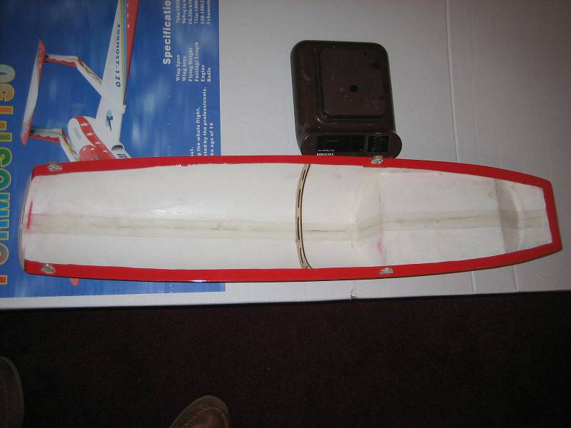

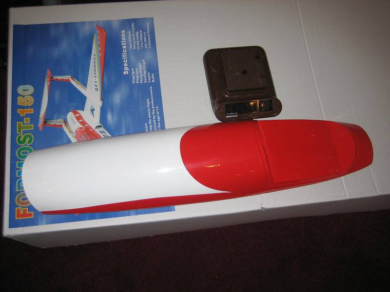

Booms – 390 Grams ea. Fiberglass construction, Front of boom has plywood reinforcement on each side from the LE back approximately 14” (355mm), thickness at this section .12” (3mm). Boom seams have been taken out; paint looks good, vinyl graphics with overall clear coat. The vertical fins do flex as there is no internal structure to them, I believe the easiest method to strengthen has been explained by SpiderJets in his form; i.e. use the two part expandable foam.
Front Hatch 190 Grams fiberglass construction, painted with clear coat, glass thickness .03” (.7mm)
Canopy 60 Grams, I don’t like the shape.
Fuselage Fiberglass construction, don’t have the weight as it was beyond my scales capacity.
All seems have been filled and finished, paint work is great, overall clear coat, no decals have been applied (thank goodness).
Plywood formers will most likely work as is with the exception of the landing gear areas.
This aircraft requires a continuous spar, with the design as supplied you can flex the entire structure; this is not safe for turbine operation.
As received the wing spar tubes will insert into the center section for 6.3” (160mm) where a stop is placed. The plywood stop is glued in with the special removable glue, one tap with a mallet on the spar tube inserted into the center section and the ply plate falls out.
The next interference is with the molded in wheel well, this will have to be cut to allow clearance for a continuous CF spar tube, the tube will need to be .63” (.625 seems to be the standard in the US, so a clear coat would need to be applied to make up the difference) (16mm) OD x at least 36” (915mm) Long
All formers associated with LG should be removed and made from aircraft grade plywood and or hard wood or reinforced with CF. The glue joints are made with some sort of brittle glue (CA???) and formers can be removed with a sharp blow to them.
Fuels Tank area is 7” (178mm) LG x 4.37 (111mm) Deep x 5.5” (140mm) wide
If you want a different configuration remove bulkheads and make your own. Regardless of what is used, you should re glue all joint with the appropriate epoxy.
The nose wheel well opening has not been cut out so you are free to configure this area as you see fit. The cutout lines are present however you could choose to create a different shape. I plan on making new bulkheads and installing the servo directly on the strut eliminating cables and other sliding linkages set-ups.

Some photos:

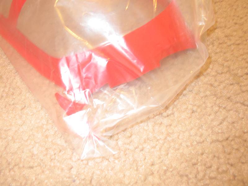

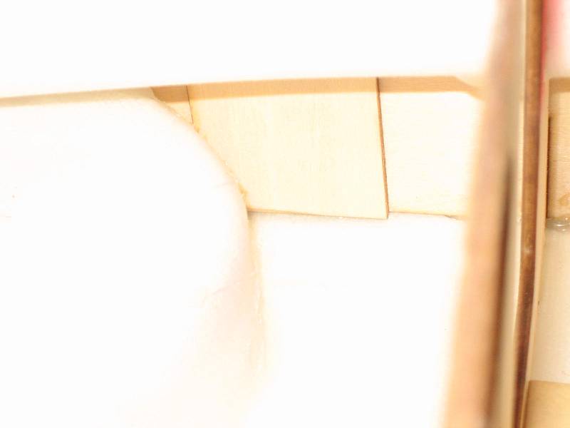

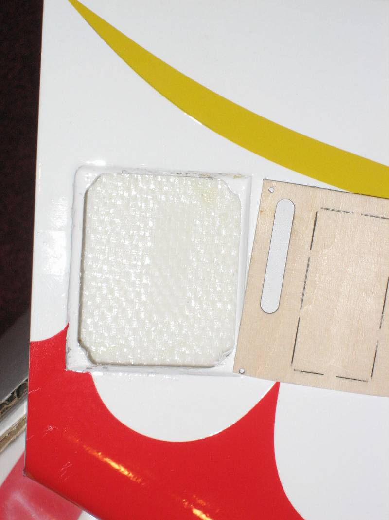

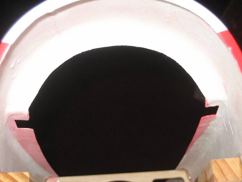

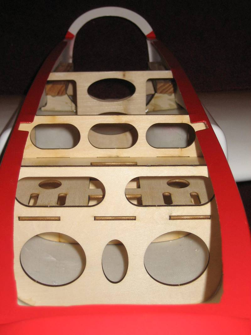

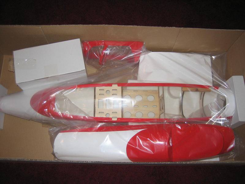

More Photos

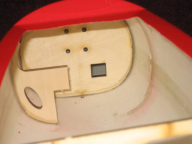

Photo 5 & 6 shows the front formers broken out after a slight twist force was applied as Sandor suggested.
Photo 7 shows the spar stop plate removed.

More photos
Photo #1 & 4- looks like Godzilla installed this former, heck if it doesn't fit force it[X(]

Well, received my Formost 150 today. With the exception of a trashed canopy, all looks good. I haven't looked through the instructions yet, but I'm remiss to see how this thing is being marketed for piston engines. It definitely comes with the cradles for a turbine, or even a ducted fan. Nonetheless, it looks like a very nicely made plane. Someone must have been listening about the glue, because mine has the bulkheads/formers very well glued into place. Interestingly enough, the glue looks for all the world like glue from a hot glue gun. The former next to the one that holds the nose gear is doubled along the bottom half. All in all, even with the work that will be needed, I still think it was a good buy. Heck, I may even get a second one and make it a gasser for practice. Better yet, make this one a gasser and convert it once the fixes have all been worked out. Oh and yup, the tail booms do need to be strengthened for turbine flight. I wonder if the should be done for gasser flight too. It's going to be quite a while before I'm able to get this thing into the air as a turbine any way.
-Jorden
Edit: Actually, the canopy is very thin along the edges. I don't see how it's going to stand up to any real usage. Probably a good idea to look for a better one somewhere, or make one. I just sent Nitro Planes a request for a replacement. We'll see how that goes.

Few more pics
