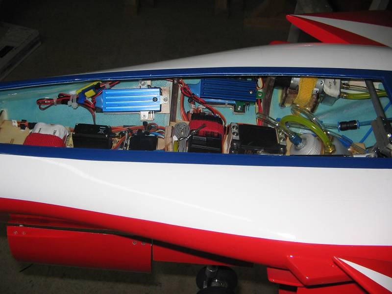

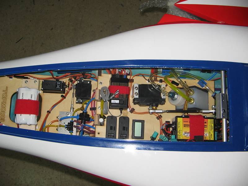

Thanks again for all your valuable inputs which are very much appreciated.
I liked the idea of the "stetoscope". I will give it a try and see or should i say "listen" for a whistle!!!
Meantime here are a few more photos of my installation. Planing to install base loaded whip antenna inside nose cone (see below)
Regards to all.
Dany

Nice instalation picturers, I have the same aeroplane but in camo colours, I will use an P80 in my Rafal, have you linked the canard to the elevons? Or do you use a separate switch for the canard?
My instalation i an early stage.
I have used a rather expensive retract and that did not mean that it was leak free, I had to take apart 2 out of 3 retracts and change O-rings due to air leaks.
K-Ã…

I also have another Feibao Rafale new in the box, the camo version.
Frankly speaking, although they look nice, I didn't like much the FB retracts that came with the kit as they have some play in open/locked position which I hope will not be a problem on not so soft landings.
I noticed that you have ferrites on your servo cables although you are using a power box?? Is this necessary?
As for the canards, i haven't yet done the mix but intend to have both continuous mixing with elevators and an offset position for take off and landing activated by a 3 position switch.
I have a Futaba 9Z radio and have not yet tried thesettings but in a previous thread i have received some intersting advice to dial some delay in travel play which apparenly will make the Rafale fly realistic.
Can't wait to put the final touch and fly this beauty!!!
Regards.
Dany

Hi Dany, the ferrit rings was put there by Powerbox so I just let them stay where they are.
I have used som hevy duty retracts on mine as I am going to fly it mainly from our grass field which is currently covered in 50cm of snow and will be so for the next months.
I hope I can fly it from our field in May if we have a good spring.
Our season is quite short between may and oktober, but on the otherhand we have enough light for flying around the clock in may and june.
By the way Dany have you figured out where to put the 2 plywood blocks that is supplied in the kit and has the text jetcat on them??
I have tried to fit them but they don´t seem to fit anywhere!
BRG K-Ã…
