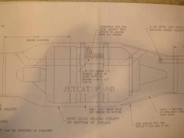

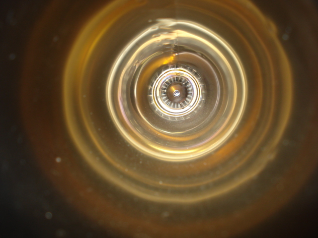

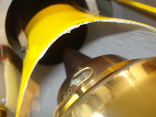

hey guys...just finished my bandit arf and the second start i had with it the bypass seams to be getting hot. the heat sheald that you paint on inside the bypass is starting to bubble. the turbine is sitting where the plans show it to be and is centeard in the bypass.
the gsu reads 620 to 670 so its not getting real hot i wouldnt think. and its always started in the wind. what could be the pronlem?
thanks...mike

Gap from turbine to the pipe looks awfully long to me.

The pipe needs to come in the bypass to about .5-.75 inches max from the nozzle of the turbine.

hi guys thanks for the reply, the pipe fits over the by-pass not in it. thats what the bvm plans show. should i just slide the engine back in the mounts?

Try that, but it looks like you do not have enough to do it. A P120 has a longer nozzle. are you using a BVM bypass?
Old 03-25-2008 | 11:37 AM
Posts: 2,341
From: Longwood , FL
Default RE: bandit arf by-pass????
Mike,

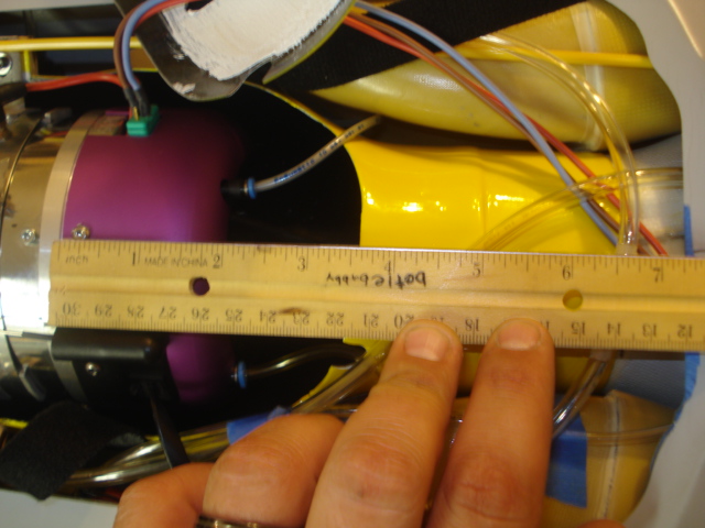

As I interpret your photos, the drawing shows 5.25 inches from the bypass tube/inlet extension to the engine can forward edge....your ruler shows 5". Therefore, it looks to be 1/4" too far forward.
Slide the engine aft .25 inches (1/4") to attain the 5.25" dimension.
Also, did you apply three coats of Heat Shield, as the plans indicate? If not, I would recommend the addition of Heat Shield to reach the three coat thickness.
Harley Condra
BVM REP

hey guys...the by-pass does have the 4 brushed coats of heat shield. the turbine is set at 5 1/4 as per plans the photo just sucks. and yes it is all bvm...the by-pass the pipe.

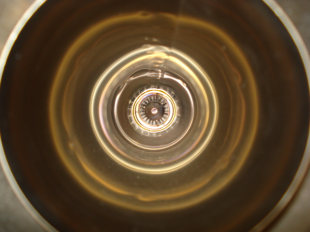

Try raising the back end of the engine exhaust nozzle about 3/16". Your "up the pipe photo" makes it look like the nozzle is pointing slightly down. Is that from parallax also, or am I going blind?
With the lens centered in the pipe, the engine should look centered...it doesn't. The nozzle looks like it is pointing down.
Just checking one more time might be just what you need to solve the problem.

hey again...i thought the same thing with the photo but the heat is bubbleing to top of the bypass. i tried to adjust down and i still get the same issue. 2500 miles away is still good healp.

I would venture to guess that the problem is most likely that the turbine is too far forward in the bypass.
This is allowing the column of exhaust gas to expand before it reaches the tailpipe.
I would suggest moving the turbine back in the mounts about 1/4" and see if it improves.

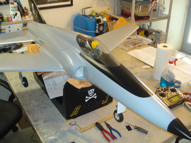

harley....any better? and the bandit.

Looks closer in that photo.
Nice looking Bandit. You will love how it flies!

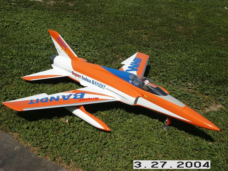

Here's a photo of my Super Balsa Bandit .......It now has composite wings.

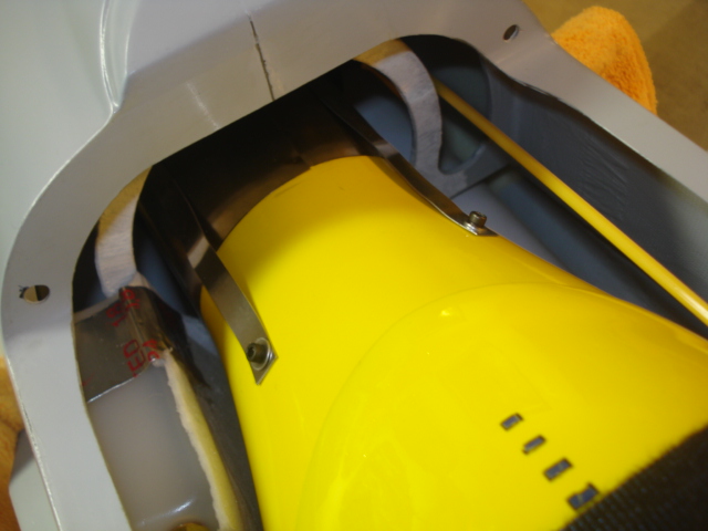

hey harley....i think i found the problem, the straps that mount the engine even after tightening the crapout of them the engine with a littel force does move up and down buy with force. maybe the engine tilts up or down when i get on the throttel maybe????

Are the clamps completely closed ? If so, did you use the black metal 'spacer' that BV includes in the mounting kit ?
Sometimes you will find that the clamps are long enough that they close completely without being tight enough. By using the black spacer material you effectively increase the distance that the clamps have to cover, thereby allowing for a bit more tightening.

If you have a loose engine, it can and will move around. Each landing would reposition the engine.
Gordon has broken the code.....On certain mount straps, the shim is required under them to make them tighten sufficiently.
If no shim material is included with your engine mount straps, just slip a thin metal shim between the strap and the engine can to make the straps effectively longer. The local hobby shop that carries K&S metal will have some thin brass or stainless steel shim that will do the job.
Don't overtighten them....it is possible to deform the engine case.

hey guys,
i think the black strap you speak of is actually supposed to be formed into a small "tophat" shape that the "brim" gets placed under the 2 straps and the "hat" portion between the straps and projects downward to touch the bypass bottom. this keeps the engine centered especially when there is a hard landing.
picture engine held on the sides by the 2 tabs, and being held up by the tophat which is between the lower turbine body and the bottom of the bypass.
