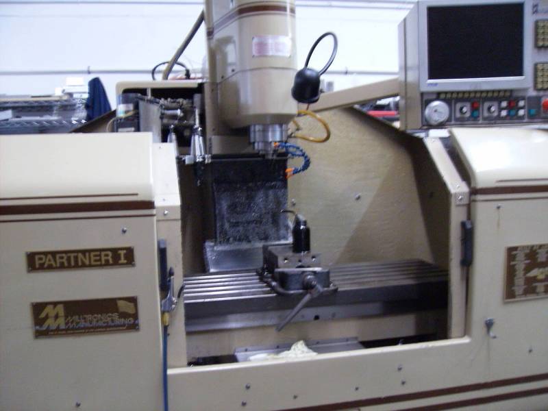

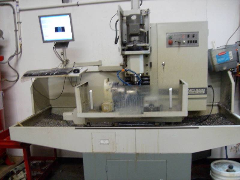

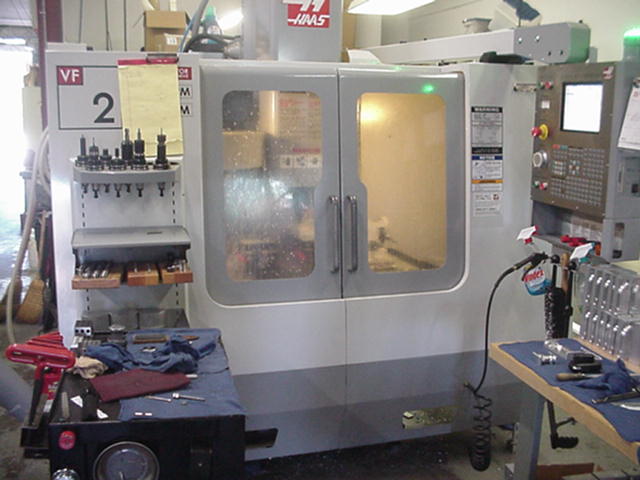

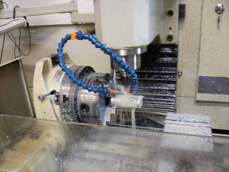

When you are sitting here making retracts from scratch, why not throw something else in?
ID:	925416   Click image for larger version
ID:	925417   Click image for larger version
ID:	925418   Click image for larger version

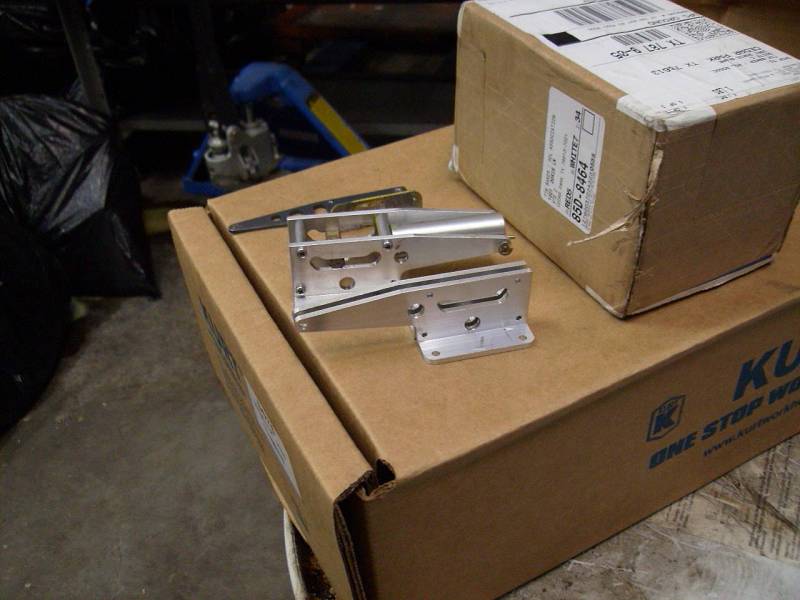

Add another to the mix.

Right now I'm working on making a drop in replacement for Robart 630 and 635 retracts. I've spent basically two full days on it. The retracts I'm building are substantially robust.
I don't know if I would be willing to sell a set, send me an email to [email protected] and what you would be willing to pay.
If the sizes need to be customized, either send me one to get measurements or draw it up.
