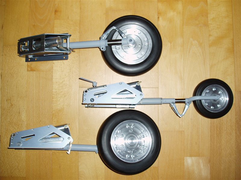

Stig have you considered using the large Dubro wheels instead of the heavier jet wheels, and are you using brakes?
Old 05-26-2008 | 12:36 PM
Stig Andersen's Avatar
Joined: Feb 2003
Posts: 1,277
From: Nordborg, DENMARK
Default RE: A-10 flaps really necessary?
ORIGINAL: I_Fly_Coolers
I have a set of wheels that are also used on the Skygate Hawk. They are really light weight. They have brakes as well.
