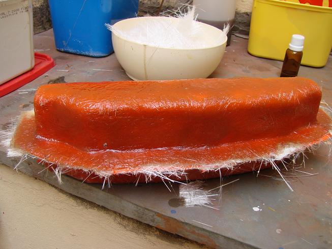

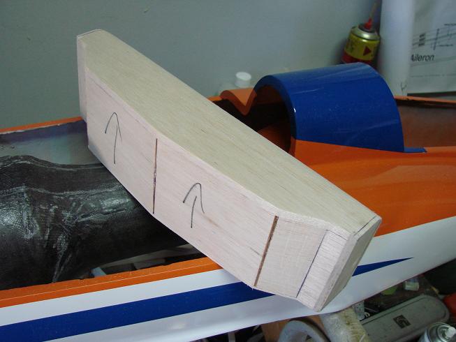

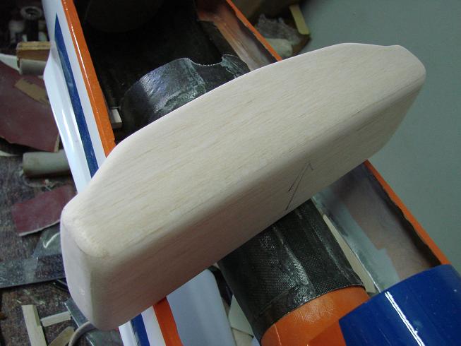

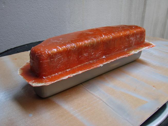

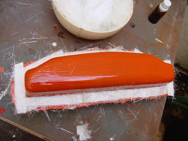

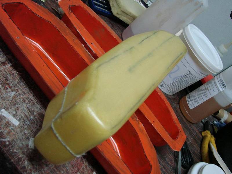

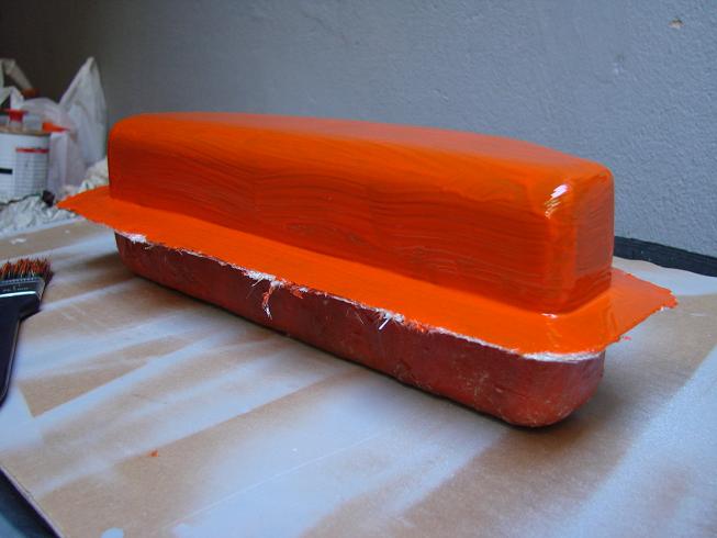

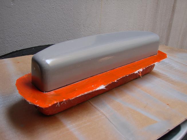

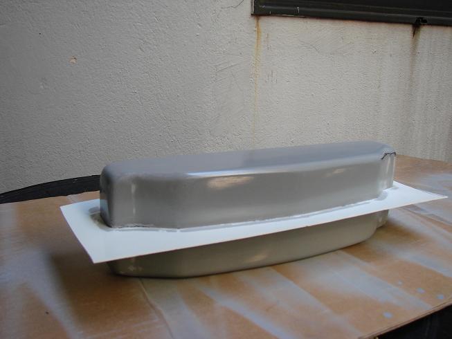

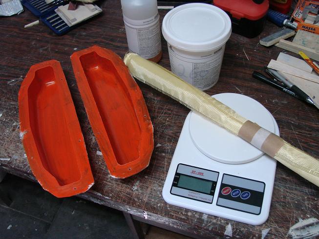

Old 05-29-2008 | 06:38 PM
Posts: 123
From: Orlando-FL
Default RE: Kevlar
Miguel,
I buy kevlar cloth from this selles on Ebay.
http://cgi.ebay.com/1-7-OZ-KEVLAR-FA...QQcmdZViewItem
I make the kevlar tanks for my Vigilante.
I use balsa plugs and poliuterane primer to finish. Aply the orange gel mold and fiberglass with resin to get molds. The pics show better my process.
When ready I post pics here.
Regards,
Fabio

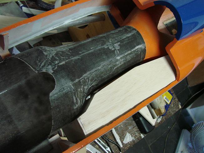

Old 05-17-2009 | 11:15 AM
Posts: 123
From: Orlando-FL
Default RE: Kevlar
Miguel,</p>
I finished my tanks months ago but only now i can post the pics.</p>
[img]C:\Users\Fábio\Desktop\Jets\Vigilante\Anuncio\dcs0 1232[/img][img]C:\Users\Fábio\Desktop\Jets\Vigilante\Anuncio\tank[/img][img]C:\Users\Fábio\Desktop\Jets\Vigilante\Anuncio\3[/img][img]C:\Users\Fábio\Desktop\Jets\Vigilante\Anuncio\5[/img]</p>
Old 05-17-2009 | 11:30 AM
Posts: 123
From: Orlando-FL
Default RE: Kevlar
the pics...</p>
</p>
flight video:</p>
http://www.youtube.com/watch?v=Asx3ybz_sOs</p>
