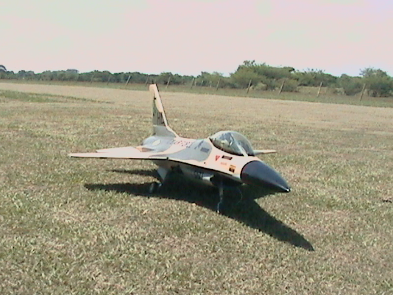

15lbs is ok for a beautifull finished F16, i don´t like the foam pattern that you can see over the econokote. How went your maiden? some pics of your bird? Mine flew well at 15.25lbs, not a speed demon but very scale and imprssive in the air.
Javier

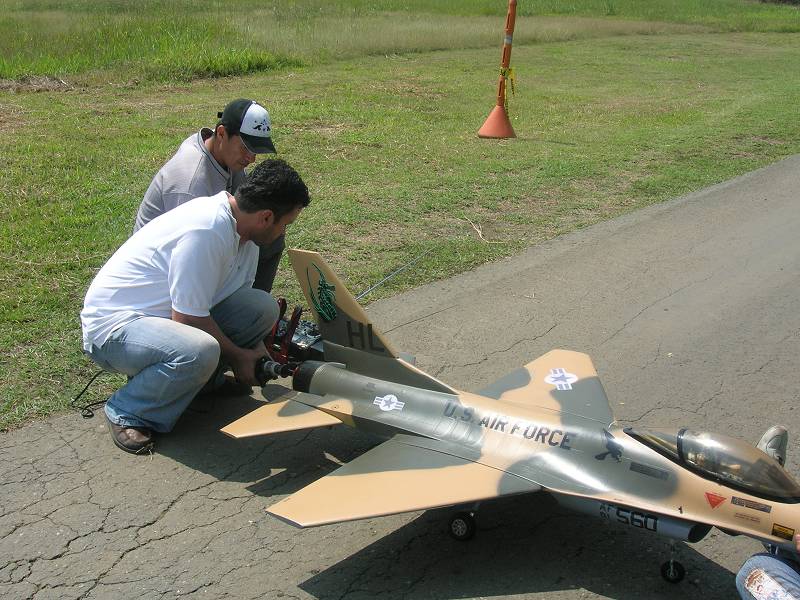

I think this is the best setup. A lot of people fly on tailerons, (without ailerons) but sacrificing redundancy. I knocked out my F16 due to a brand new servo failure on taileron configuration while on take off.
With ailerons i could have a chance. I know tailerons give more agility at high speed, but in landings ailerons are far better.
Two little high torke MG servos on ailerons does not affect the weight a lot.
The cheater is a must, this fan setup is a pusher and without an efficient intake will have a lot of losses without that hole.
Javier
