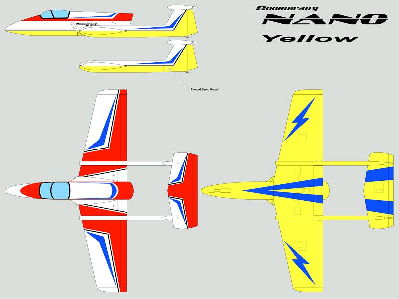

Alan,
Do you have any information that you can share with us regarding the NANO Boomerang?.....After seeing it at Florida Jets i was very impressed with it.....
Richard
Old 11-28-2008 | 07:45 AM
  #254
Posts: 508
From: London, UNITED KINGDOM
Default RE: Boomerang Sprint Build Thread!
Final Nano test flights were completed last week ............Very satisfactory! The order to start production has gone in and the first batch will be on their way early in the new year. This reply should really be posted on the Nano thread, (it will be in five minutes) but here's a drawing of the sport version.
No doubt some will say it's the same as all the others, but a good design is a good design whatever size it comes in, so I stick with it. It still took me months to tweak it till it flew right in the smaller size. But..........If it aint broke, don't fix it!

What size engine is the Nano designed for?
Old 11-28-2008 | 10:32 AM
  #256
Posts: 281
From: baltimore, MD
it is designed around a wren 44

as well as the P-60
The model has now flonw with both powerplants.

Ali,
What kind of flight times are you getting with the P-60 powered NANO?.....Will a 50 ounce Dubro fuel tank fit in there?
Richard
Old 11-29-2008 | 05:15 AM
  #268
Posts: 508
50 ounce tank fits perfect and gives between 5 & 6 minutes on the P60 depending on your throttle stick and still leaves a safety "overshoot & go around again" margin.
60" span, prototypes dry weights were from 10lb 2 ounces to 11lbs 8 ounces depending on the turbine used.

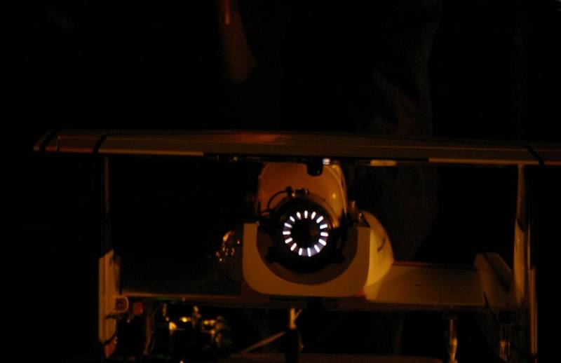

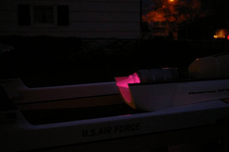

  #273
R/C Gypsy's Avatar
Joined: Sep 2004
Posts: 48
From: Rochester, NY
HI Guys,
My son Matt and I decided to see wht the JetCat P-70 in my Boomerang Sprint looked like running at night....
The Pics show it during acceleration...........then it cools, in the full speed blast, to a nice red-blue glow in the burner.
There is video here http://www.youtube.com/watch?v=Io3X2p0_6TY
This engine has just under 9 hours of run time and runs real sweet!
We did learn, you have to glue the marshmellows to the stick....LOL !
Paul
