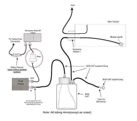

Hello all,
Working on installing my Titan SE and had a question regarding the IN and OUT ends for the jet cat filters (aluminum with basket and O ring). The instrctions state the O ring side is the IN end of the filter, but there are some schematics that show the filter with that end downstream.
I just wanted to confirm this before I complete the plumbing.

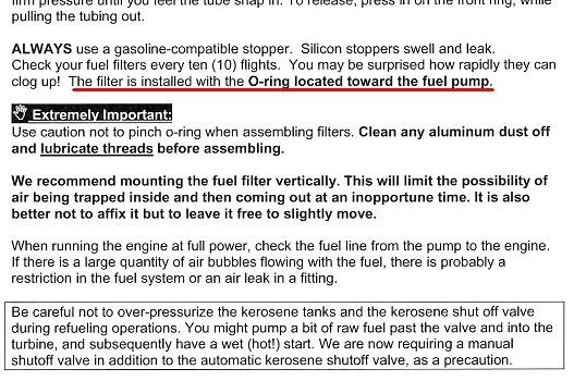

ORIGINAL: sc0tt
The O-ring end should always be the IN side so fuel puts outward pressure on the filter basket.
Sort of contradictory to what the manual states ...don't you think? However, I do agree the inlet should be on the o-ring side.

Old 08-02-2008 | 04:37 AM
sc0tt's Avatar
My Feedback: (61)
Joined: Apr 2005
Posts: 602
Received 8 Likes on 5 Posts
From: ORD
Default RE: Jetcat Filters -

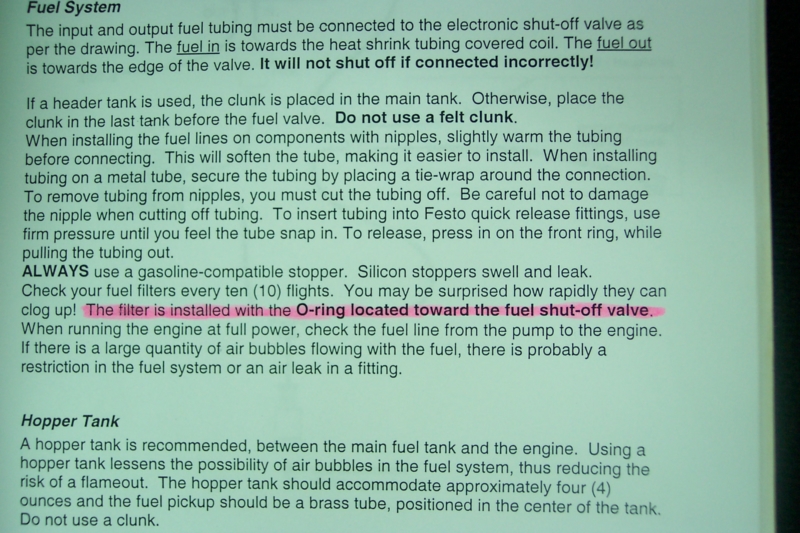

ORIGINAL: Countryboy
Apparently you have an older manual/turbine. I checked all my Jetcat manuals from 2008 back to 2004 & all have the same filter info. Below are scans from my 2004 manual. I don't have my older manuals, so I can't pinpoint what year the text & diagram changed.
ID:	1002401   Click image for larger version
Old 08-02-2008 | 05:07 AM
Countryboy's Avatar
My Feedback: (25)
Posts: 2,657
From: Lawrenceburg, KY
ORIGINAL: sc0tt
Correct, that particular manual is a bit dated.
Old 08-02-2008 | 08:28 AM
My Feedback: (15)
Joined: May 2003
Posts: 2,488
From: rochester, MN
I agree. But even with the newer version, later in the manual there are 1-2 schematics where the filter figure appears reversed compared to the fuel schematic above.
This current maual clearly shows the fuel filter with the O ring towards the pump. I have some older installations where it was not that clear and I think one may actually be reversed but has flown that way for 4 years!
Thanks for the clarification.
