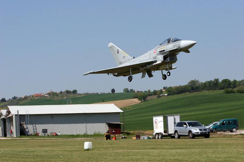

Default RE: Loaded Eurofighter build thread
Hallo.
I had build and fly a Efa, with Tam pipe, and Jetcat 160 !! It sounds good and fly well !!

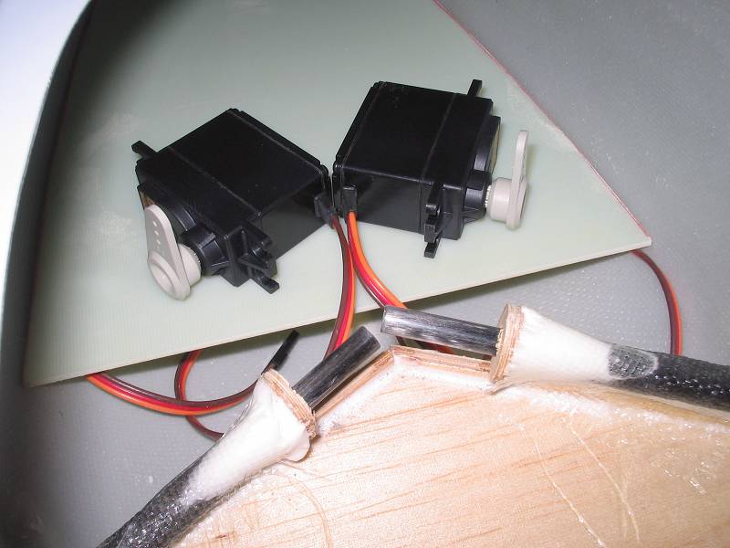

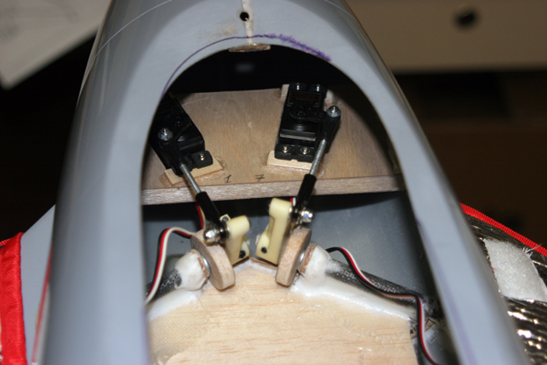

OK done an hour or so tonight so far and apart from some issues with a poorly made twin pipe I have started work at the front!
Added around 26g of lead shot in a 30min epoxy/microballons mix to each canard to help achieve static balance to prevent flutter.
I have seen some installations of the canard servo set up and often though it was not ideal, probably just me being overly critical but nevertheless have decided to experiment with a twin servo option. It may not work in which case I will resort to the standard setup. Adding extra weight with another servo and the resulting matchbox is far outdone by the use of Lipo in the nose so don't foresee any issues on this front. The aim is to get a short 'straight' linkage without having to use ball joints at both ends of the linkages to take up the angles involved.
In the picture you can see the idea and proposed positioning.

Put two servos on canard is a good idea. You can adjust very well each travel !!

Excellent, so at least the layout works. hope to get more time on it tonight.....

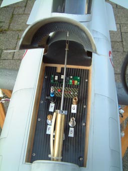

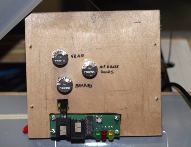

Hi - some pics from one of the nine I 've built.
Regards
Fritz/Switzerland

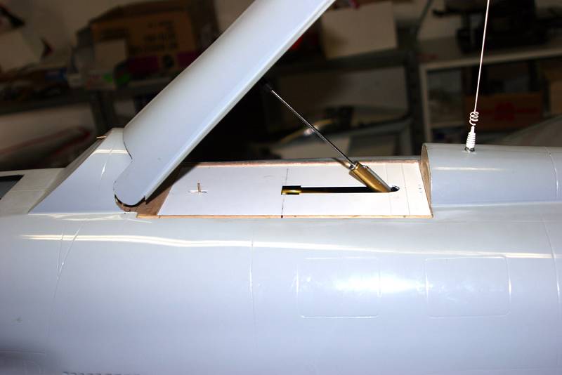

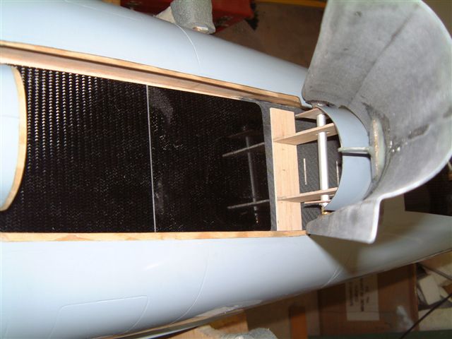

Fritz nice work as usual, great to see some pics of the air brake as well, I have the kit supplied for this so will be interested to see as many of these as possible.
OK sorted out the pipes, after a few mails and a conversation the supplier has agreed to re-make them so the exit nozzles are parallel to each other, should collect from Jetpower in 4 weeks time.
Have worked out and mounted (temporarily) the two 8411's to give the best overall linkage set up for the canards, just need to wait now for the mounting hubs for the canard shafts to arrive (see pic of 6.5mm version - supplied by Servocity who carry a great range of items for tackling all sorts of servo and linkage problems ) and I can complete the linkages. Still pondering over how to fix the front of this servo tray in the nose without removing a section to fit a fixing in - any ideas out there?
marc.

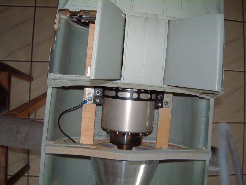

Hi Marc
thanks - here you'll see more my solution of the pipes.
Regards Fritz

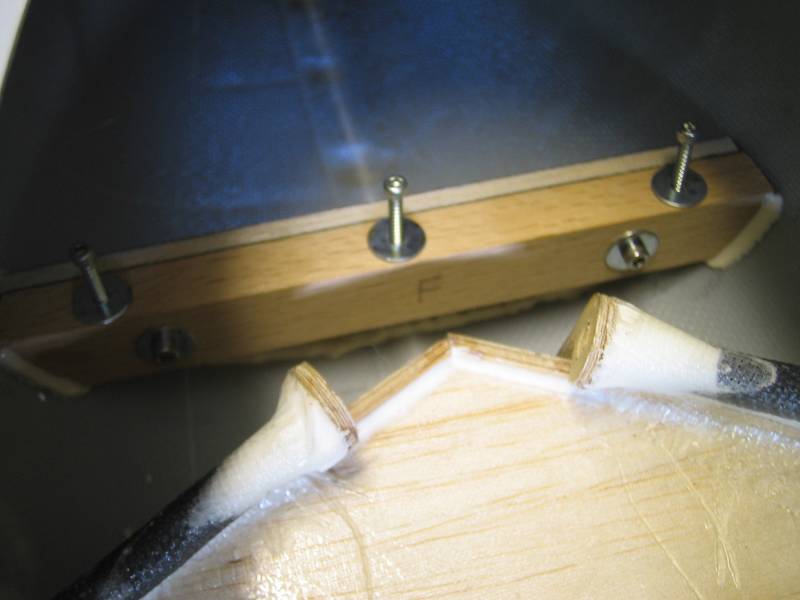

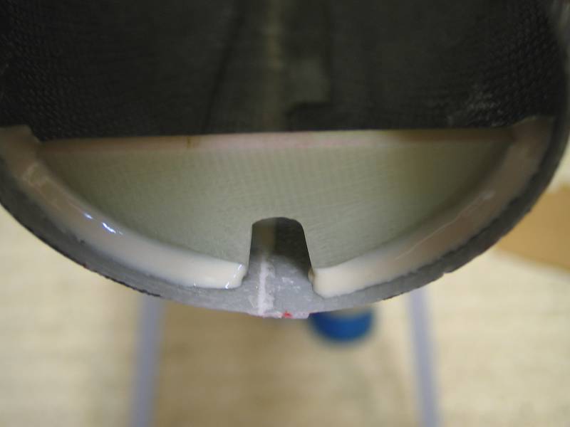

The nose had to come off!
I could not come up with a secure forward fixing that would allow the servo deck to be removable, to gain access to batteries and servos without getting into the nose cone area.
Took the nose off forward of the decks foremost position, and fabricated a notched piece of FR4 board. The securing will be done via a carbon rod fixed to the servo tray that passes into the notch, this in tern should keep the front section secure. The tray will be secured at the servo end via some screws into beach block mounted to a former which will be aeropoxied into the base of the nose just forward of the canard mountings.
More tomorrow.
marc.

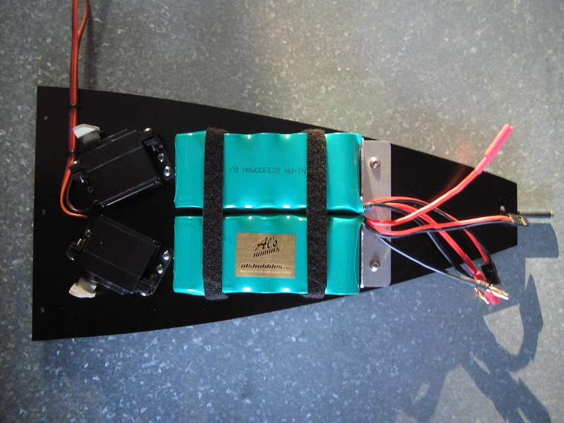

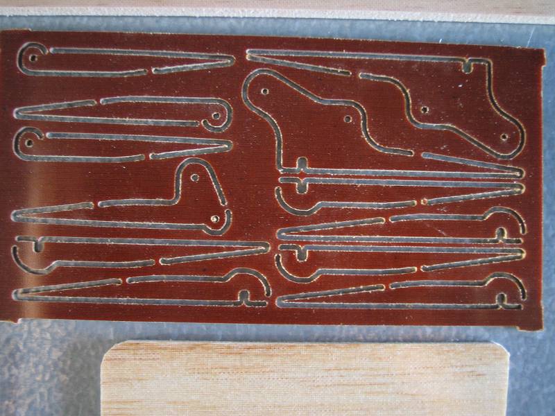

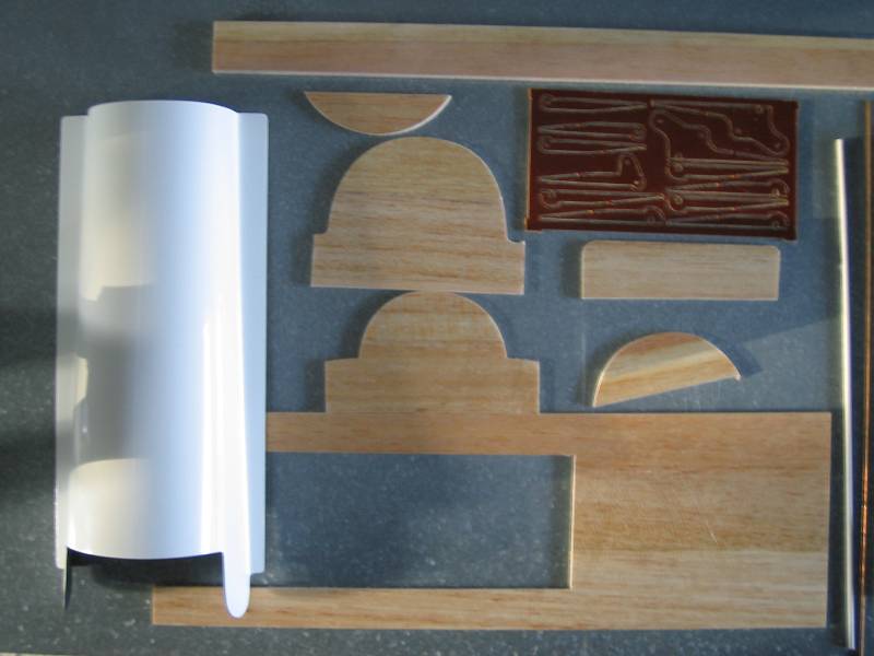

Finished the front servo/battery tray today, made up a new mounting beam and former for the servo end of the tray to fix to with 3 screws.
Have started to look at the speed brake kit supplied with the ES, and have no idea as to who makes the SB kit, can anyone identify it and let me have the details as I am trying to fathom out how the whole lot is intended to go together. If anyone has experience of this aftermarket speed brake kit any help greatly appreciated
