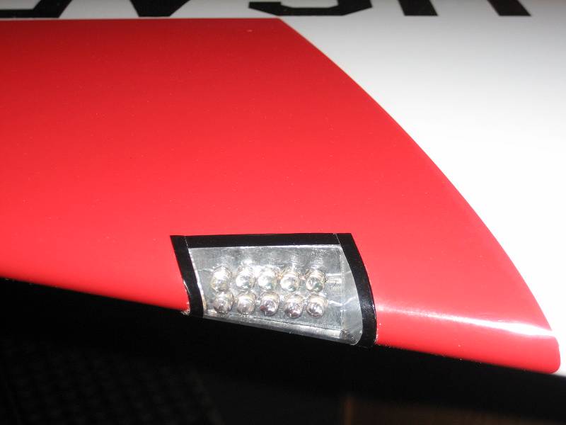

I purchased a King Cat that already had landing lights installed on the wings. They have two rows of five LEDs each.
There are two leads coming from each light bank, each lead has a JR male plug. One is labeled "Battery" and the other "Switch".
The problem is there is no controller, switch or instructions as to how these are to be operated. The builder of the plane is
unavailable for comment.
Any ideas or help will be appreciated.

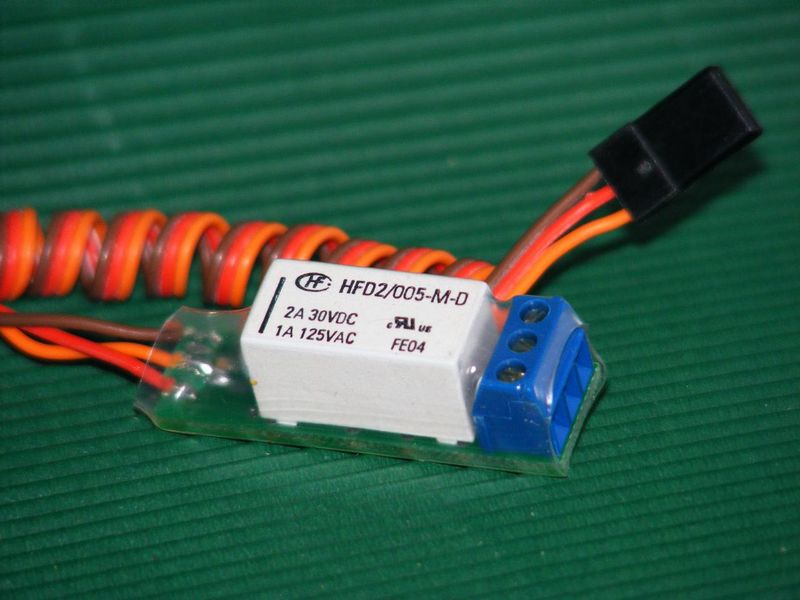

How about a servo input driven 2A relay swtich.

Rob,
Who is the source for this unit?
Todd
Banker,
Sounds like it might be the old JPOFL lights. Should be some sort of module to drive them. Can you take a pic of the lights themselves? Might help me identify what bulbs (therefore what voltage)
Todd

Todd,
I can provide them, they are made in partnership with a local electronics company..
The Specs Are
Switching current: 2A
Switching speed: 0.05~0.10 seconds (safety feature aspect - see below)
Output connections: Common, N/O and N/C
Size: 40x14x14mm (with heatshrink on).
Weight: 13g
Servo lead length: 300mm
Input voltage : 4.0V to 7.2V
SAFETY FEATURES
Requires at least 5 good frames before comitting a switch to a different state
If TX signal is lost, reverts to relay default setting (after ~0.5sec of constant loss)
Relay outputs isolated from R/C circuitry
Circuit is reverse-polarity protected
Led to show if relay is active for troubleshooting.
Rob

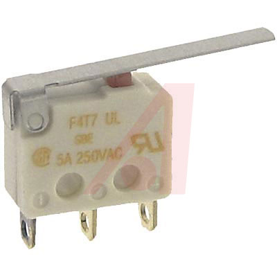

Save a channel and it is cheap and pretty much foolproof!
http://www.alliedelec.com/Search/Pro...DESC=F4T7Y1-UL

Here is a pic of the lights:

Do not need the roller, just a simple lever!
