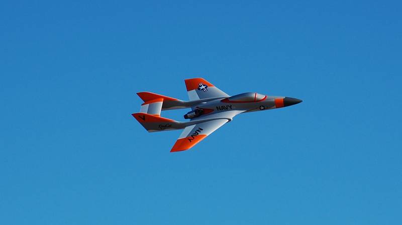

Pics

ALL RIGHT!!!!!!!!!!!
Congrats again.
Pensacola, here we come
