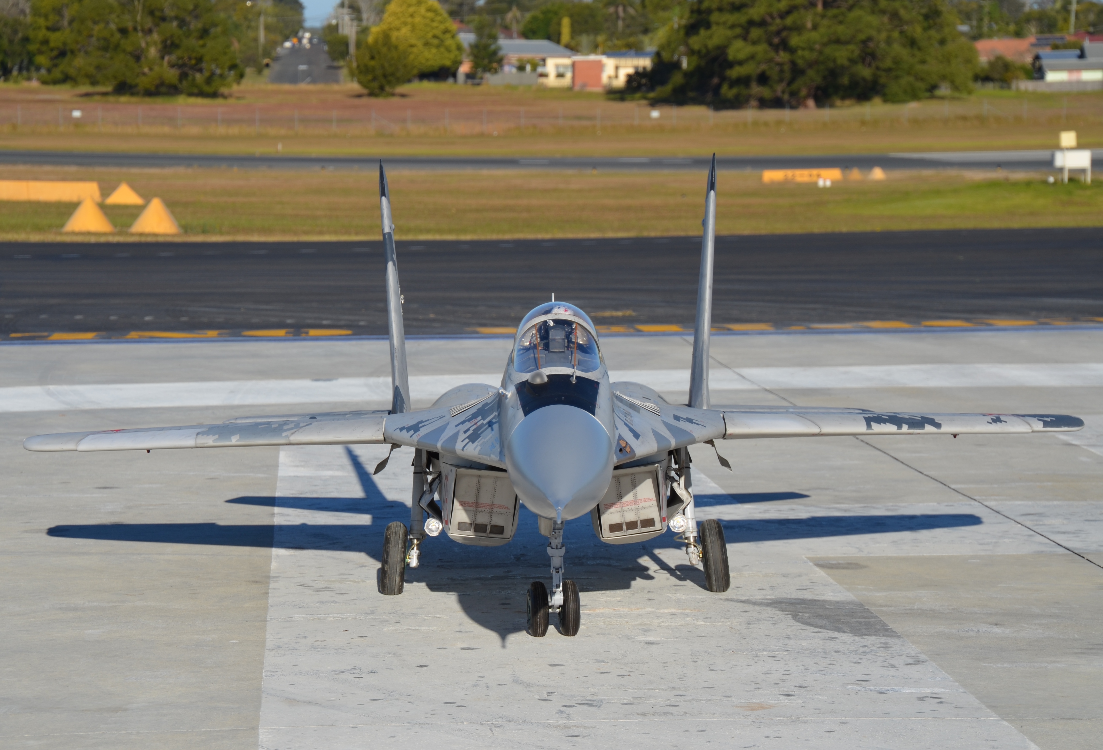

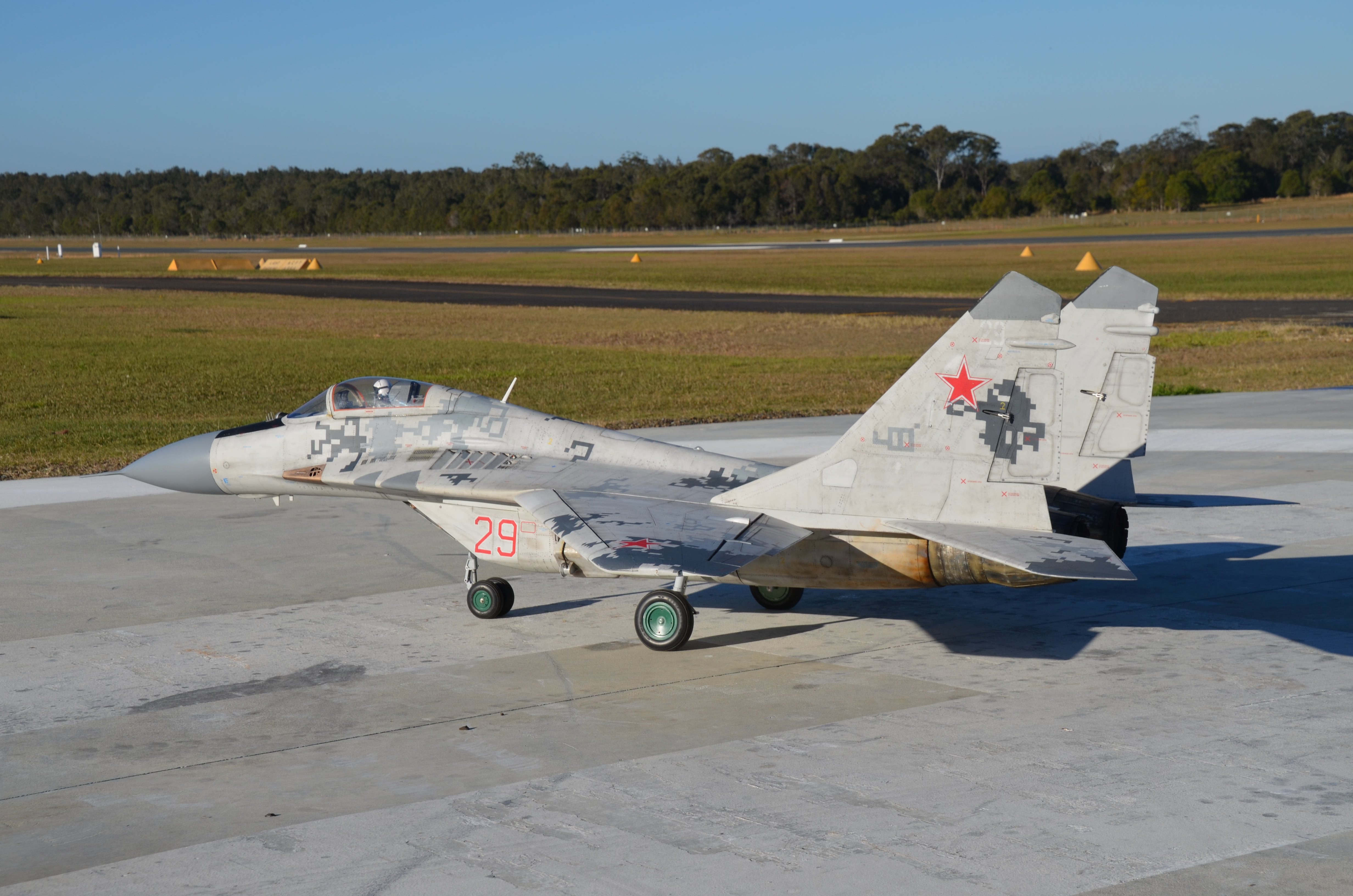

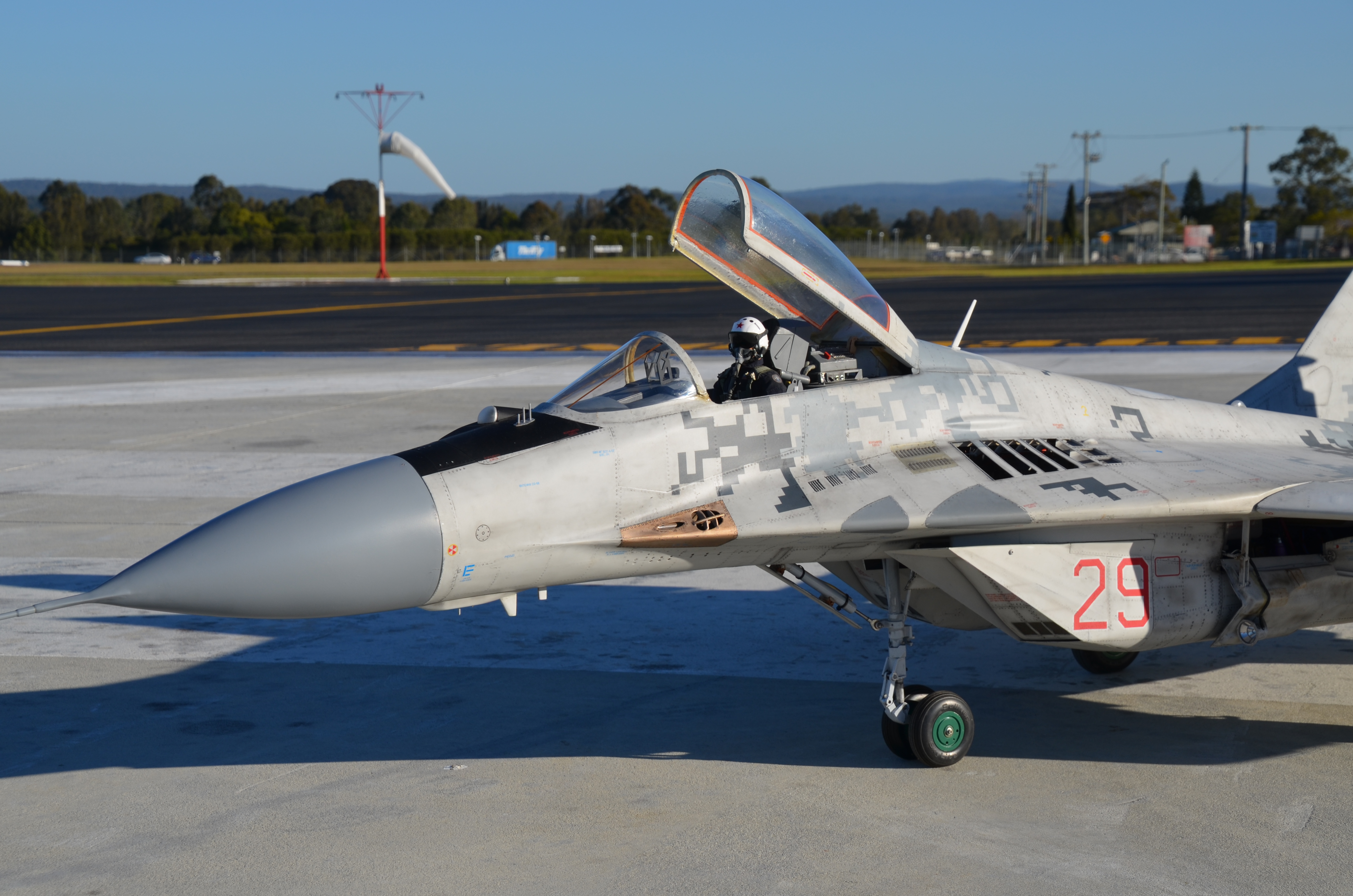

Here is my Mig up close Chris. I got mine half built from a friend here in OZ. He had done a brilliant job solving some of the issues with the kit already but i still had my work cut out finishing her off. I finished the build then painted and weathered it myself. Its an ongoing project with some more details yet to add. If you need any more photos let me know i got heaps.
Levi

Im curious about the main gear. I've seen a couple of these jets now with the main gear looking like it's spreading out. It's supposed to be vertical. Is there a problem with the mounts or something twisting in the fuse?

If the mains are mounted completely vertical they won't clear the fuse during retraction. I spent a lot of time trying different positions to improve the sit but that's the best I could get mine.

I solve the problem to mount main paralel legs. There are one possibility.
You has to start mounting a piano wire inside the axle hole on mains gears, cross both mains, after that's mount the legs on the main landing fuse mount, mounting the system to the fuselage with epoxy, the epoxy will absorve the difference between the fuse mount and the correct position.... Sorry my English. The point is.... Fuse main plywood mount are not correct....

Gus the problem with mine wasn't the angle of the plywood as I could fix this by spacing out the mounts with washers to adjust the angle.
The problem was the arc that the leg swings on during retraction won't clear the fuse if vertical. Have you fixed yours yet and do you have a pic of what you've done?
Thanks Gus

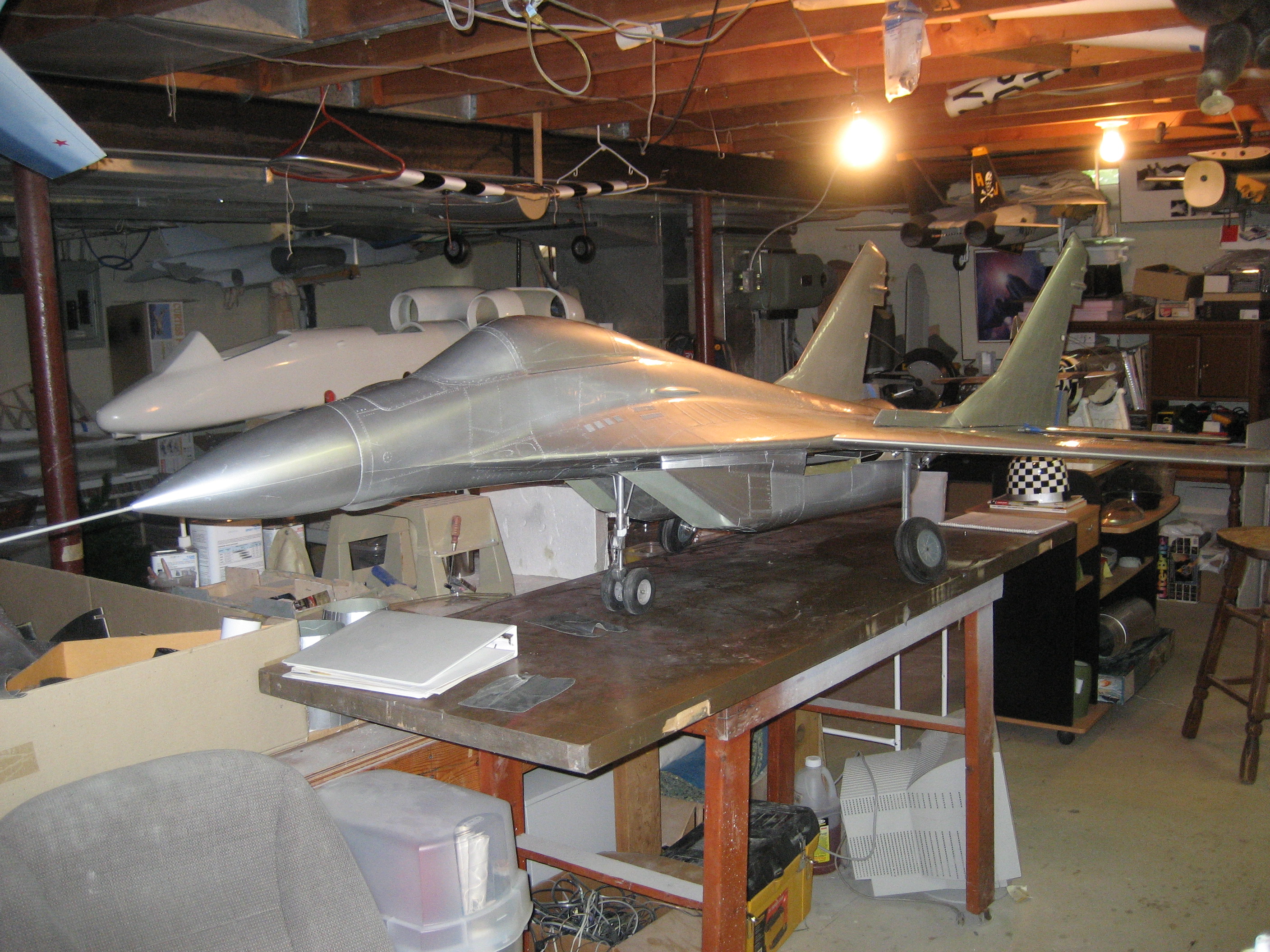

My Mig is kit 18 and was complete with the early hydraulic system including the cylinders without locks. I missed out on getting an updated set from CARF. Is there any simple method to mechanically hold the gear in the down position while the model is on the work bench. It would make it easier to work on if I could keep it on its feet. Can I buy the locking cylinders anywhere? I've sent emails to Hausi but didn't get any replies. I suspect a phone call would be better.
John

During my build I removed the cylinders and installed steel rods of the right lenght. A round of locking wire will keep the cylinders compressed too. No available info on the locking cylinders, sorry.

The other option is to put a ball valve in between the nipples on the cylinders...open to change position of the leg and close it to lock them in place. Levi is right about the clearance issues with the main legs. I tried to get mine as close to vertical as I could but they are not perfect. Gus, your building suggestion is a good one thought for getting the legs aligned well. Will try that on my next one.
