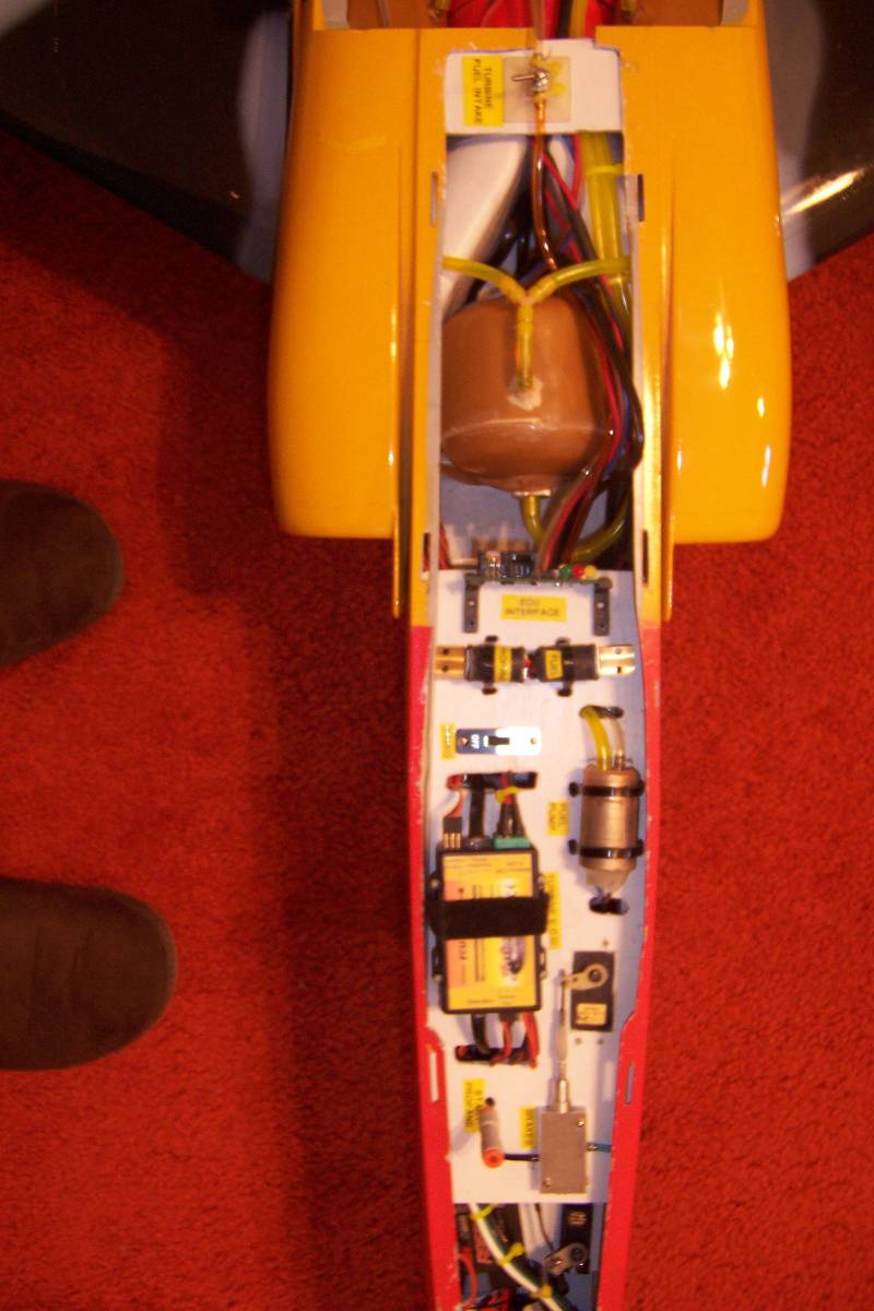

Here is a couple of mine.....

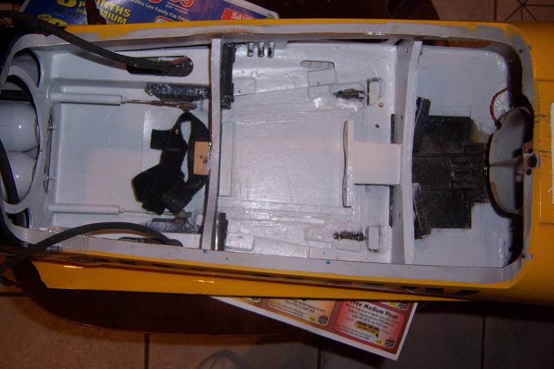

Do you have 2 MD's?
Your forward one looks alot ore slim than mine..? I was just thinking tonight, After my pneumatics are done the my MD may be close to full, I guess ill have to make up something for my engine accessories? [sm=drowning.gif]
BTW did we put our air tanks in the same place? Im having trouble orienting myself. If not do you think mine are ok here?
I did run a search on "jet installs" and similar phrases but I not getting many pics..?

2 different jets.... The F-22 had all the service ports right in front of the engine, so only one hatch had to be taken off between flights....The F-16....that was my 5th or 6th try... I made templates from cardboard and laid everything out...if it looked promising, I cut a rough one from lite ply and did a dry run to make sure everything would fit....there is a lot of stuff you underneath out of view. Although I am still using the same board, it looks totally different now due to differnt engine, different batteries, and 2.4 Receivers.....and no switches.
Is that an F-16? Looks like it may be.... I shoved the tanks as far into the nose as I could so the volume under the cockpit could be filled with all the other hardware. I used a pretty big fuel filter (that round aluminum thing) which took up a lot of room....

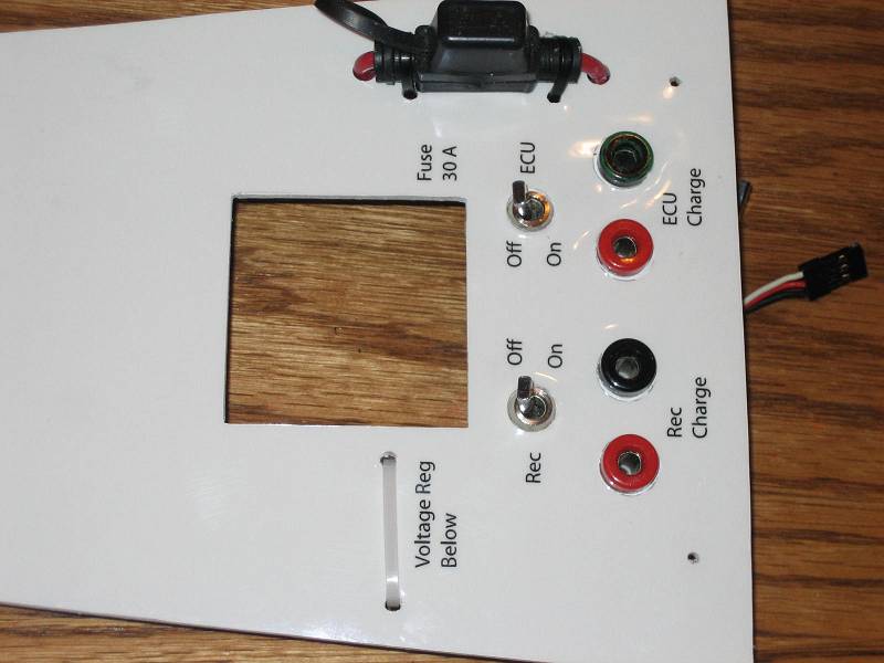

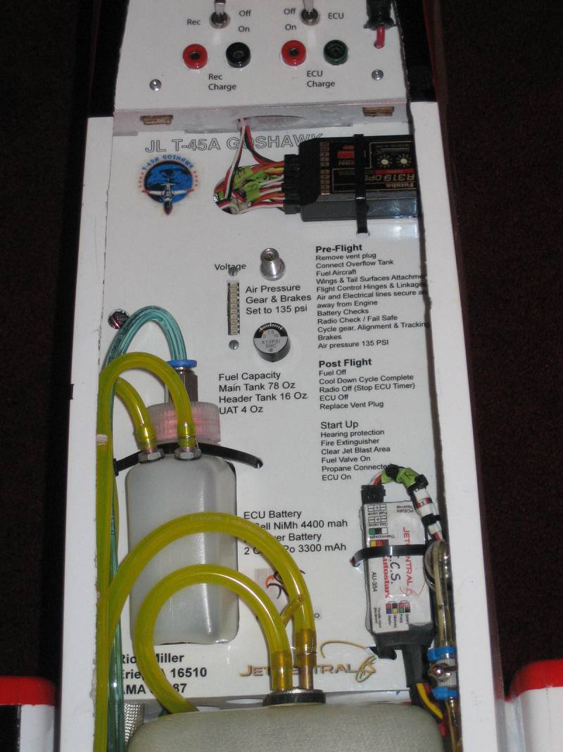

Here was my T-45 lay out....

That's awesome guys!
I like the checklists,
Anyone with an 1/8 F-16?
Pete
Is that what we run for air pressure? 135 PSI? WOW. Rich, Are your air tanks all the way up in the nose?

135 psi was need to run the JL T-45 retracts, these retracts seem to be inadequate for the job, the only way to make them work reliably was to raise the pressure, I used one Big tank under the tray.
BTW it is a simple task to make the overlay shown, basically if you have access to any graphic program and a laser printer you can do it. Create your design and then reverse print on overhead projector film, on the printed side of the film spray paint white or whatever other color your desire, then let it dry completely. When you view the film from the front it will read correctly and the graphics will be protected. Now take 3M 77 spray adhesive and coat the back of the film and press down on your equipment tray. Viola... you have a professional looking tray

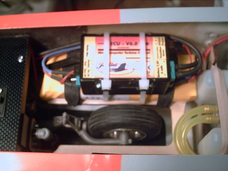

Here's a couple of pictures of my FEJ F-16. The air tanks are mounted in the fuse wing roots and two receiver batteries are mounted in the nose cone for balance.
