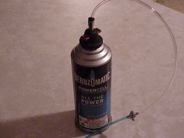

i just got my propane start setup done. i went to home depot and got one of the bernz-o-matic green propane bottls and the hand held torch on the end of a 4 foot hose. the hose is 3/16" in diameter. So i cut the hose off about 2" from the bottle fitting (which also has a on/off needle valve) and went to the local hardware store and found a 3/16" to 1/8" hose reducer. Then stuck the reducer in the propane hose and a 4mm festo line on the 1/8" end (t was a tight fit, but it went on). works great, cost about $25. but i didn't have to wait a week to get it

Do you guys have any pics you could post or send me. Thanks

ORIGINAL: stuka

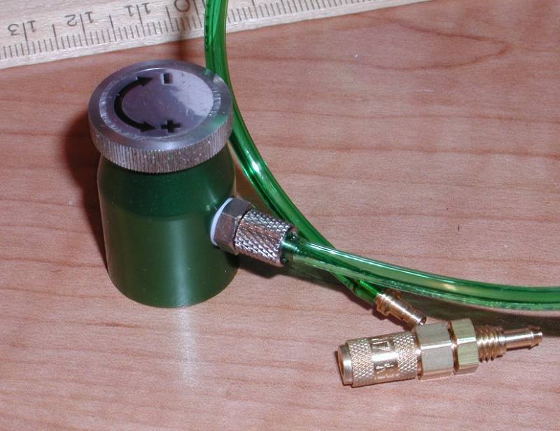

Here is what I use:

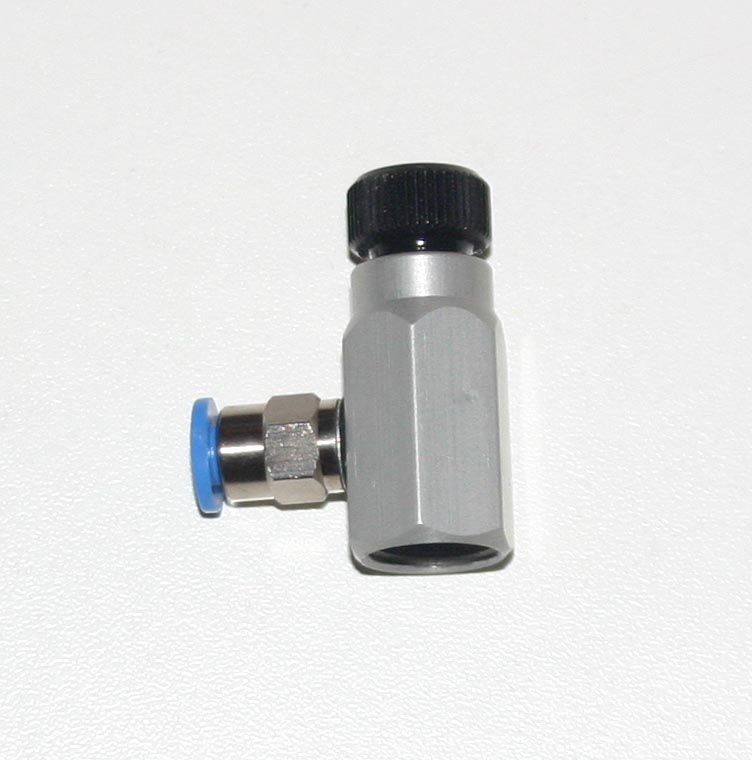

Default RE: Refilling propane start bottle
OOPS! I looked all over and forgot Altecare was mentioned.
This valve below came with my Wren SS and also fits the threaded cans. It's really nice and has reverse threads on the knob.
This type of fuel can doesn't have a clunk so you will have to hold it upside down for liquid or upright/normal for gas starting right off of the can.
