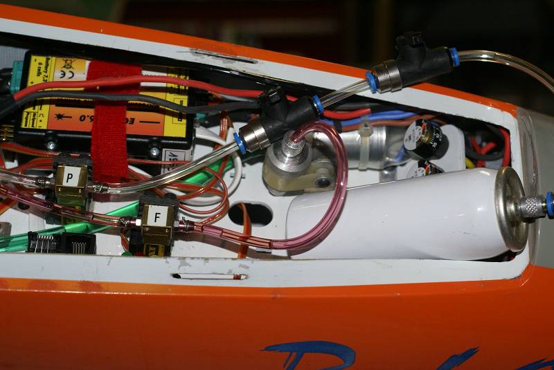

Hi guys
I was just having this thought and would like to have your comments about it.
In my F18, I have 20 flights with no problems. I have an on board gaz tank installed horizontally in the LEX area. The fill valve is a one-way valve from Festo.
Everytime I fill the tank with gaz, it is almost enough for all day flying, so I do not have to worry about filling again prior the nex flight. That is the plus point of having on-board gaz.
Nevertheless I was thinking that if some day the one-way valve leaks with the turbine running, the gaz will just go CAPUUUUUN and I will have a nice barbecue to break my heart. That might happen in flight as well. Once I saw a couple of videos where that happened.
Who is flying with on board gaz and what redundant measures do you take?
Regards
Nuno

Ok Guys
Thanks for the replies. Some comments:
I am willing to go with gaz because kerostart just wastes to much batteries and would have to buy at least 2 plugs (1 for back up just in case it collapses in the first run)
Spider Jets:
In fact the JC ECU as the option to burn all the gaz, because it just opens the solenoid gaz valve. But, if the oneway valve is damage there will be exhaust gases from combustion leaking inside the plane. REMEMBER - solenoid gaz valve is open.
I was thinking about having a manual gaz valve and keep the oneway to fill. As soon as the turbine starts, close the manual gaz valve.
Does any of you have this set-up?
Regards
Nuno

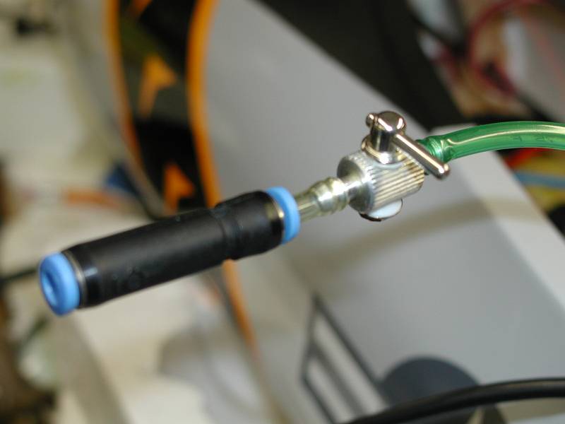

This is what I do...

BINGO
Where do you get that manual valve
Regards
Nuno

The small ball valve is available from the JetCat online store. Part number A1013 Price $11.95
www.jetcatusa.com

As Harley said it is a JetCat valve, I had a few extras. Dreamworks may also sell them.
I use this whether filling the onboard tank or using the green bottle propane. I don't trust the one-way valve or the solenoid.

In fact I am not concerned about a crash, because in that event the small gas bottle might be the last of my concerns.
A while ago, I remember a jet caught fire in flight and in the event of a gas leak during flight, if it reaches the exhaust it sure will catch fire. With a filled small gas can, I only need to fill it once to fly several times and that is why I'm using it.
My concern is to have a redundant safety valve to avoid such an event and a manual valve might be a good option.
Do you rely only in a oneway valve?

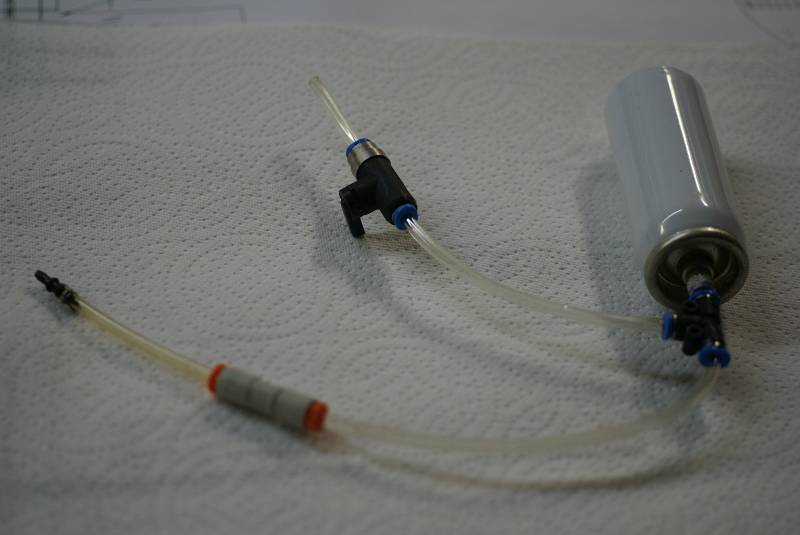

Off board Powermax.
Here's one way to do it.
Open both valves, start up, close the valves, disconnect.
ID:	1094692   Click image for larger version

ORIGINAL: Harley Condra
Off board Powermax.
It's a lot simpler to just hook up and hold the Powermax can upside down.

Off board Powermax.
Great idea!
I wonder if this could be further improved by using a shut off quick disconnect like the one we use to fill air:
http://www.dreamworksrc.com/catalog/...roducts_id=506
Festo connectors are often a pain to attach / remove. Is there any reason why using an air quick disconnect would be a bad idea? Can you guys think of a more suitable quick disconnect?
Arnaud
Both Festo & SMC make one with a check valve built in. Both are metal & use a metal fitting that plugs in. Just plug in the gas line, start, & then pull back a spring loaded collar & the line pops out sealing the tube to your solenoid. - John.
