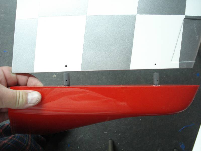

First little thing I did was mount the winglets. These little things are soo cool. I guess you could just put some glue on them and slide them on but I wanted to make them removeable just in case I break one or for transport.
I drilled a small hole for a #2 buttonhead screwdown through the carbon tube sleeve. Then slid in the winglet where I drilled a smaller pilot hole for the screw to achor into.
Now there on strong for fly'n and off quick when need be.

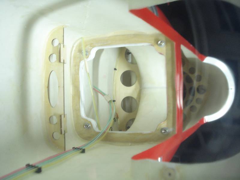

There is a lot of room inside for the install but it is still a pain planning the install due to the full cockpit setup. The cockpits are very nice but fairly flimsy so will not put up with being removed everytime. I am in the middle of my install and have decided to trim the long grey areas behind the seats of the cockpits and using the gap this creates to put a plate across the fuselage with necessary switches etc on.
Let me know if you need any pics etc.
