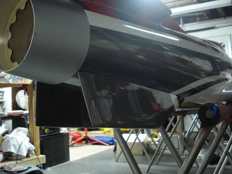

While everything is drying I was able to get my hands on the ventral fins. This fit real nice and wouldn't you know it the paint trim lines actually matched up perfect.
Traced the outline of where they touched the fuse. Went back and lightly sanded both sides so the Zap a Gap Goo would have a better hold. I've had pretty good luck attaching these ventrals using flexible glue. I sometimes hit the ones on my F16 and they still stay strong. There is way more clearance in the Viperjet than the 16 so I don't think I'll be hitting these as much, or ever, but I still like gluing them on this way.

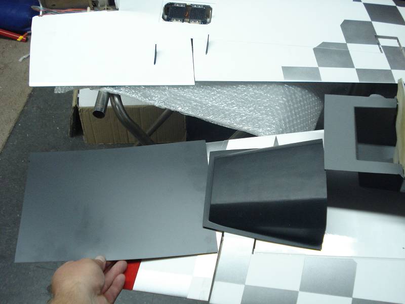

I bought a pack of black ABS plastic sheets a while back for just this purpose. Seems to have that "aircraft interior "color and sheen too. I have to modify other decks as well .
Cut a piece 12" long, extending the dash by about 5"

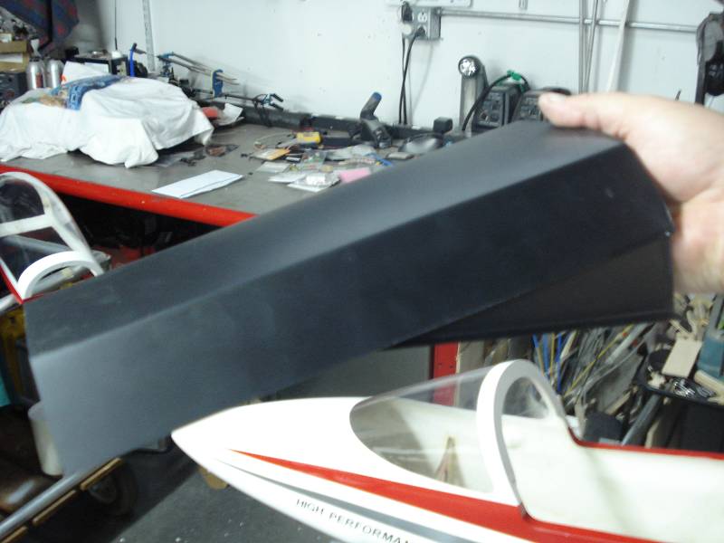

I then laid the stock dash on top of the plastic to mark the locations where the bends where. Then took a straight edge and bent over the plastic to create a angle.

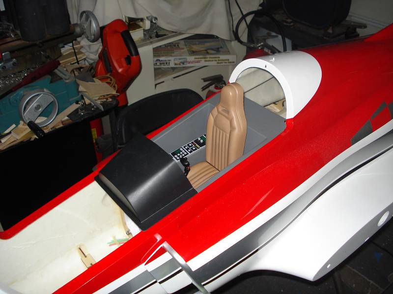

Here's a pic of the finished dash. I think it turned out sweet, and no gaps. I'll take it. Plus after the cockpit slides in, in locks it in even better.

Since the front cockpit has a lot going on and may not be the most convenient to remove all the time, I will lock that in place with some small screws and just remove the rear cockpit to access the maintenance board. The rear one come out real nice and easy. I have thought about making access panels in the side of the fuse but since the rear cockpit comes out so well I don't think it will be a pain to take the canopy off then pull out the tub to fuel/charge/ turn the plane on-off etc.
