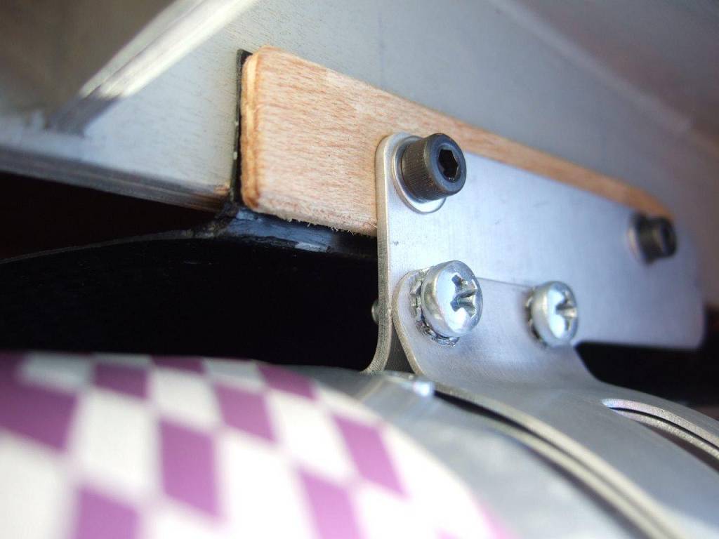

I want to revisit one subject. Mounting the turbine. Options are above or below the rails/with or without packing. In either case I expect to use a throttle to elevator mix for when I pour the coals to my Cheetah. It's been a few years now since the manual was written, we all know Dave has build and flown a bunch of these planes. Where would you put the motor?

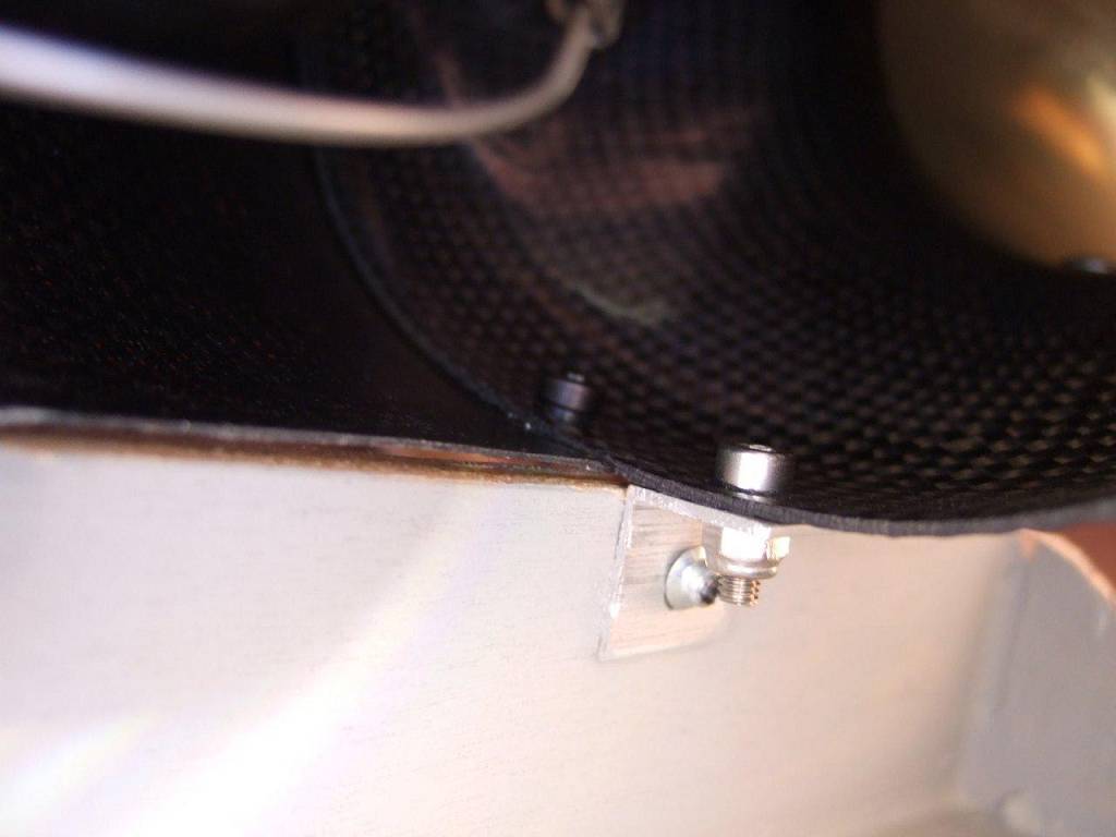

When I mounted my 120SX i turned up a plug to fit the exhaust and that was glued centrally to a ply disc that fitted the bell mouth. I found it was out so I fitted some 3mm ply as in the pics....
Alan

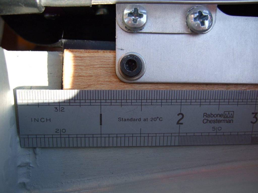

You want the turbine as high in the fuse as possible. I raised the elevator servo mount 10mm after my prototype model, but the outer cool wall still interferes with the plate if you raise it right up.
JetCat have the offset mount...so this makes a difference.
Some of my guys have mounted JetCat turbines on the other side of the rails (top in the real world) I guess Jet Central turbines have no offset on their mounts?
I guess is need to measure an exact possible centre for the front of the tail pipe, but I'm not due to start building another of these until I have finished 2 Ultra Flashes I now have to build (and a bunch of stuff to finish too)
I have a friend building one now...I see if I can get a measurement off his. If you were to mount the carbon half duct above the rails, screw the cone to that and centrally mount the turbine in the tube it would be about right.
Dave
