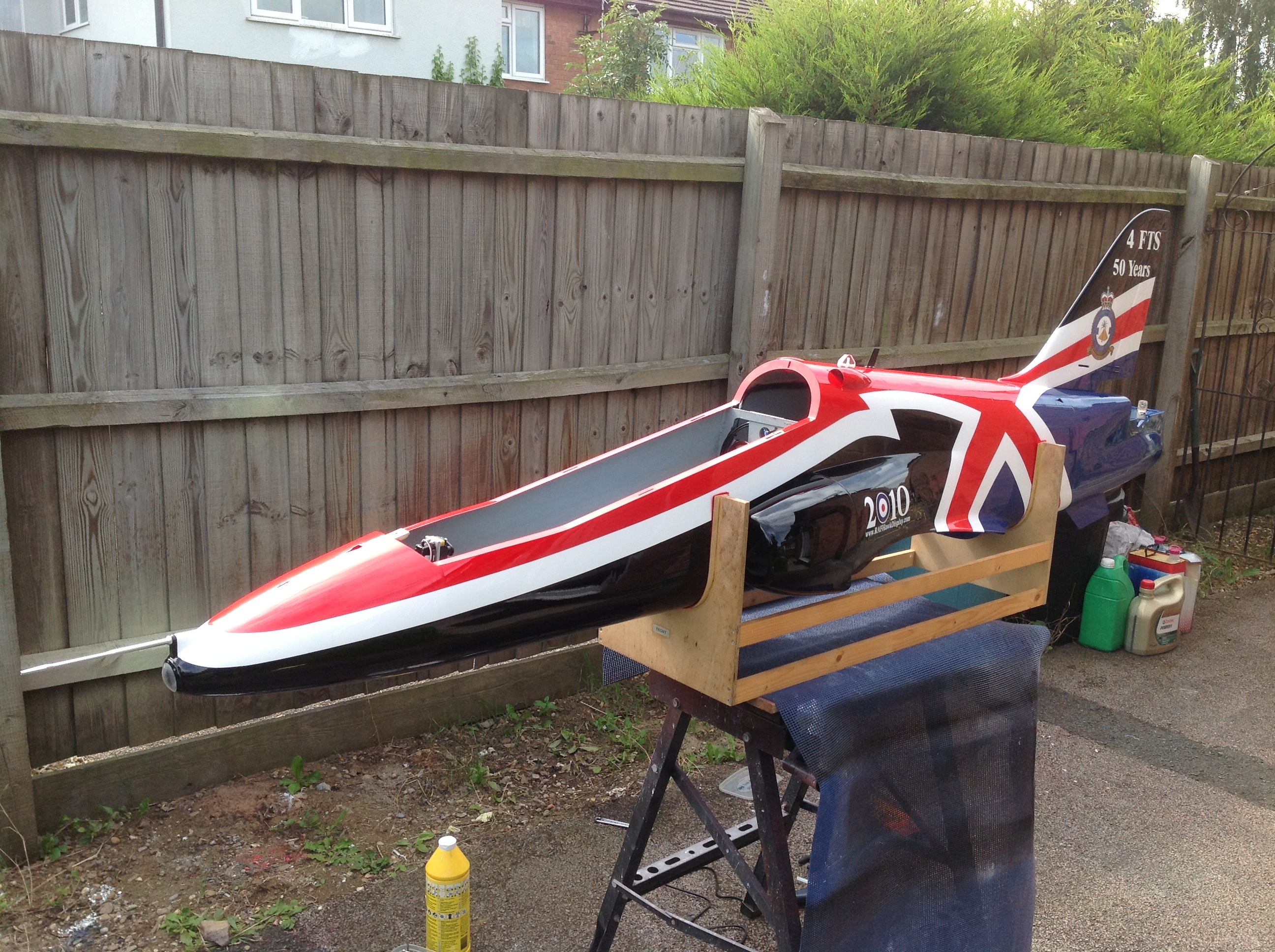

Think my Hawk around 190/195 going to re-check this once all back together as got to check any way with re-painting should not make much difference but better to be on the safe side..
Coming together, got both strobes back on and re- bolted on the intakes, just got to re-spray aerials then tank, JC and tube I know its taken a while what with work and weather but well worth it...
Alan

Use high number grit 2000 - 3000 plenty of water then I use G3/G10 Farecla rubbing compound then 3M fine compound, that will get rid of scratches in canopy. The strobes I made were done the same way and you can see the finish on them and that's after cutting with 2" cutter.
Alan

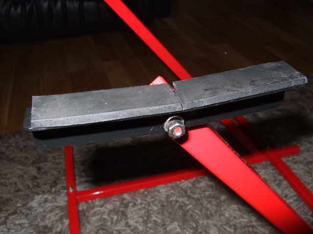

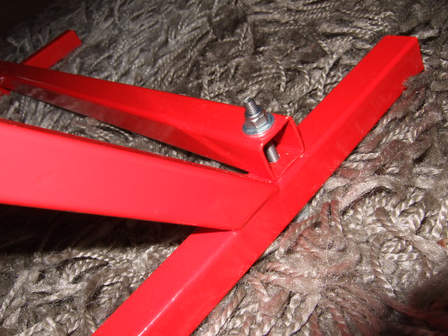

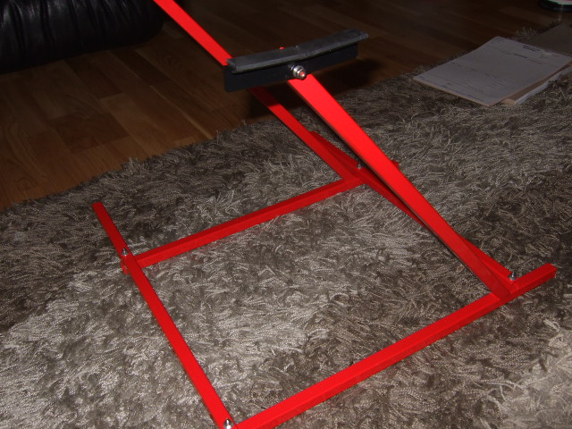

How are you guys measuring the CG? To get a resolution down to a given millimeter, you must be using something than having your buddy assist you and lift the wings by your finger!
Also, I am not sure I understand why 15mm will make such a big difference in the flight handling characteristics of this plane. I am still new to jets and would like to learn as much as possible.
Old 08-27-2013 | 09:40 AM
  #1369
fireblade5437's Avatar
Joined: Dec 2005
Posts: 974
From: Leicester, UNITED KINGDOM
I built this balancing 'device' to balance the Hawk though it sure does help if you have a second pair of hands to help you lift the plane on
Each supporting arm has two bearings to ensure free movement..
Alan
Finger tips are fine for me, every pilot has a difference requirement. I have flown the Hawk with a huge range, just you need to adjust how you land that first time knowing how the elevator feels. The Hawk I flew last week was the most extreme, ending up with 1lb of lead stuck to the tail fairing!
