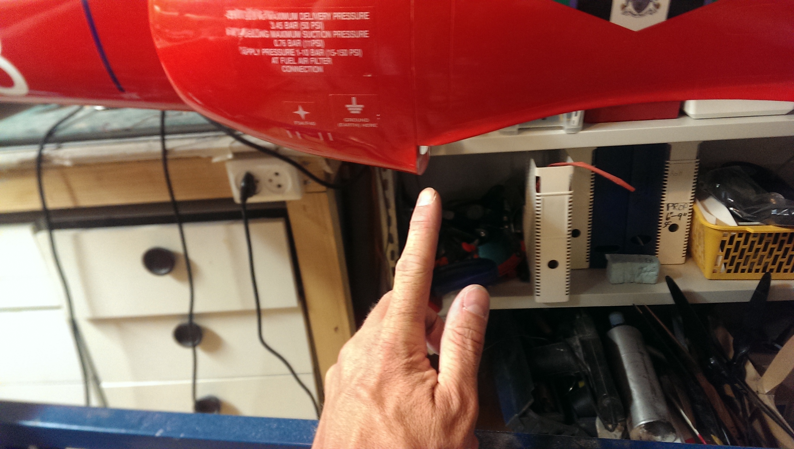

Bought my Hawk second hand and it seems quite noseheavy with all batteries upfront.
Can anyone please confirm my finger is pointed to the place where I measure CG?
Think I will start at 195mm and try a bit longer aft after first flights

Flown one back to 210mm...
The Hawk is a strange one with a huge balance range!

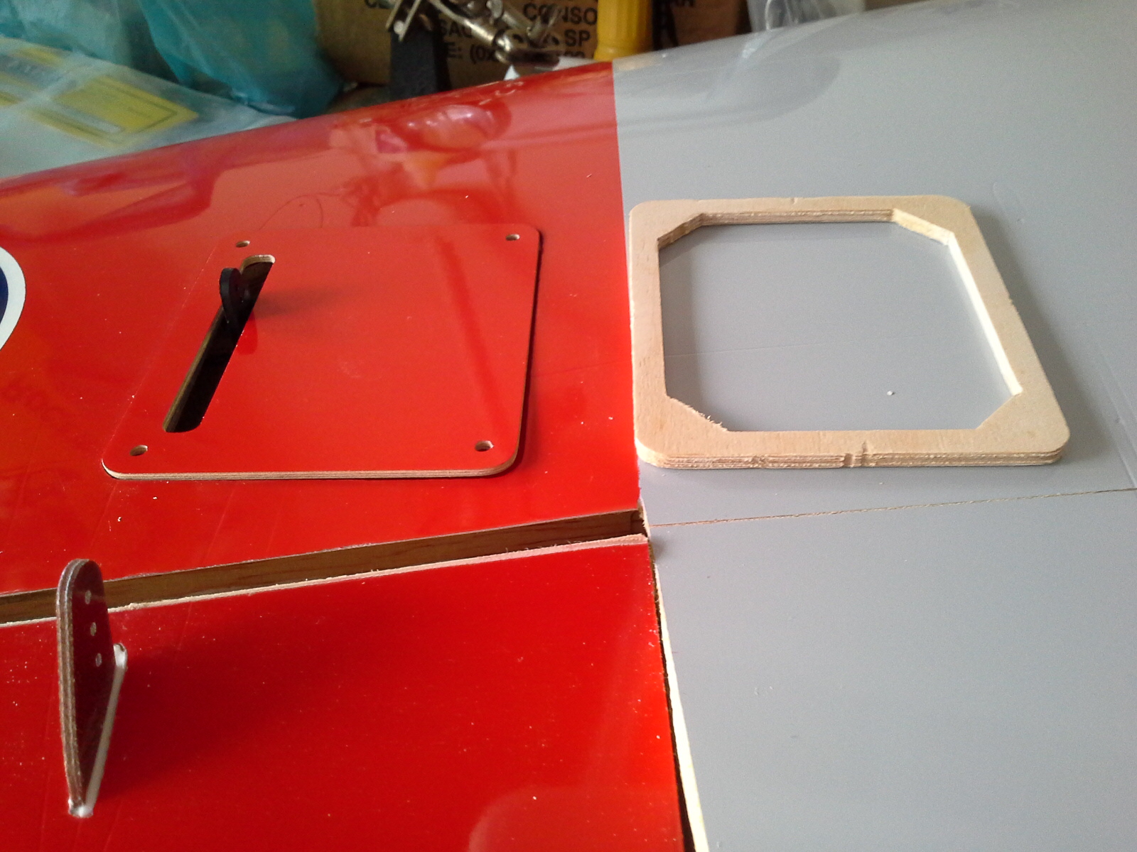

I'm using Align DS 610 servos on ailerons but they didn't fit inside, it seems they are wider them wing height. Should I use the provided spacers?

Its designed for a 19mm wide servo like an 8411. The wood you have is provided to go under the lip that's there, but you could use it to pack down the hatch...but there would be a step.

My servos are 20mm wide.
Do you allow any gap between the servo and the corver?

No, the servo side sits on the cover. If you trim the lip and move the servo as far forward as possible it might fit. Will only be one edge that hits.

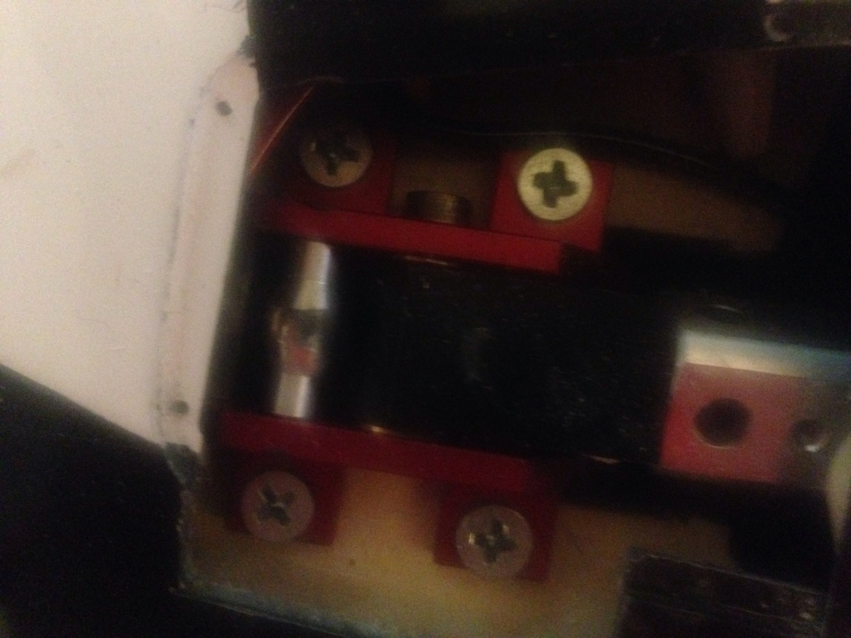

What would cause the brass pin/rod that the retract pivots on to shift aft? What holds these in? One of mine works it's way part out and binds up the strut cover and almost resulted in a gear up landing. Help!

German engineering at its most basic. There are different versions, but pin dents hold some. Take it out, clean it and loctite it to the yoke. A little heat and a push will get it out again

It's a little too loose for loctite - I may just put a dab of silicone on each end if it doesn't need to turn

Smitty, mines have a set screw on the inside part of the trunion that hold the pin in place.

Well, I don't mind doing that either - seems easy enough? Both sides of the frame or just one? Can you snap a quick pic?

I'll get a pic uploaded in a few. The set screw is actually on the trunion where the gear leg attach to

Guys, thanks a million for the help! I'm an idiot - totally see the set screw and it was backed out a few turns but still there.

Smitty, sorry i didnt get back sooner with the pic. Glad you got it fixed, my gear came new with out one set screw thats how i found out where they go.
