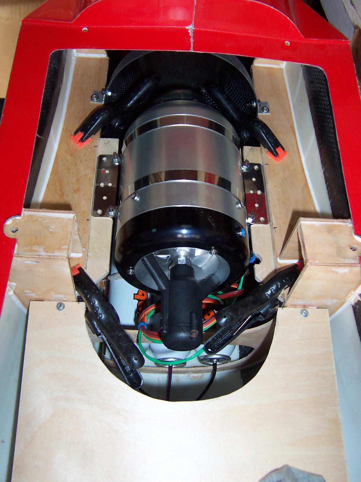

Default Air cylinder close to turbine

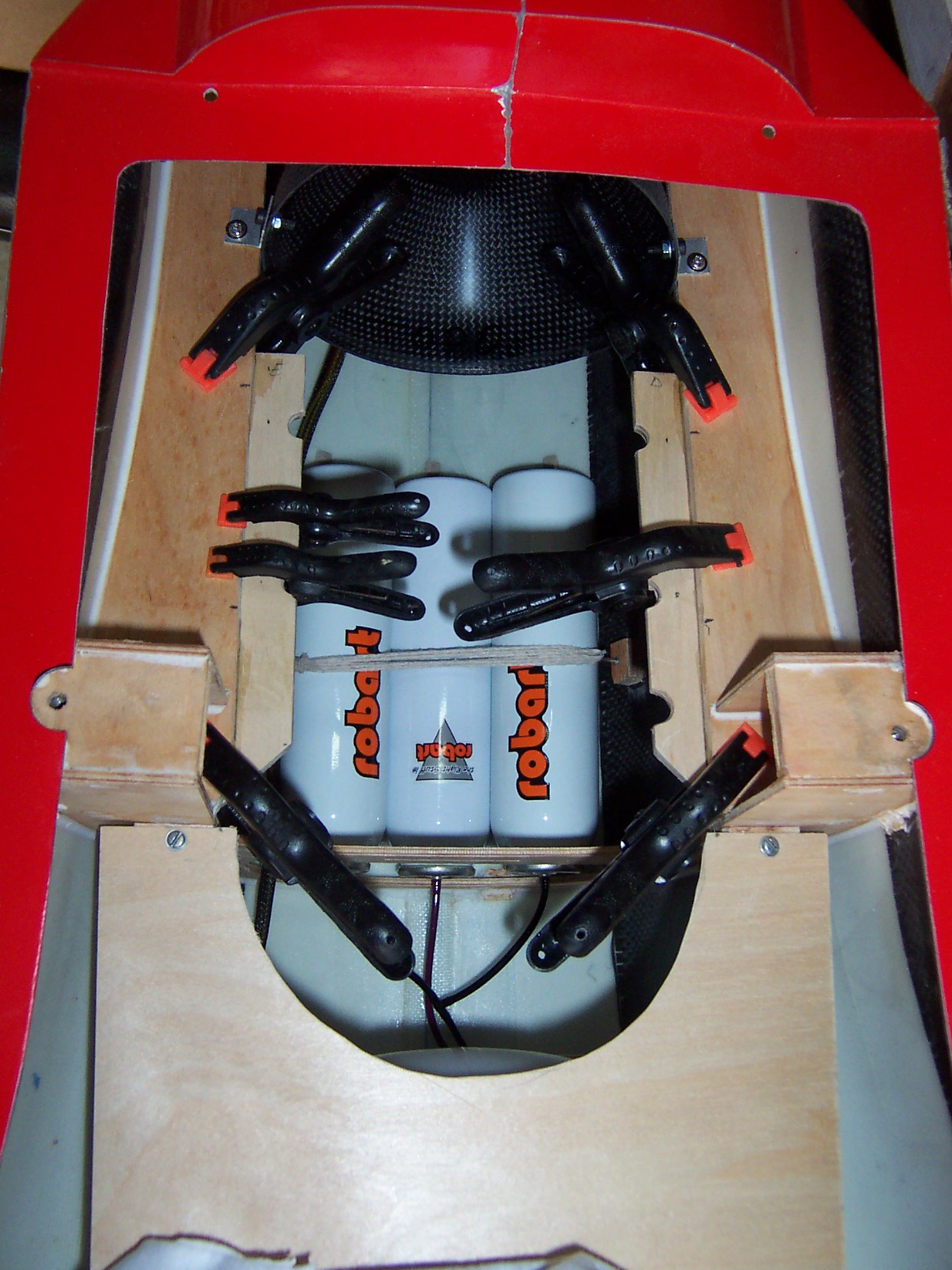

I was considering installing the air cylinders above the turbine, like in the picture. Any concern about possible air temperature increase during flight and consequently air pressure increase?

I think most people just install them above the fuel tank. Plenty of space there, thats where mine are.

I saw that.
But my fuel tank is not the original one. I have two dubro tanks and both together are narrow and taller than the original one. Installing the air cylinders behind will help me menage my space. I still have scale cockpit and smoke tank...

I have mine in the wings, for me the most obious place to locate them. Also the valves are there of course.
If you are using the carbon shroud I would have no concern putting the tanks there

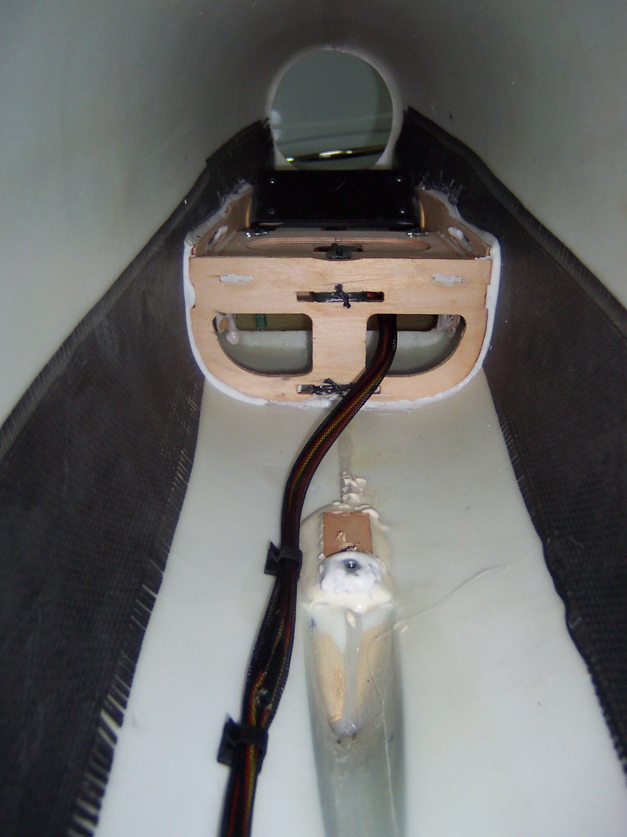

Tail servos harnness

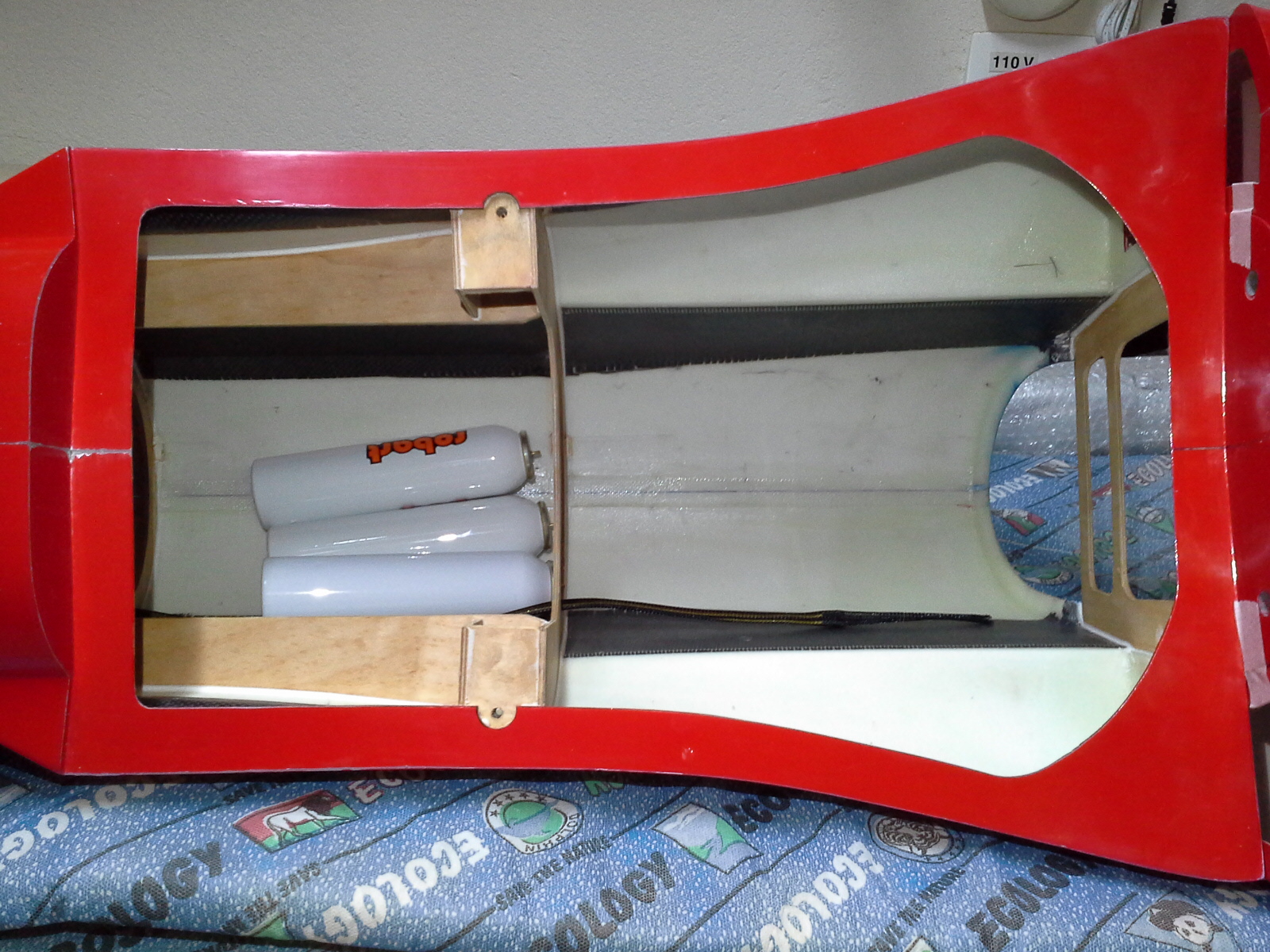

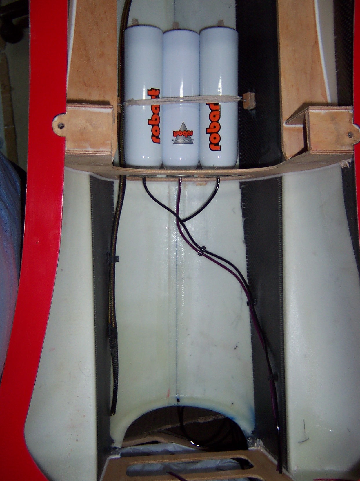

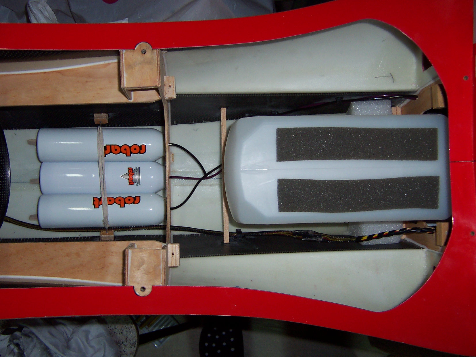

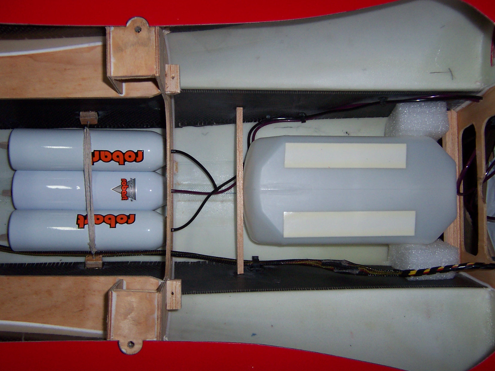

Air tanks positioned.

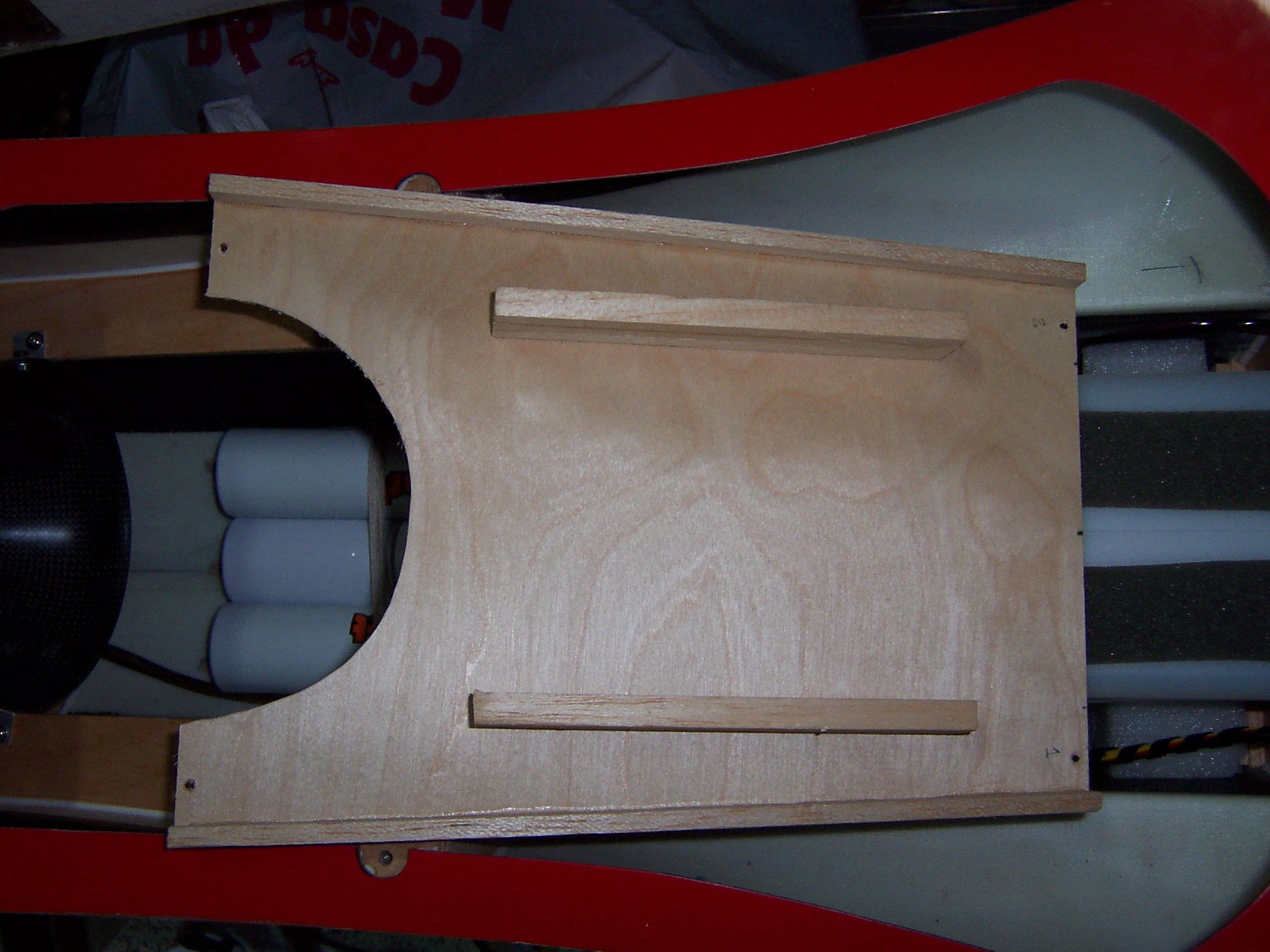

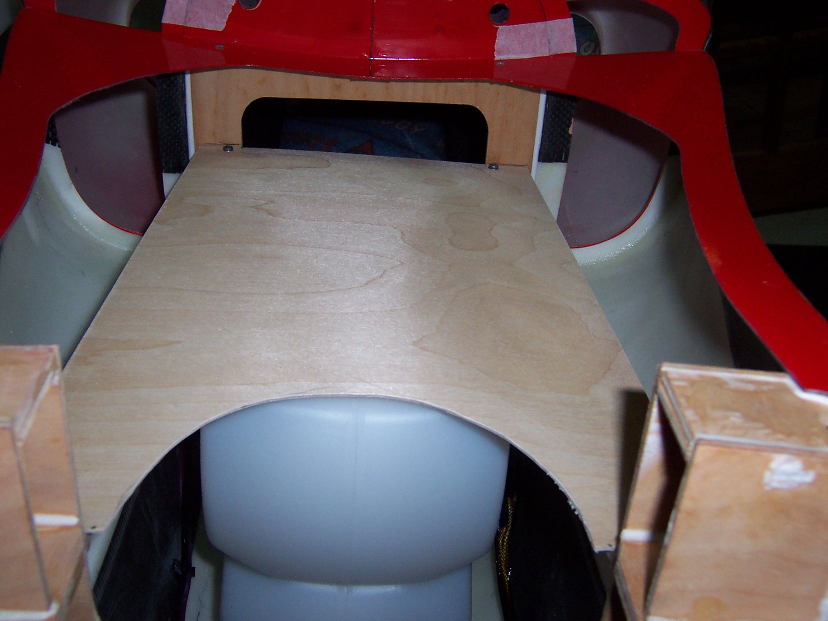

Fuel tanks installation and tray. I used two Dubro fuel tanks, one 60 oz and on 80oz that will give me around 4 liters of fuel.
Old 08-05-2014 | 05:50 AM
  #1863
Joined: Nov 2004
Posts: 269
From: Sao Jose dos CamposSP, BRAZIL

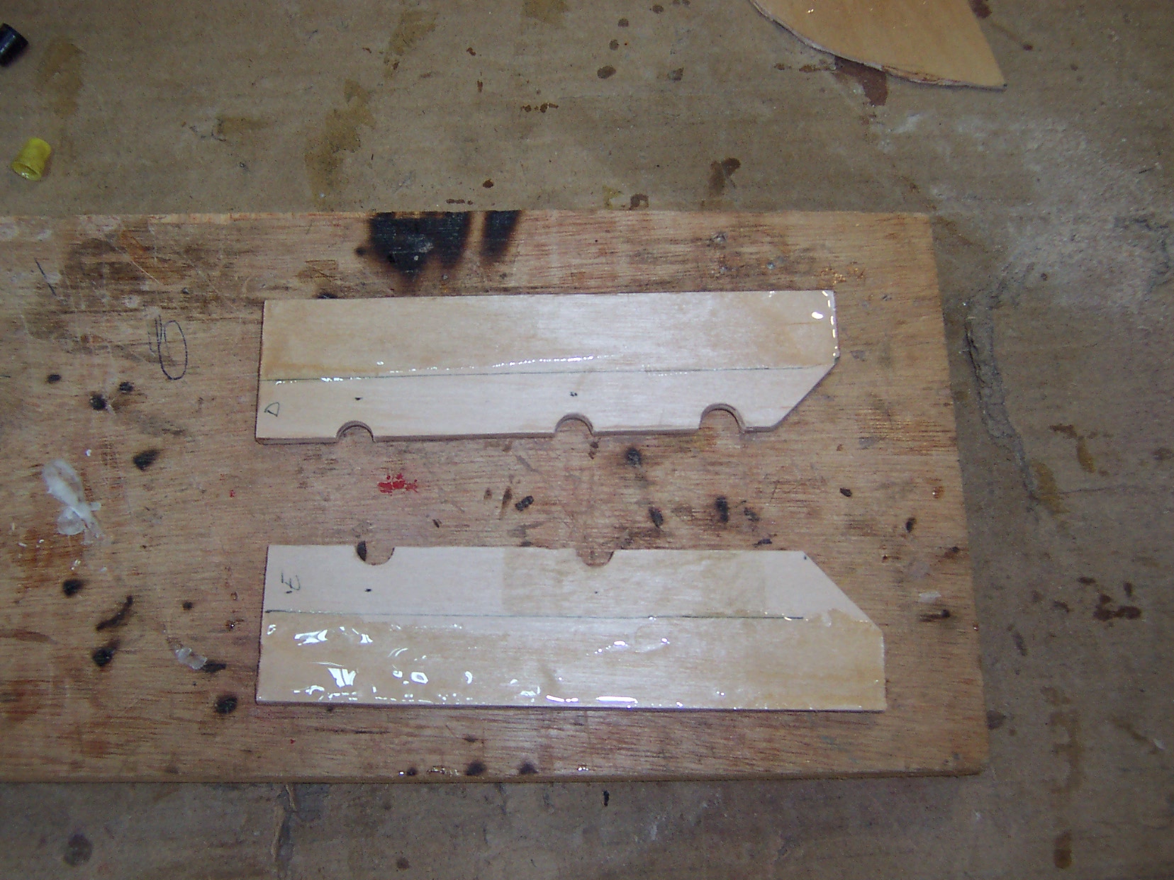

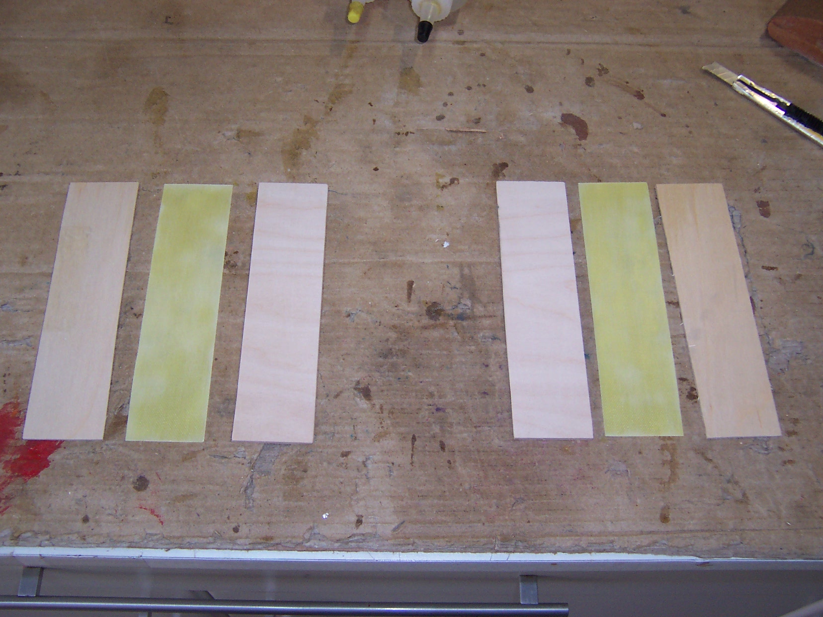

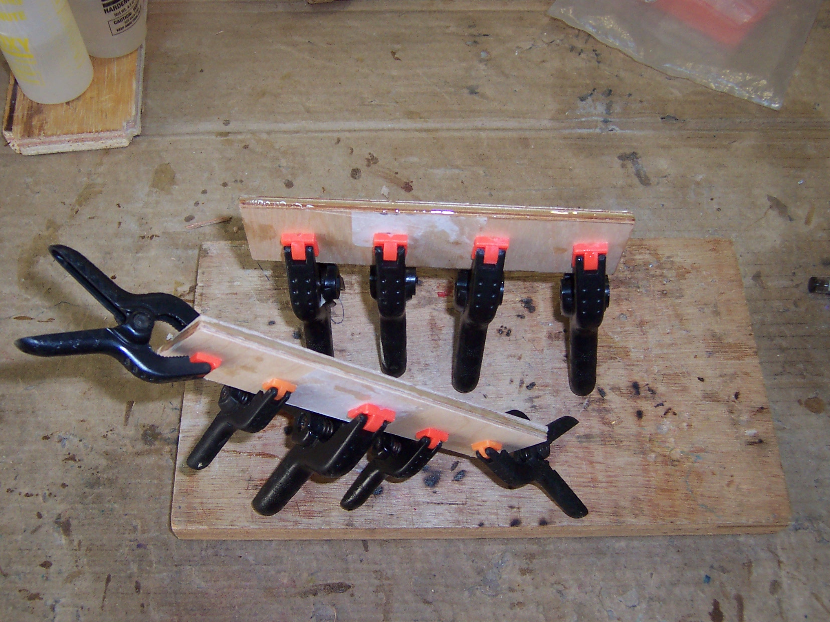

Preparation and gluing.

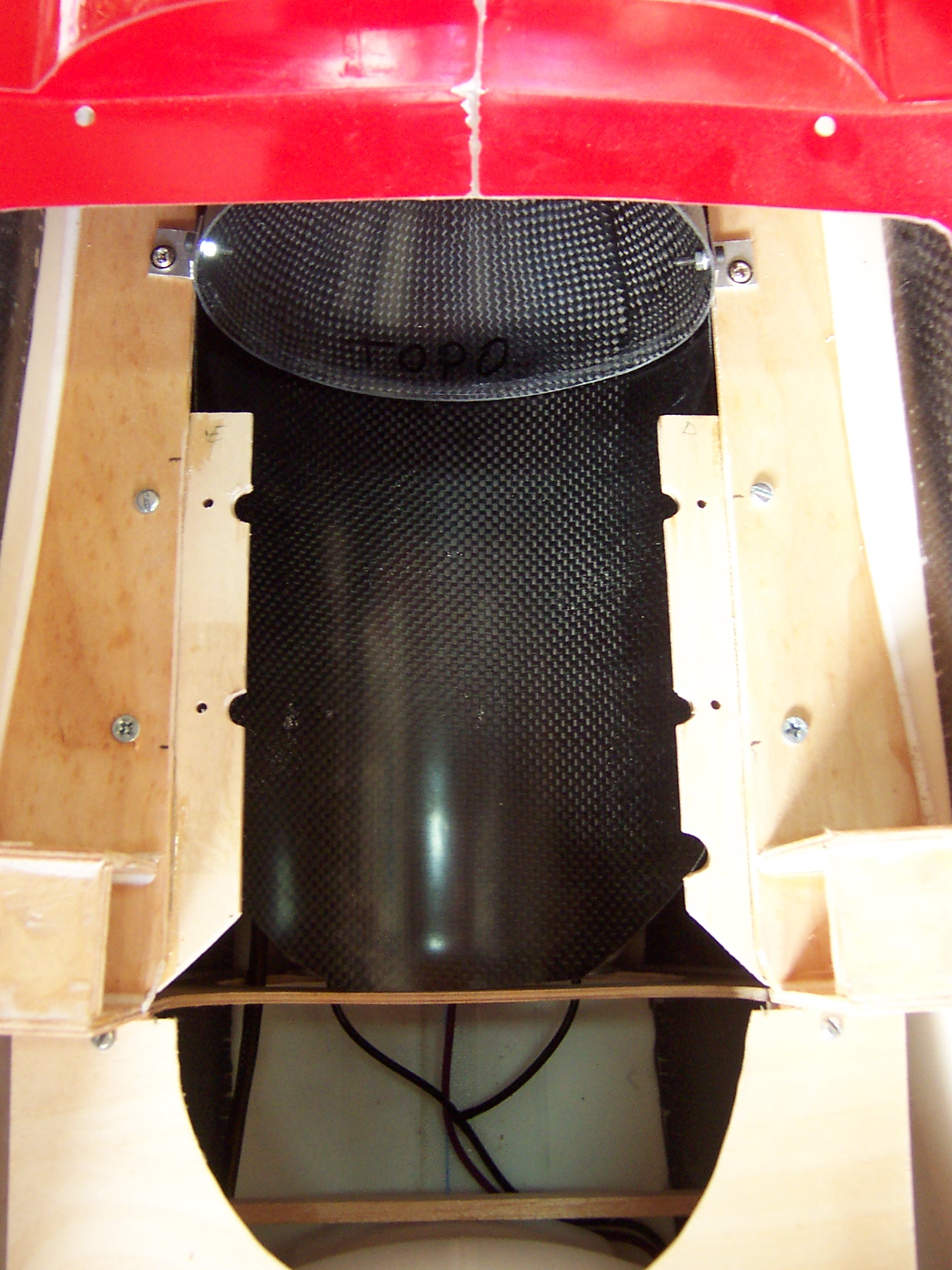

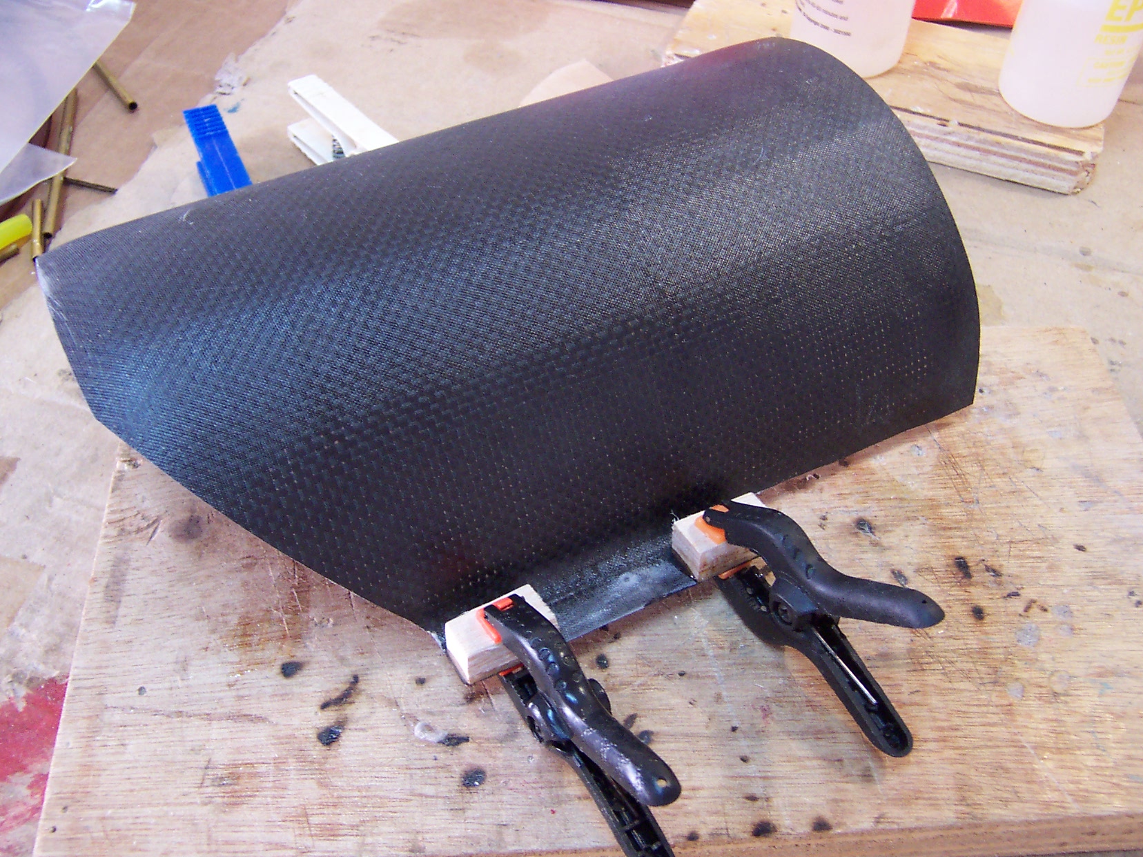

Carbon shroud will be removable for eventual future access to air tanks.

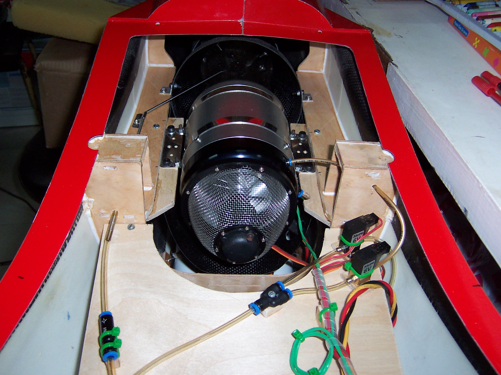

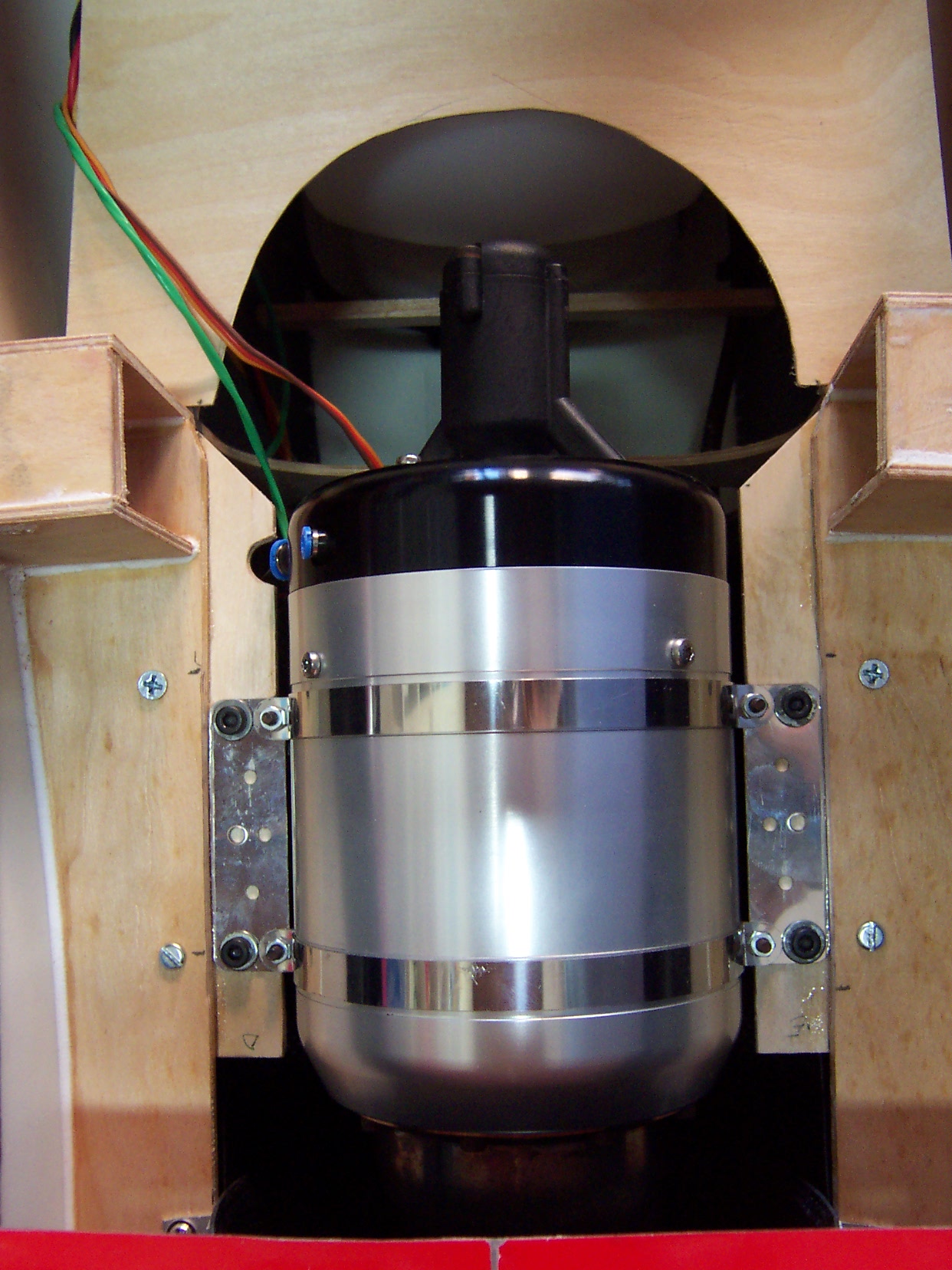

Turbine final installation.
Here is a point to present a question. Merlin 140 has a shorter than usual outlet cone. In order to keep around one inch space between the end of the turbine and the funnel/pipe interface I would need to keep the turbine to much aft.
Therefore, can I leave the turbine no so aft, around two inch distance?

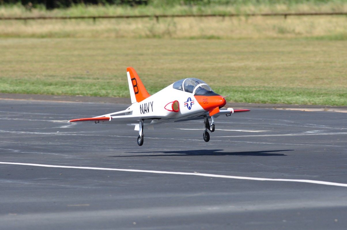

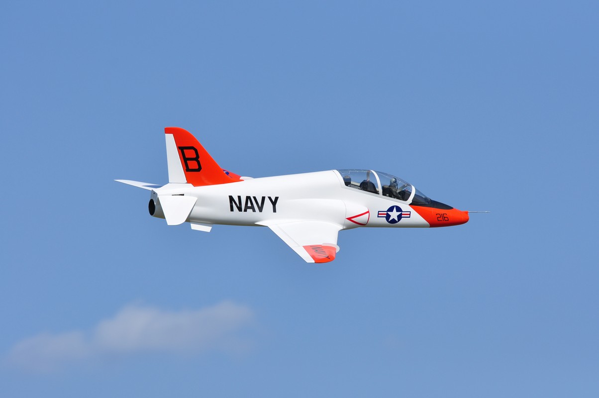

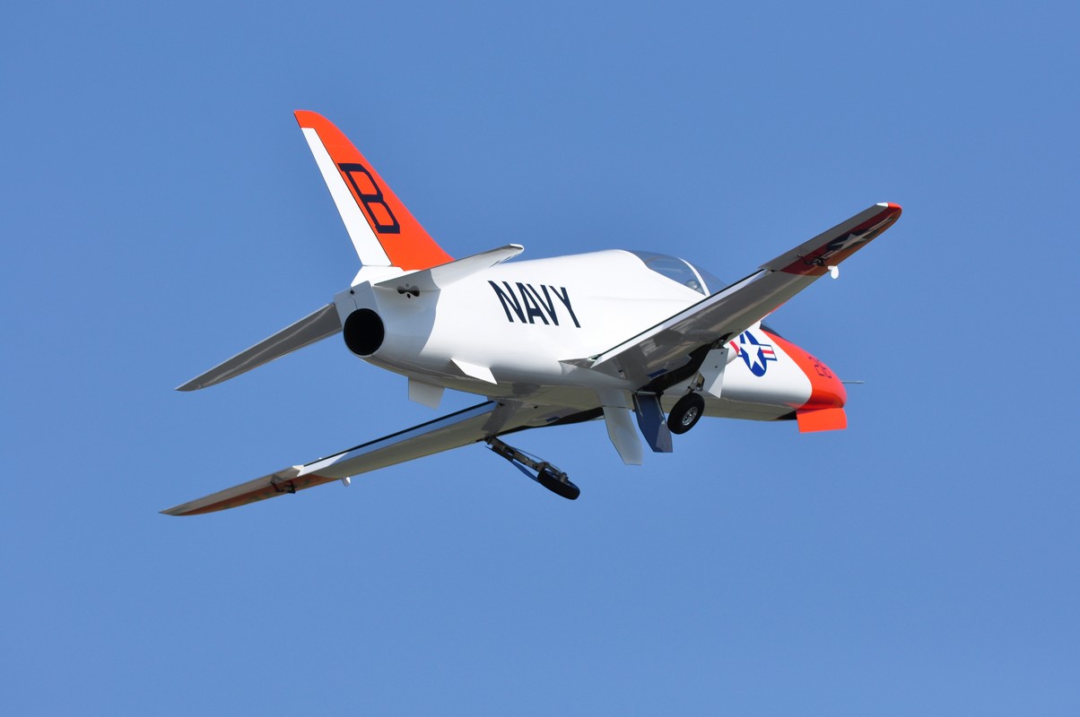

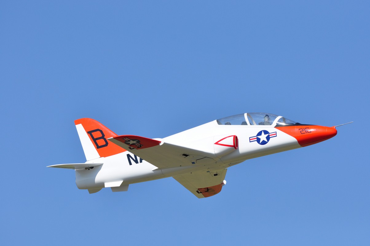

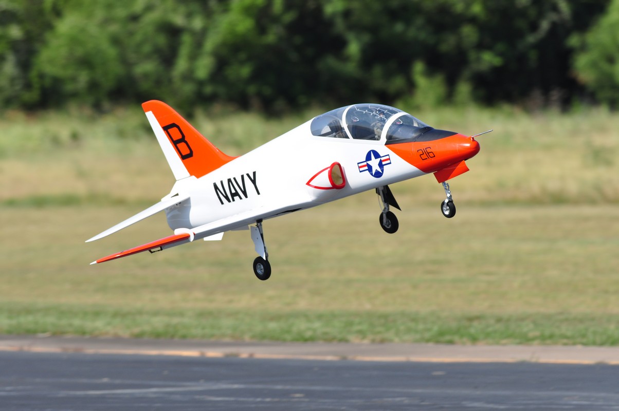

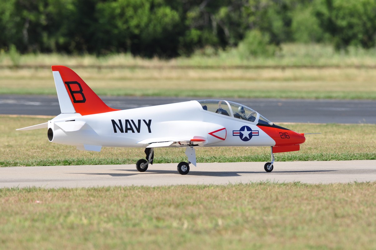

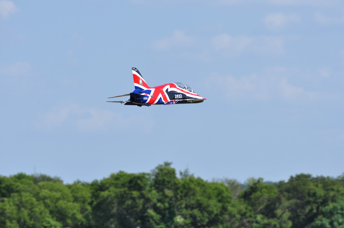

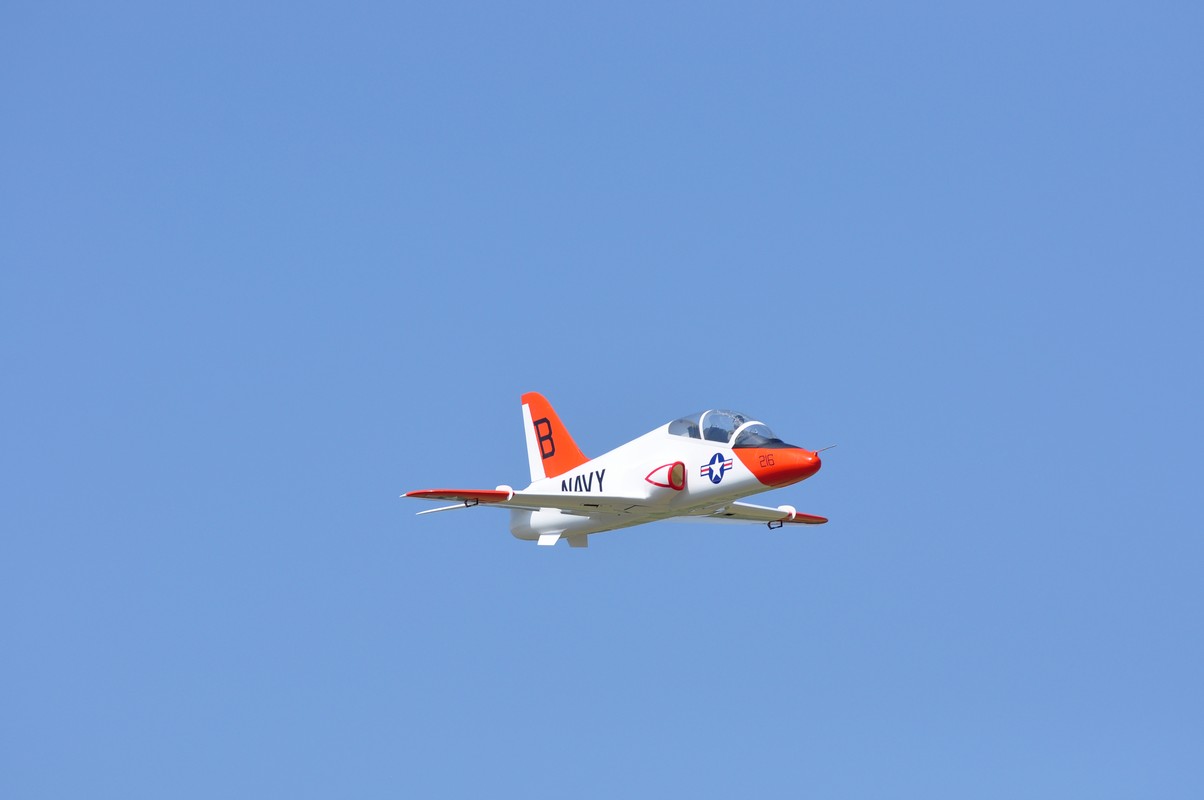

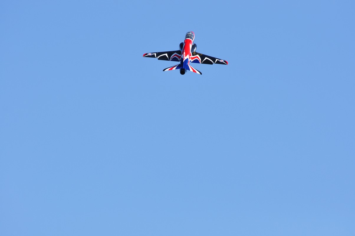

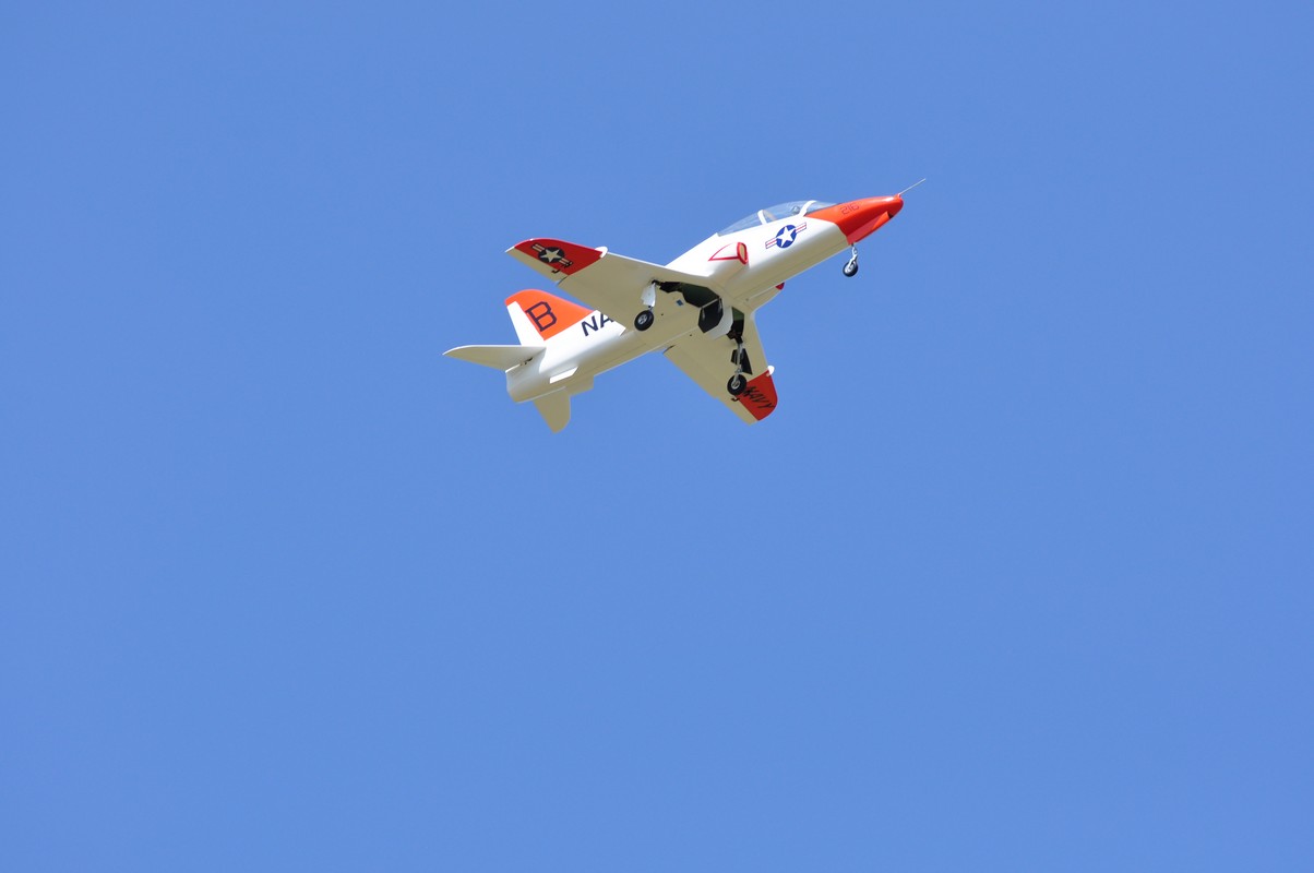

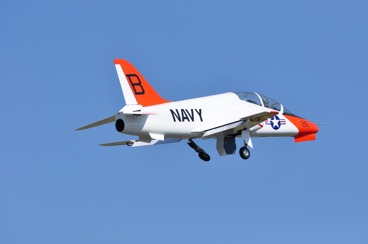

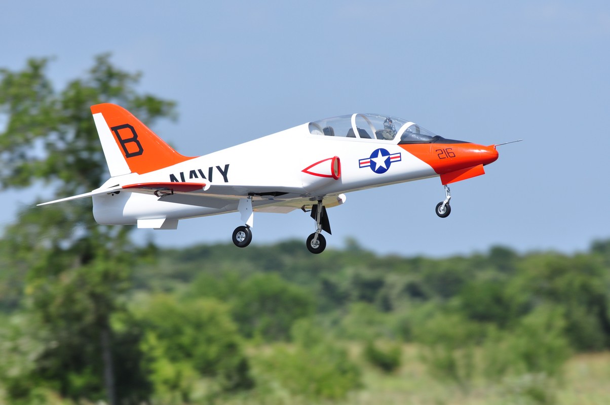

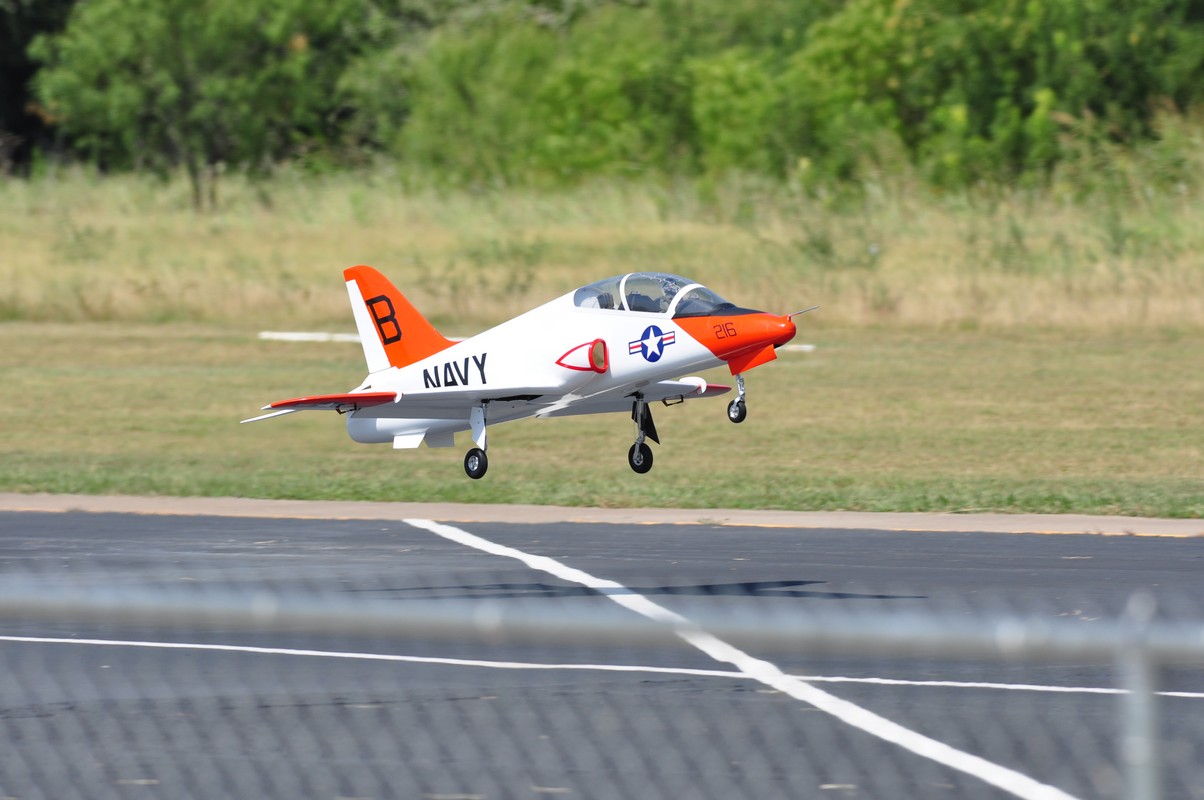

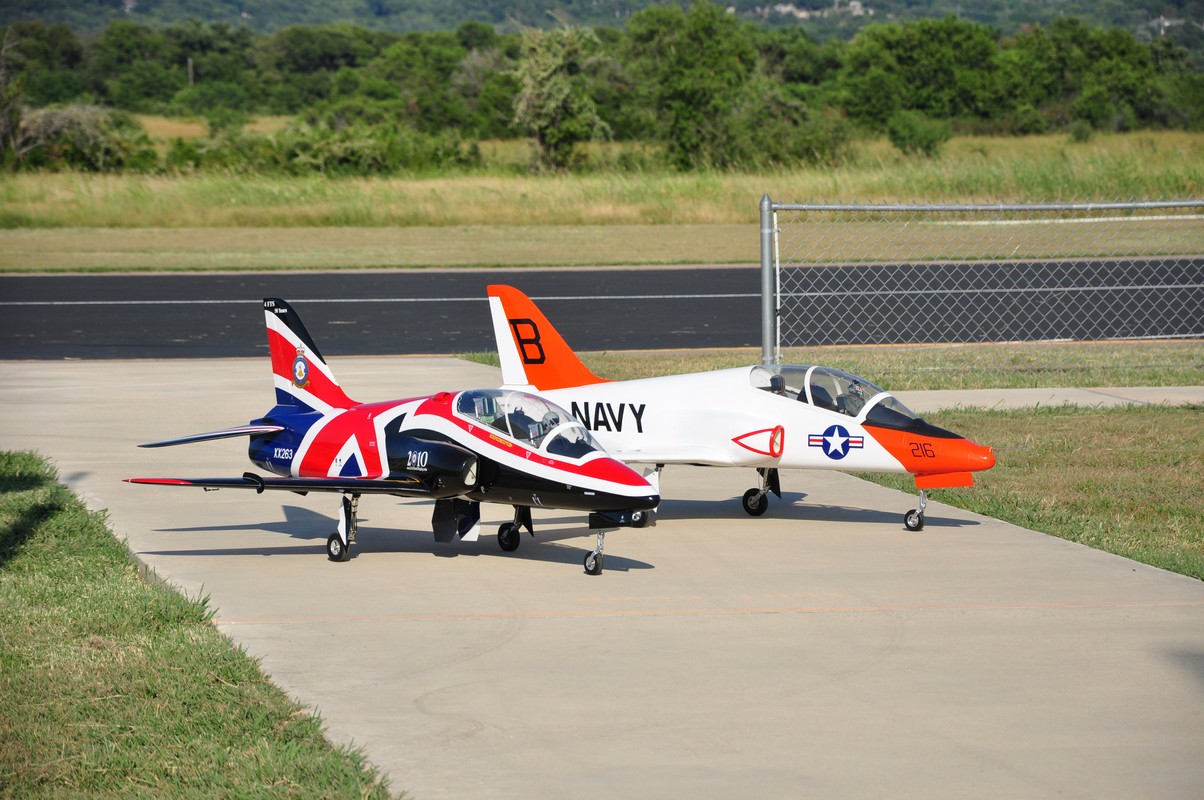

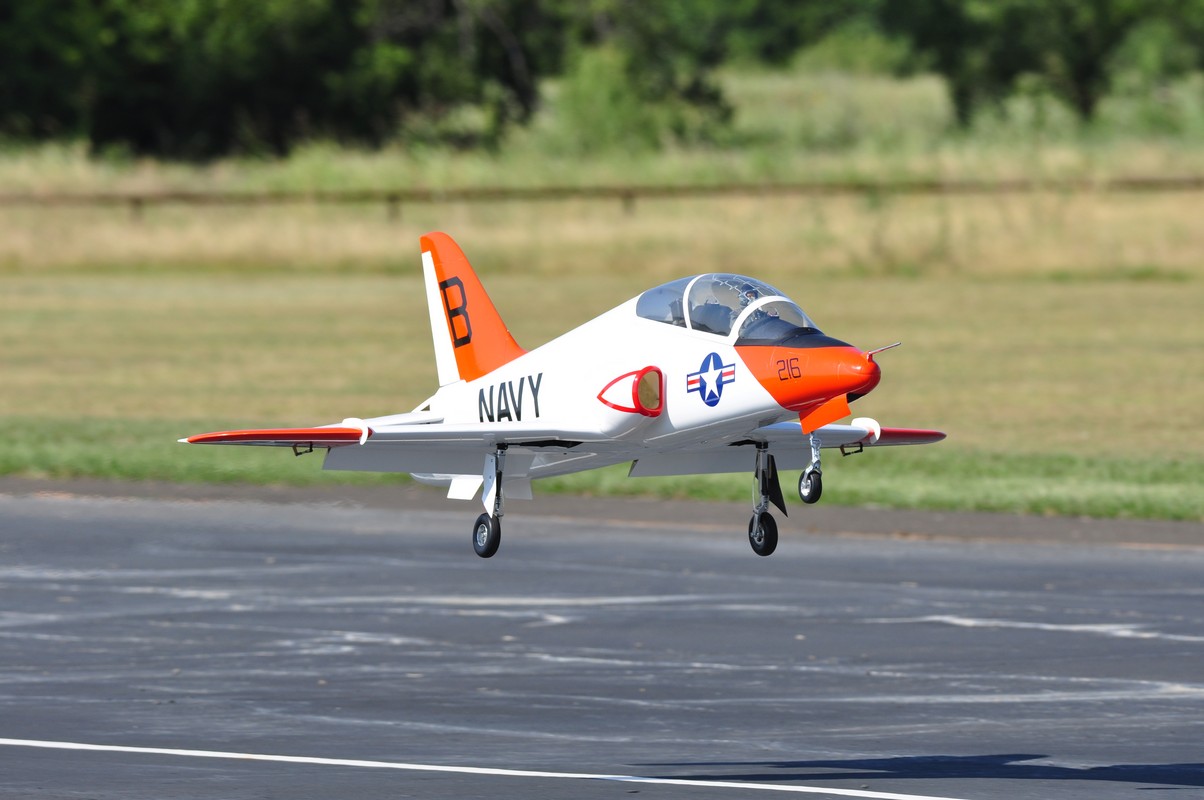

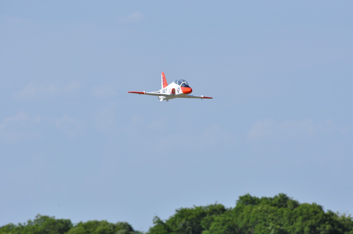

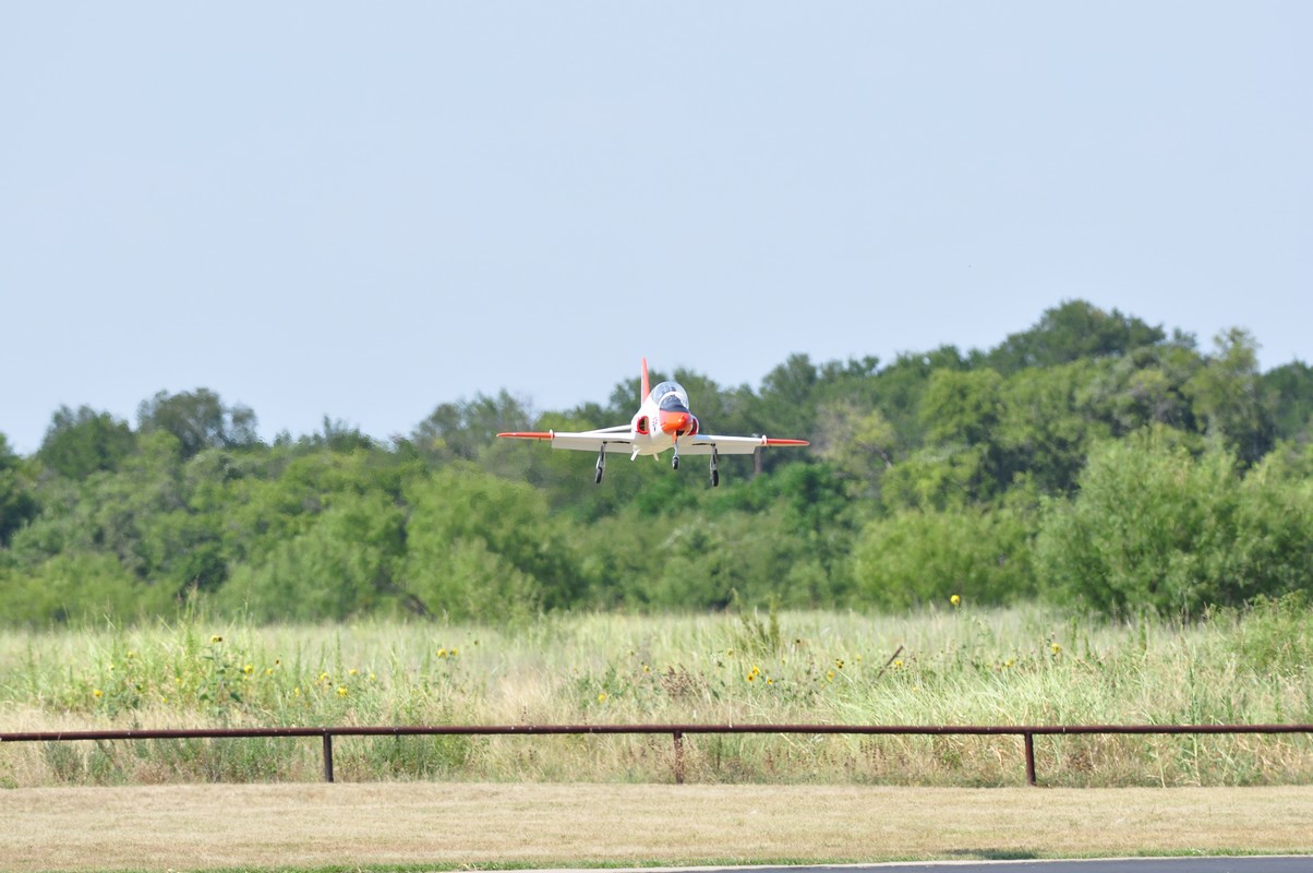

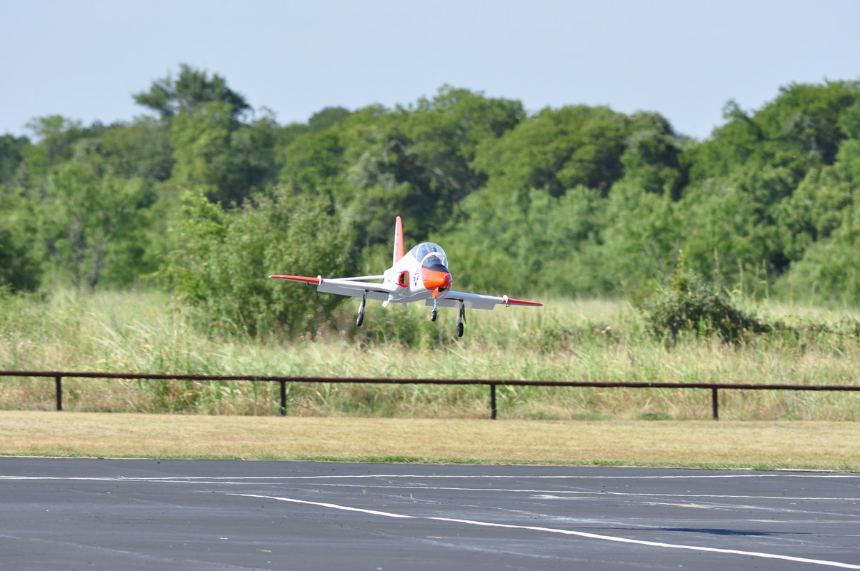

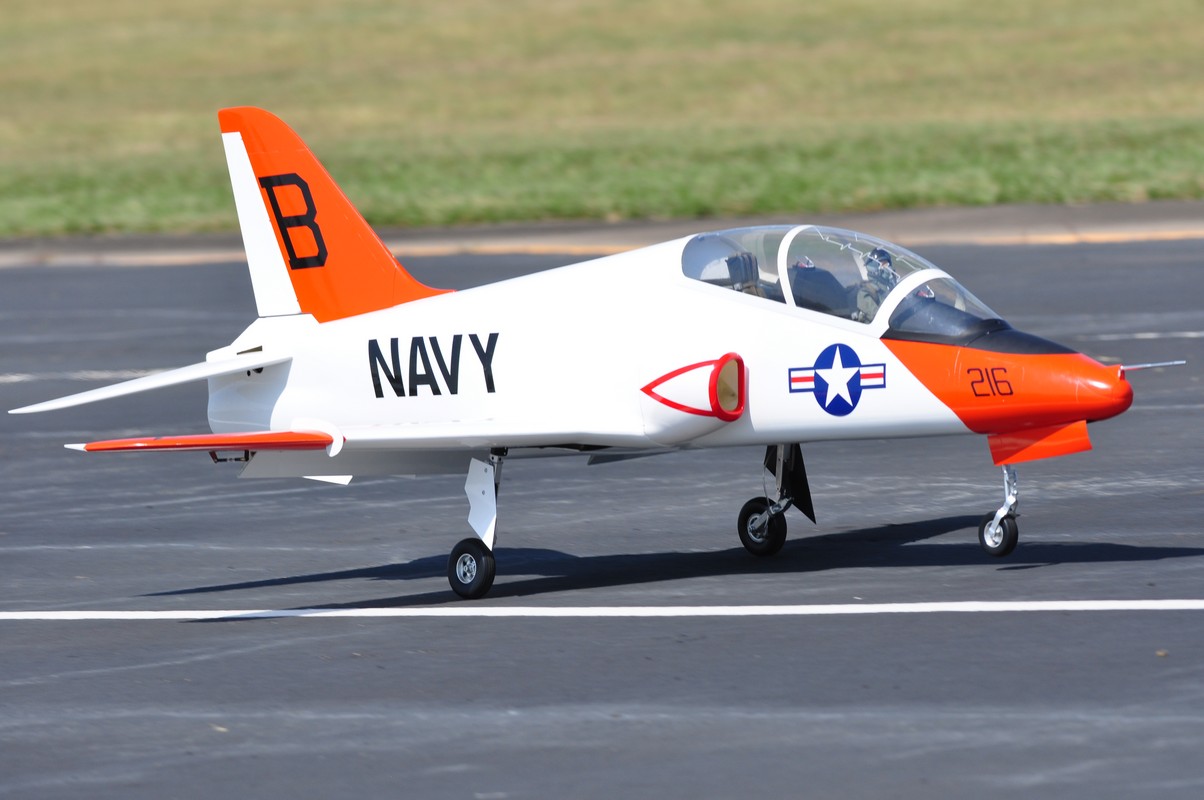

Maiden flight the other day for dieselman's T45 scheme Hawk - and around flight 80 or so for my 2010 DS. Gotta love the way a hawk flys!

Old 08-13-2014 | 12:33 AM
  #1874
Joined: Jun 2002
Posts: 13,266
Received 793 Likes on 576 Posts
From: Watford, UNITED KINGDOM
Both look great, nice weather too :-)
Old 08-13-2014 | 01:19 AM
  #1875
smitty1001's Avatar
My Feedback: (29)
Joined: Jun 2002
Posts: 1,962
From: River Oaks, TX
Thanks for all your help Dave! It was over 100F in the shade, but yeah, nice wx for Texas in August!
