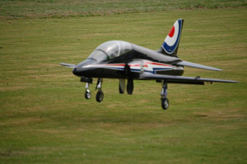

It is also possibe to put both ailerons "up" a little to simulate washout
I hope C-ARF has the wing right. I have a video of one flying at Florida Jets 09... it appears in that video to be flawless

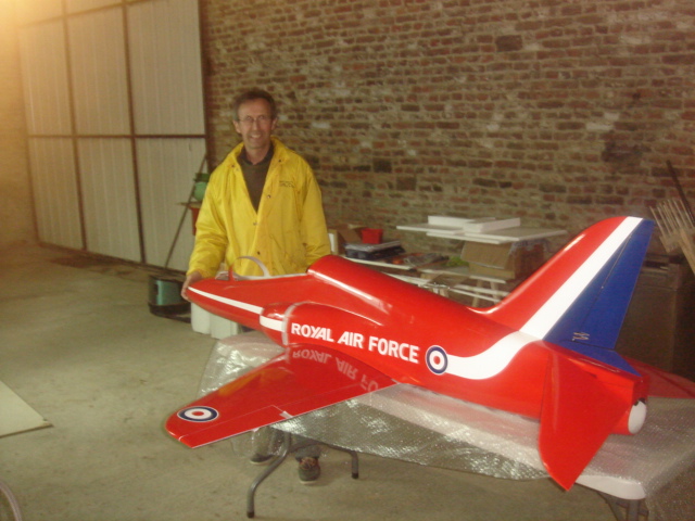

Just got my Red Arrow today, and I am very happy about the constantly superb quality
JPZ

Some pics
JPZ

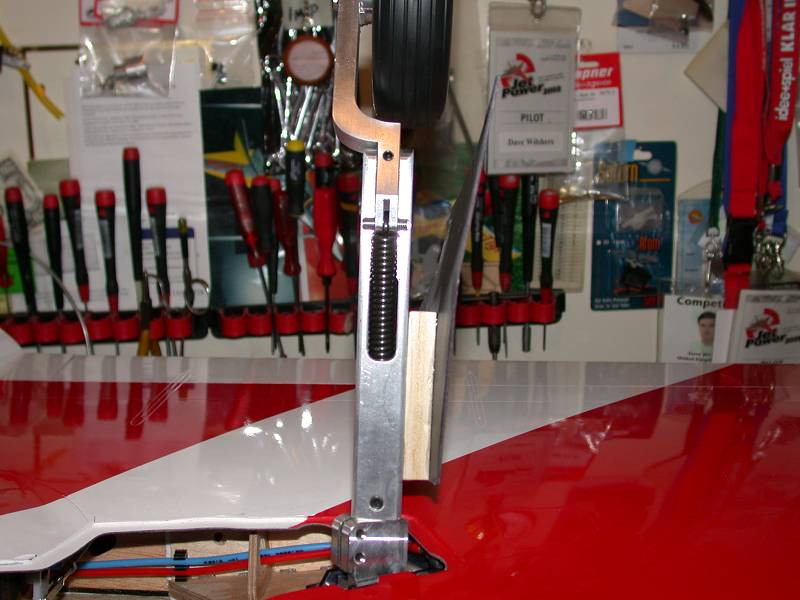

Few more shots of various bits. These are the sports scale gear.
Dave W

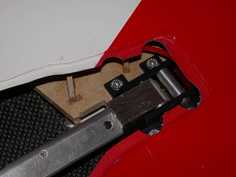

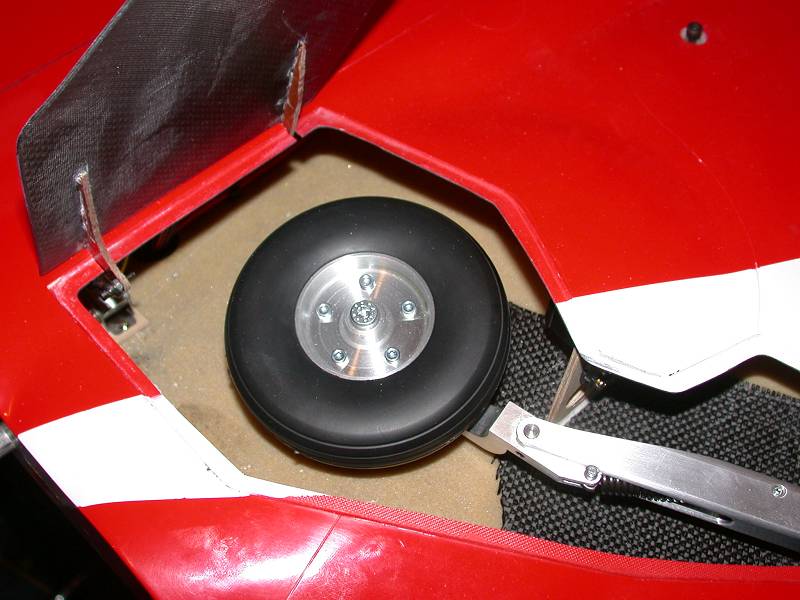

What is the pin diameter that holds the struts to the LG main?
Old 04-29-2009 | 01:55 PM
  #64
Joined: Jun 2002
Posts: 13,264
Received 791 Likes on 574 Posts
From: Watford, UNITED KINGDOM
Default RE: Comp ARF BAE Hawk build thread
10mm (3/8")
Dave
Old 04-29-2009 | 02:53 PM
  #65
geh3's Avatar
My Feedback: (84)
Joined: Oct 2003
Posts: 1,374
From: wilmington, DE
Excellent, some robustness there, my FLASH has some pin breakage with the supplied 5 mm ones, I changed them to 6mm

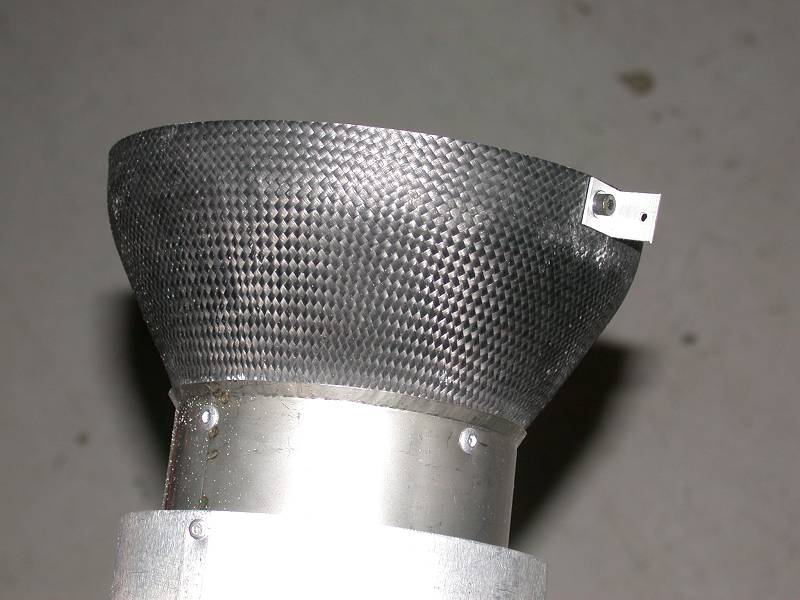

Dave, from the above pics, it appears that the thrust tube is held in by the carbon fiber bell at the front, and the fuse opening at the back, correct?
Old 04-30-2009 | 12:20 PM
  #67
Joined: Jun 2002
Posts: 13,264
Yes, small L brackets off the bell mount, hole at the fuselage rear holding outer tube
regards

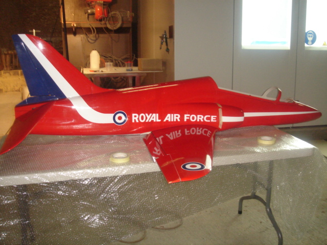

Hawk pixs inc my nearly finished Red Arrows

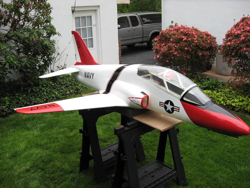

geh3's Avatar
My Feedback: (84)
Joined: Oct 2003
Posts: 1,374

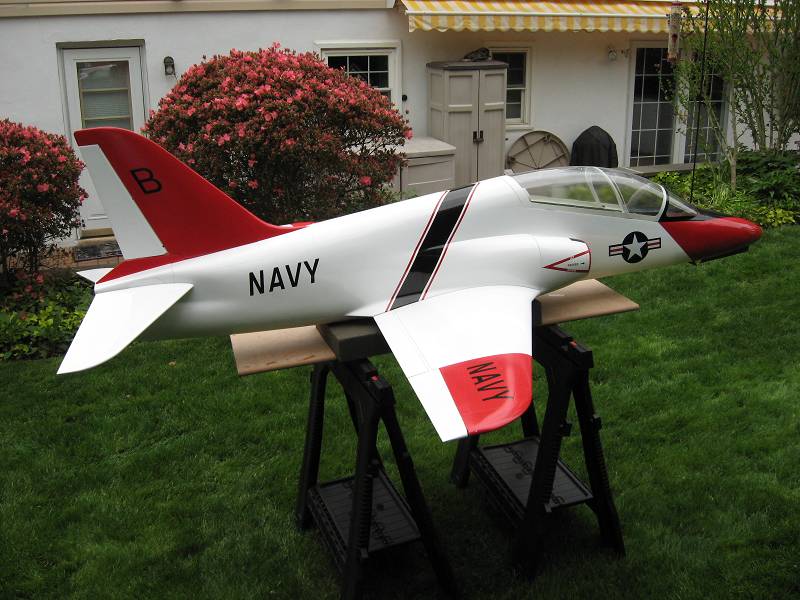

I found an additional NAVY hi-viz scheme for the T-45 version so I added it to mine + an MDC in the canopy
I am finished with the decorations, flying soon I hope!

Tam, I recieved your very well made thrust tube assy
it is a nice weight saving over the original and quite easy to install, THANKS
