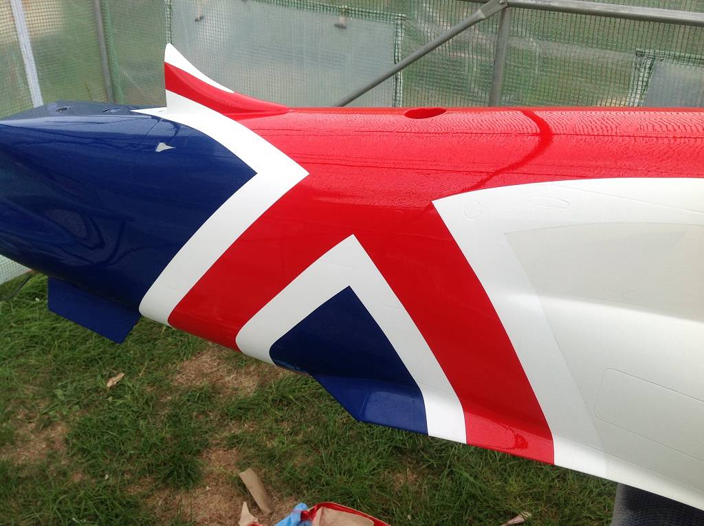

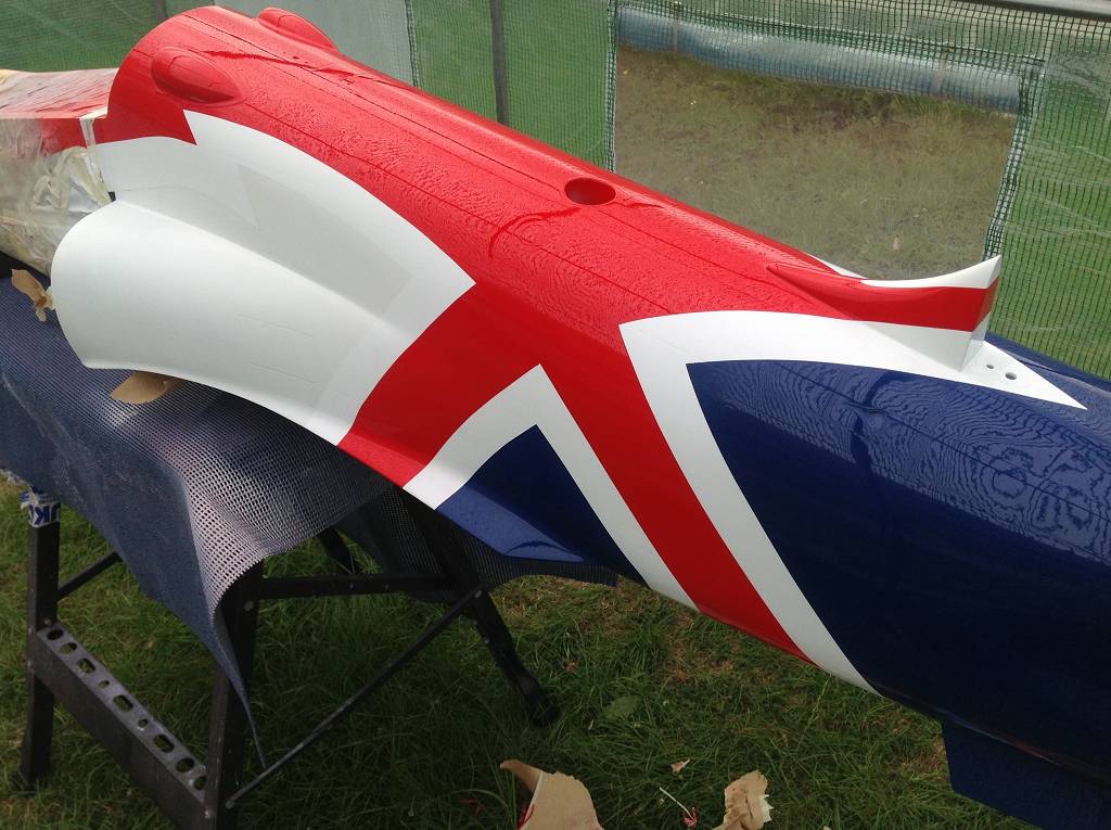

Finally got the red done today, nice and warm plus a bit of help from the infra red! Took over five hrs to mask and took quite a while getting all the 3mm fine lining tape off before the 2k went off, just got the black to go plus the air intakes...starting to look familiar again :-)
Alan
Just noticed that the 2k seems to be having an effect on the grass! Think I will be needing some grass seed soon....

Looking sharp Alan.
Marty

Thanks Marty, looking forward to putting the decals on! Someone on here was asking if anyone knew where they all go? Well I will have the same issue when the fuselage is all done. I mainly use the valley aviation web page that shows you the full size 2010 Display Hawk as there are many close up pics when the lads finished the paintwork but if anyone has got info on all the locations etc i/we would appreciate them!
Also some of the pics the red looks like there are bubbles along the edge? That's the reduction of resolution that RCU does when you upload etc my original pics are just fine.
Alan

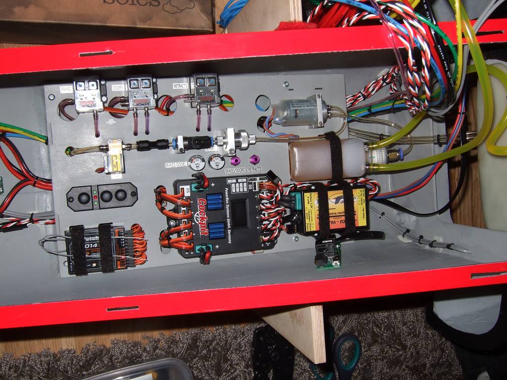

I could also use some advice for the gear sequencing. I am using an Airpower EVSD-5U-EVO multi function valve. Powered by 2 large Robart air tanks, one for gear/doors, another for brakes. I have to make a few selections:
1. Delay time for sequencing, default is 3.0 seconds
2. Normal braking or pulse (a form of anti-skid) braking.
3. Fail safe pressure, the pressure that the gear will drop in the event of a pressure loss. Default is 50 psi. But if the doors have to sequence open first maybe a higher pressure would be desirable.
I realize these questions may be best posted in their own thread but just in case any of you Hawk pilots have been through this, thank you for your help!

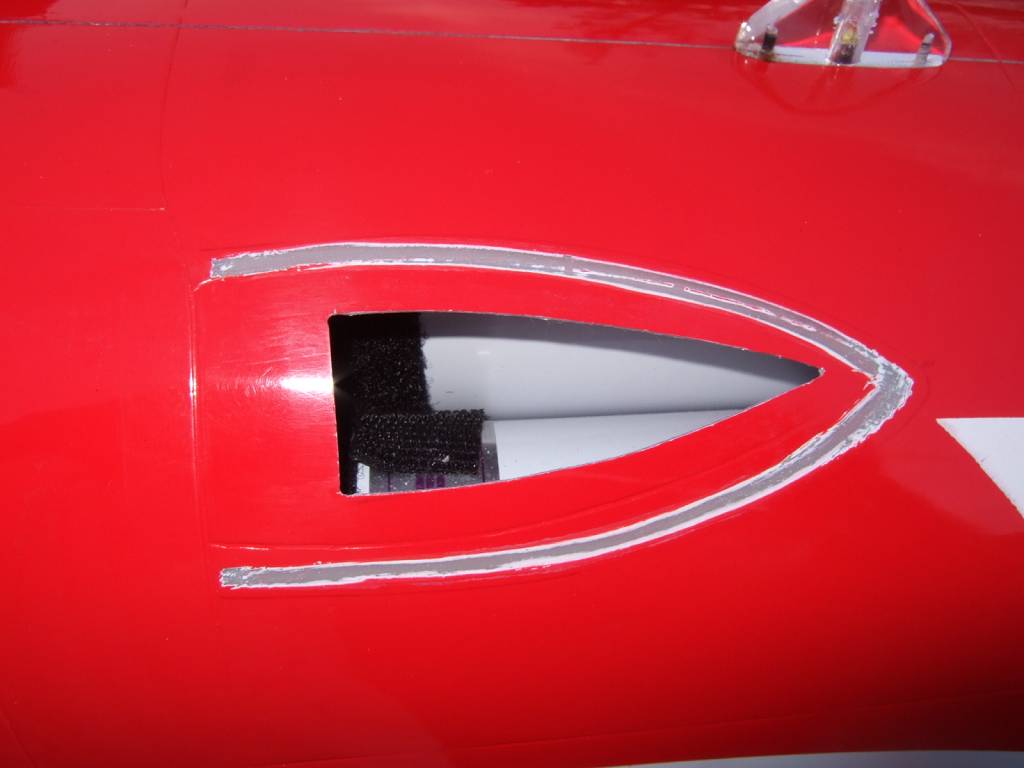

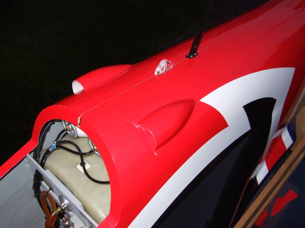

Finally, is there any consensus on mounting those Hawk "rabbit ear" scoops? Should we cut holes in the fuse to allow air in from the scoops? Or should we leave the fuse intact and if so, block off the front of the scoops with some black ply or just leave them open and hope the airflow doesn't rip them off? Thanks!

When I originally glued the scoops on I took the paint off so it was glass to glass and yes I cut a triangular hole to let air in...
I used a Cockpit Power box and the doors/wheels are controlled through that, I use 120psi and have had no trouble with getting the wheels away..
I have all the settings wrote down ie the times but will have to get them tomorrow as late now..

You will be surprised even with 120psi the gear does not bang up quickly I would allow plenty of time for now until you try it in the air those doors create quite a drag when retracting and you don't want the doors closing early!
I have 3 BVM tanks in the top two are coupled with the third for the brakes and doors.
Alan

im using jettronics valves and sequencer in mine and there is an audible sound x3 when the gear come down on mine at 100psi 120 seems alot to me...2 large robarts supply the air...i didnt build mine but the batts are up front beside the nose gear mount and turbine pack is about 6" rear of them , it has a tams pipe and a titan se in it no lead needed

I have the air pressure at 120 as this is working good at getting the legs retracted but I use a restrictor for when the legs come down
Alan
