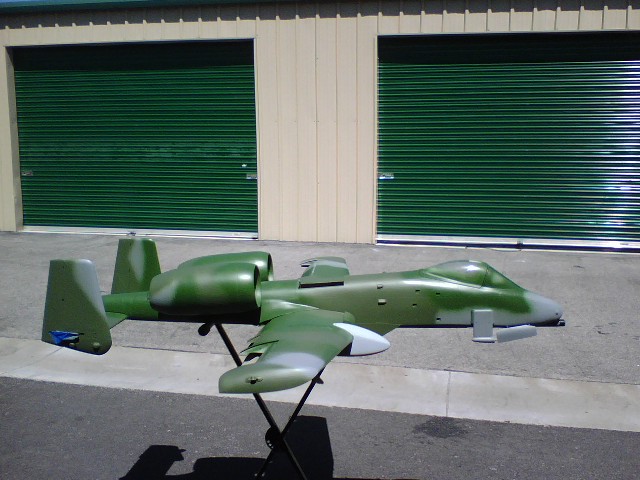

The link on the first page has a bit about balance.
The prototype apparently had about 6lbs of batteries under the canopy area. Roughly looking at it, I would say the engines may be a foot behind the c.g. with a couple of feet available in front of the c.g. Therefore, for each 1lb added in total motor/fan weight you would need another 1/2lb or so in the nose to balance. I am guessing that you could get it to balance with the heavier motors but I would personally go for the lighter option. I understand that the latest lay-ups that Chris is doing are lighter but the prototype was 24lbs which is reasonably fat for its size.
Model A-10s are generally notorious for balance as they don't have a huge cannon in the nose to help out. I am going to try to save every ounce at the back end to make it as light as possible. I was even considering removing the starters from the Wren 44s to help out but will probably sacrifice this for ease of operation. I have the added 'problem' that I won't have 6lbs of batteries on board to balance it all out.

Thanks Chris for getting to this. I think that light is better... The new one we have now is going to be set up with a single turbine. We are still doing a lot of testing on this one guys just to come up with more options and better performance. It does fly great at half throttle with 9's or 10's at 24 lbs. I really think the lighter ones will be even better.
Will keep you all informed as we progress.
Thanks again,
Lowell

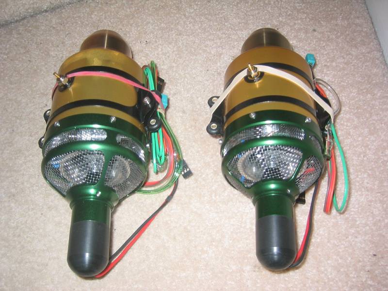

Well, it's all about options, isn't it? I think the single turbine option is definitely worth looking into. It's been my experience that a well trimmed, well-designed model will fly great even when a little heavy. The A-10 is one of those models with the right wing planform for good performance at a fat weight. I remember the first time I weighed my first Combat Models A-10 (which has a relatively scale airframe and airfoil)). Nearly 12 pounds with a Y.S. .45 on the tail! Flew awesome, of course.
I'm definitely going to do one of these. I'm not sure if I'm going electric or turbine. I'm not interested in the Tam fans, so if it's electric, I'm going to try out the DynEmax. My suspicion is that it'll fly fantastically and sound AWESOME. Sure, it'll be heavier than others, but I bet you won't be able to tell that by watching it fly!
If I go turbine, it won't be two! I think these engines are close enough together for the offset thrust to be quite manageable. I'm sure there's an optimum thrust angle for the engine. Someone somewhere would probably know a formula....

Sean, John is putting a single P-60 in the one we just finished. It should be ready to fly next weekend or so....Look forward to having you out for the maiden. I think your right about the weight. The first one @ 24lbs. we thought was a lot. It flies great at 1/2 throttle and not a single bad characteristic. The new one is about 3 lbs. lighter. I'll call you when it's ready to go.
Sic, those engines LOOK sic!!! They are screeming for the A-10 and I can't wait for the feedback from you. That is what it needs!! We are working on yours now. I will let you know when we can ship.
Thanks guys for all the input...this is really a great project.
Lowell

You bet I won't miss that! I talked at length with him about the single engine thing. I hope it works! Well, I'm sure it will WORK, but I mean I hope it flies nicely. I don't doubt for a moment that it will fly authoritatively enough for people to be satisfied with the power, but I'm hoping the offset thrust will not be an issue. Please let me know when you're going out.

The website page for the engines is here: http://wrenturbines.co.uk/engines/turbojet/mw44gold
The engines are 600g (21oz) each and put out over 10lbs thrust; I think this compares very favourably with an EDF setup. The only thing I am wondering is how easy it will be to get the fuel tanks near the c.g. At least with these engines I will only need to find room for 2 litres of fuel (1 litre (32oz) per engine).

Hey Sic
Wow! I didnt realize how compact those were. You will be saving almost a pound and a half in the engine section, over the Turbax set up in the test plane. I also weighed the latest engine nacelle pulled from the mold, and it is the lightest yet at 1.1 pounds. 4 pounds of fuel. Should not need to much counter weight as long as its fully noseward. This is getting exciting! Seems to me that the whole setup will come in lighter than the turbax. Not to mention the airframe will be about 2 pounds lighter. I am going to guess and say 20 pounds wet.
I will be bringing a few kits to John and lowell in about a week so hopefully they can get one out to you pretty quick. Cant wait to see it fly turbine!
